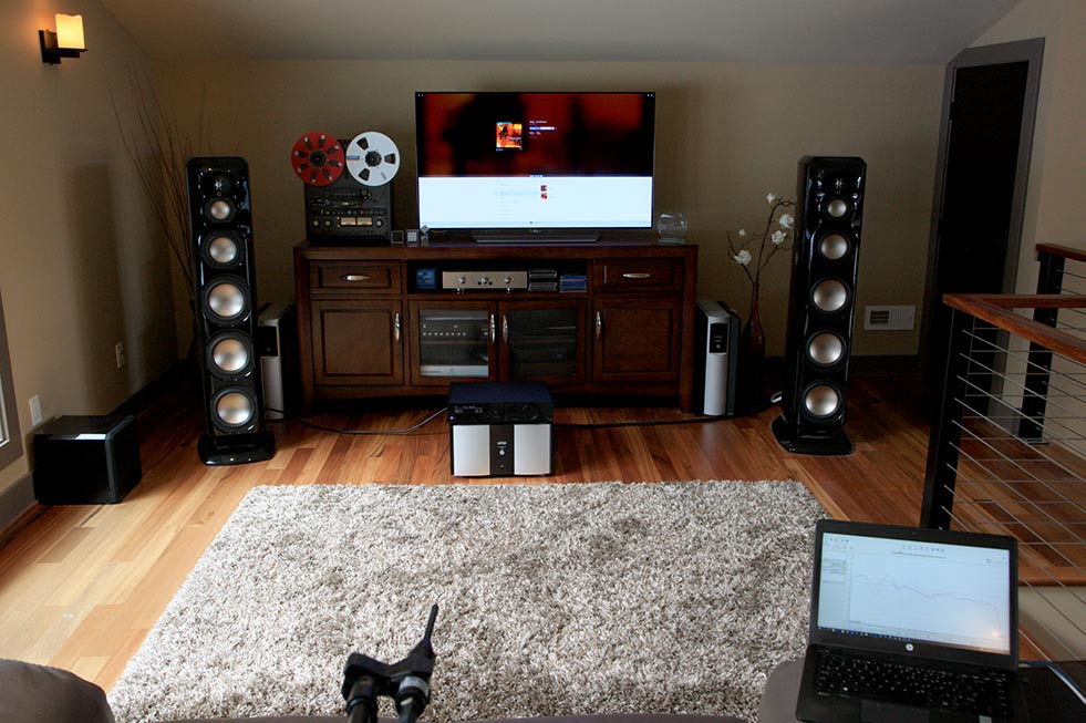

Here's a pictureI have a feeling amir has a monstrous listening room and no neighbours so can play at reference levels in his listening tests, hence bottoming out the drivers easily and no boundary gain from the bookshelf speaker. He has Salon 2’s ffs as his standard and those things need a great room..... Just spitballin’ anyway.
