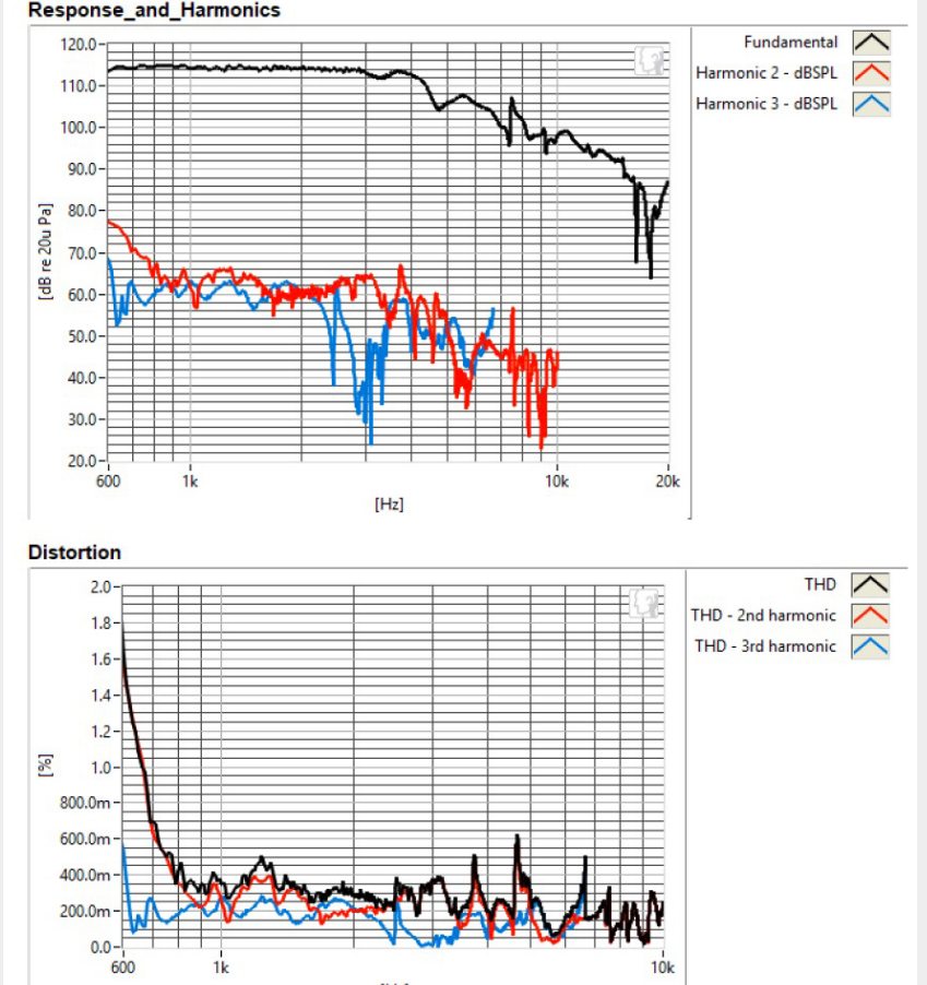

It's only a couple hundred (US) dollars more than using the PTT4 as a midrange.
On the other hand, I checked the distortion plots again and it looks like HD is around 50 dB below fundamental for the Volt, while it's more like 65 for the PTT4. For now, I think I'll wait for a Purifi midrange.
better the VM752 vs ptt4....It's only a couple hundred (US) dollars more than using the PTT4 as a midrange.
btw not bad the 2"
read well .....you miss the point,not a newsWhat am I missing? That plot shows what Paul said, which is the Purifi is about 15dB better
Yes for me with my limited knowledge this is where the trouble starts - my present mid is the Eton 3-400 (I believe discontinued) again I am not convinced I have access to data for that driver that is well enough defined. So for THD I can not compare Purifi to Volt to Eton. Here I am only guessing, but with these values being so small I would have thought differences in test could radically changes these values.
