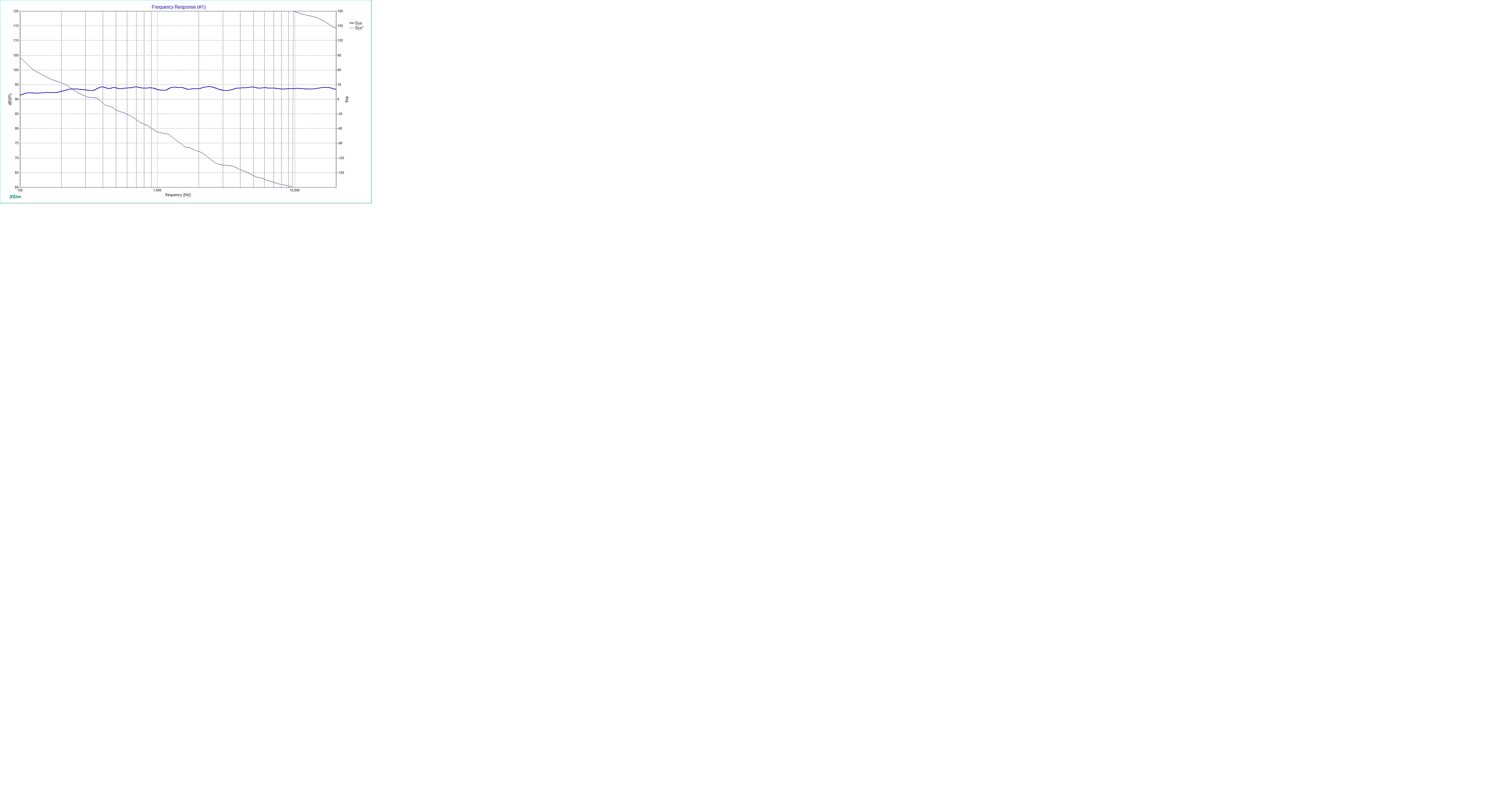

I recently started using VituixCAD to extract the FRD and ZMA data from jpg/png files made from the FR/Imp plots, as posted by the manufacturers (using the Tools/SPL Trace menu item).
Attached are Purifi data, as you requested, for the 8 ohm driver, along with data for the Bliesna T34B tweeter from these jpg/png extracts.
[Unless I missed it, it would be nice to have a central repository, a specific sticky, only containing FRD/ZMA driver data on the forum.]
I also added an XSim file for a crossover between these two drivers if anyone wants to play around with it. (Keep in mind, you'll have to reload the attached FRD/ZMA data files, based on your file/folder set-up.) The T34B can cross over fairly low (~1.5K) before the Purifi starts to get beamy.
The XSim FR plot looks good (shown below), but I don't have all the parts to see how accurate it is.
Nice work Mainframe! Great choice for the midrange. The best! These drivers are all well behaved. I bet a passive is not hard to do. If you care to post the FRD’s and ZMA’s maybe we can all have a good time fiddling with Xsim.
