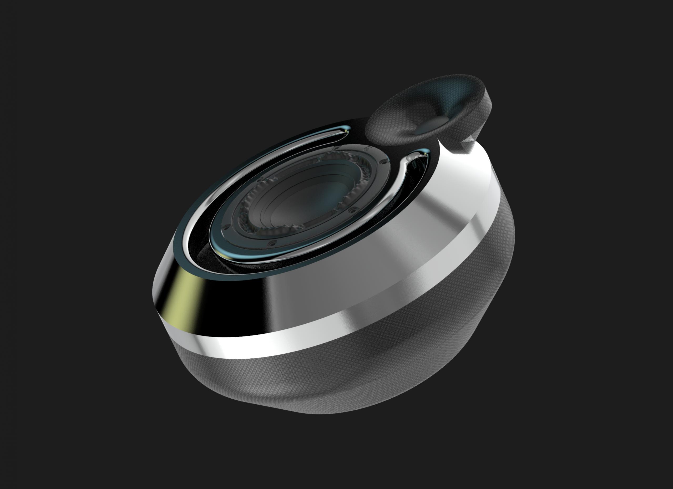

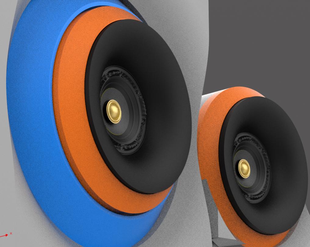

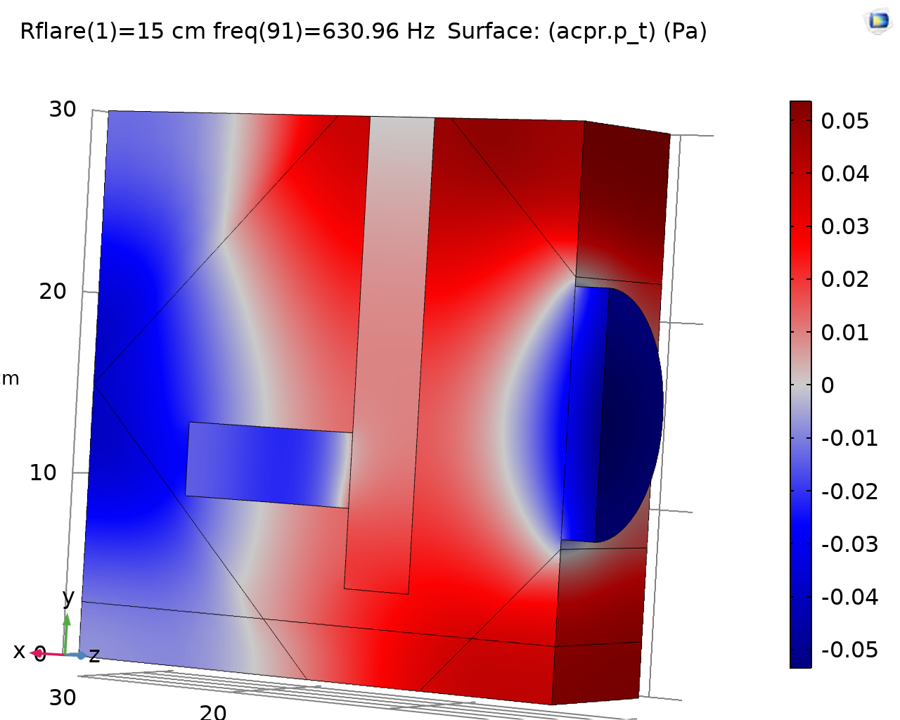

Hi, i like your idea of concentric passive radiator, and i have actually read in latest issue of Audio Xpress about some company already developing it.Now comes that moment of confession that I didn't model the PTT driver lol! You can download it from Purifi, fyi. I'm both happily and painfully aware of this as I'd already spent many an hour modeling that surround and even have it available for download on the software forum. Solidworks and in the case of organic shapes a plugin called Powersurfacing are the modeling tools and I render in Keyshot.
Facing your prognosis of a concentric PR build, I'll have to weigh some options about how to proceed. One thing I really liked is the ability to stay very compact without a rear firing PR, and hence no wall proximity issues. Also, having learned of your out of phase/distance trouble, it seemed reasonable that direct alignment would be the most uniform position as far as how direct the suspension is loaded.
The Magico A1 is a reference for where I want to get in terms of build execution, so I have done a fair amount of modeling and comparing of that piece.
As to the patent.... nah, It's now safely in the world of prior art for us open sourcers 😉 If only it would do what's intended of it, but that's a whole different deal. It may be the perfect frisbee?
EDIT: I also added the original version with flat PR cone and upward facing surround for a sense of the many ways this can be configured.
The issue with your renderings seems to be, that the surface of the passive would be too small, given the size of the Purifi driver. The rule is to have the passive 2x, in some cases 3x the surface (sd) of the active driver.
Have a look on pics of the AudioXpress article, and you will see where i am aiming with this 😀

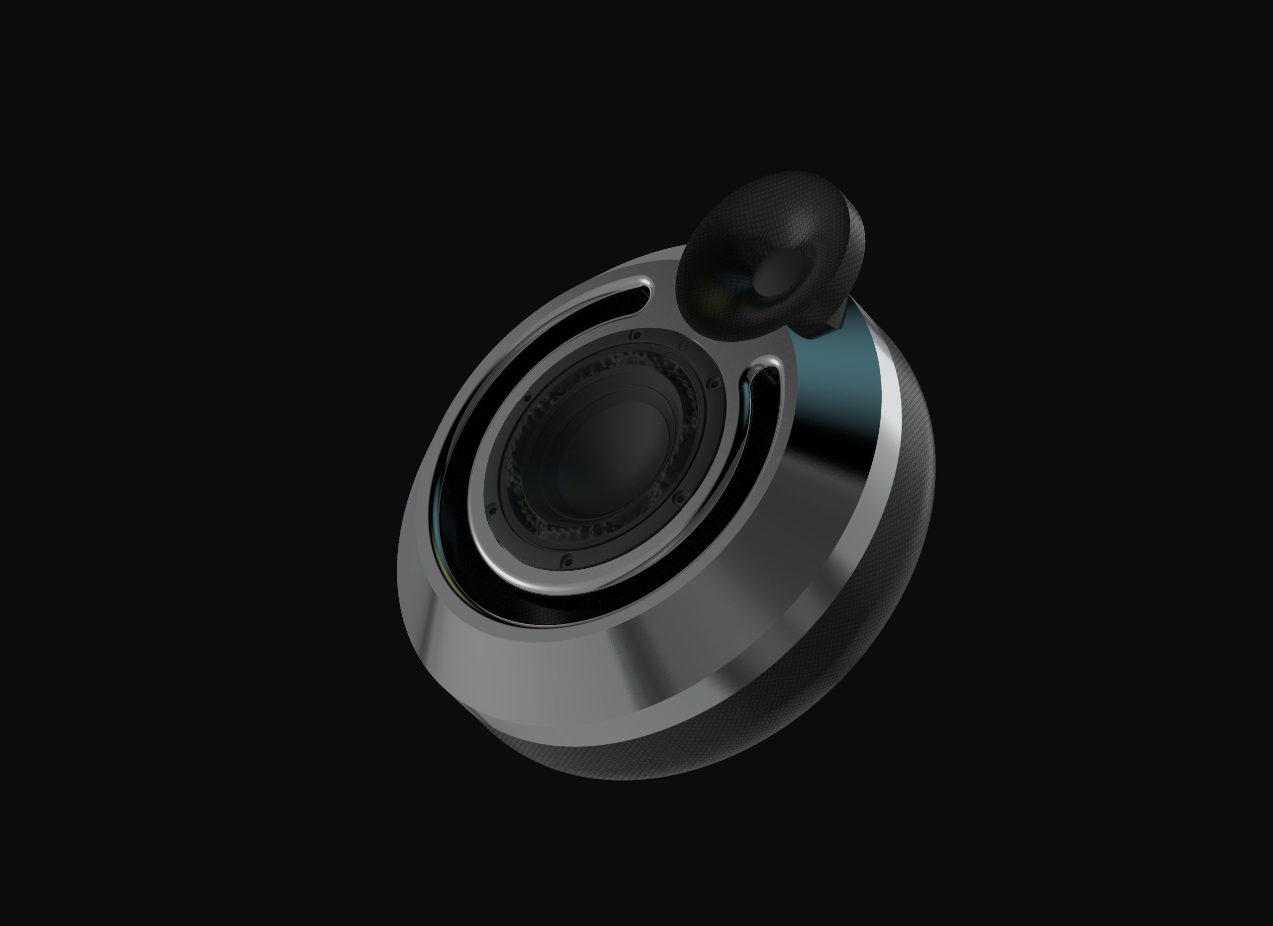

To my mind the PR ring should be considered a coaxial speaker, unless there is some invisible secret sauce, BUT, my concept is validated I suppose. However, we still haven't any performance metric beyond whether it will make a usable frisbee!
To your point about 2x surface area, my versions are right at 2x the Purifi's surface area. Measured from center of the inner surround to the center of the outer surround. It appears to be a narrow ring, but don't forget that the increase in diameter adds up quick. The images you linked are way over 2x the area of the driver. From the looks of it, 4x or more.
I guess it's my move now, lol. That patent was filed in 2018 and my concept is mechanically similar; however, there are key differences. So I'll have to do some research on this patent and ascertain whether I have a parallel, competing "technology."
My understanding of intellectual property is that if something is shown to exist before a patent utility request for similar, the original creator is protected from the newly sought patent (for the similar concept) under the "Prior Art" clause.
We can see that the patented PR is a traditional basket held driver with an intermediary support and a secondary cone suspended, passively, between the driver and the outer basket. I acknowledge the creators intellectual property and do not seek to infringe upon it in any way. On the other hand, I have my own approach that is substantially unique in regards to the pre existing art. In this sense I will lay out some of my "Art", to be considered henceforth, "Prior Art."
In my iterations there is no basket, per se, and the outer PR surround is fixed to the baffle. The driver is supported via either a rear baffle connection, or an "X" brace straddling the PR ring and connecting with the front baffle.
Furthermore, the patented PR/driver in question has a traditional cone/driver continuation that extends past the drivers center emission plane. My concept PR ring is configurable in both alignment fore, center, or aft of the point source, as well as configurable geometrically. The PR geometry can include a plurality of geometries such as flat, convex, concave, ripple, eccentric, and so on.
Baffle intermediary. The patented design, by nature of traditional cone/driver geometry, is a continuation of the driver geometry. My concepts include continued geometry but also are able to employ PR discontinuity via a baffle ring intermediary. This allows concentric or eccentric, coaxial placement of the PR ring well beyond the bounds of a traditional basket driver.
Active coaxial woofer. The patented concept focuses mainly on a passive addition, suspended intermediately within a traditional driver cone/basket. My designs include active ring drivers powered via traditional voice coils.
Active ring woofer with inverse PR center (dreamed this up just now). Just take the concept and flip it. Taking my active ring driver, install a traditional PR in the center.
Coaxial Woofer/PR/Mid/Tweet Transmission Ring Enclosure. In the patent concept we see that there is no mention of reflection control (my assumption, haven't read more than a cursory amount on it). My integrated approach can facilitate a concentric TL baffle strategy, acting as a control for reflection as well as distance to PR surface. In other words, my driver is isolated from the PR, physically, and the transmission path can be configured in a plurality of geometries. In this way, the PR phase is tunable based both on my novel placement of the PR ring, for/center/aft, and via the tunable length TL capabilities.
FBF (Front Baffle Flexibility). My baffle ring intermediary concept will be configurable to either a PR ring suspended insert or a fixed diffraction control insert that can be tuned via a plurality of geometries.
Okay, now that I've written several thoughts down, I'll throw in various renditions of some of the mentioned concepts. Hopefully there is enough breathing room in the concepts I'm laying out that we can play around with them without getting a do not proceed letter for building passive coax speakers 😀

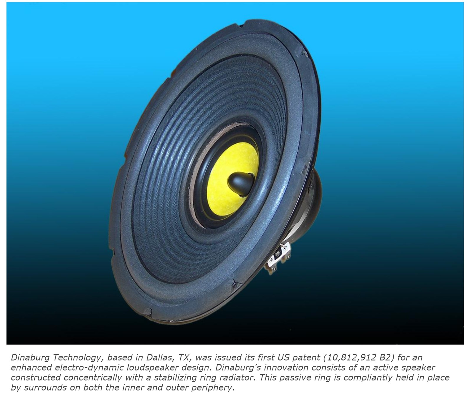

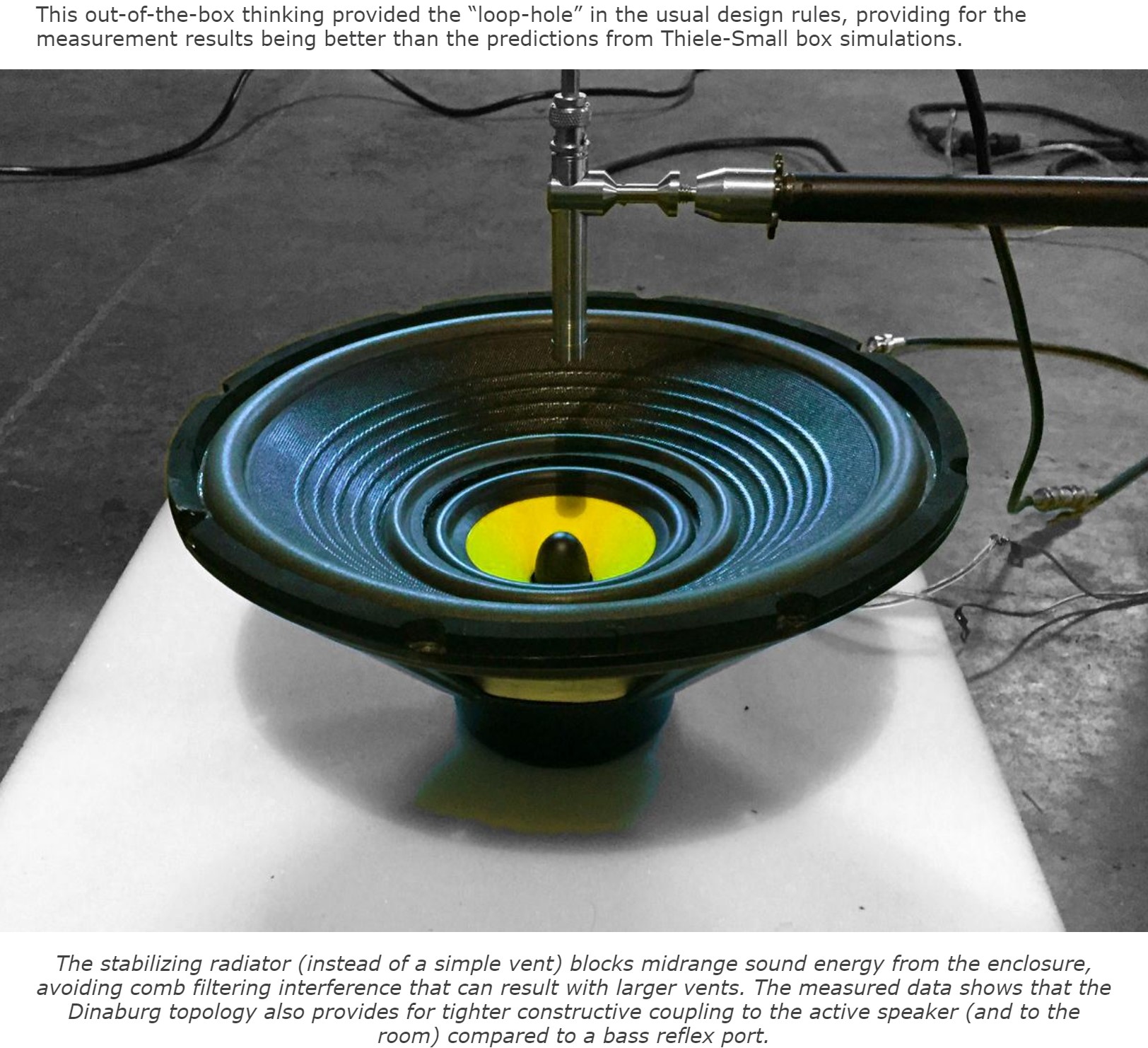

Article in The Audio Voice 10 June 2021 with concept similar to Haze Head's PR coax. I agree that perhaps time to cleve this topic off to its own thread. I did want to make sure you have this input.

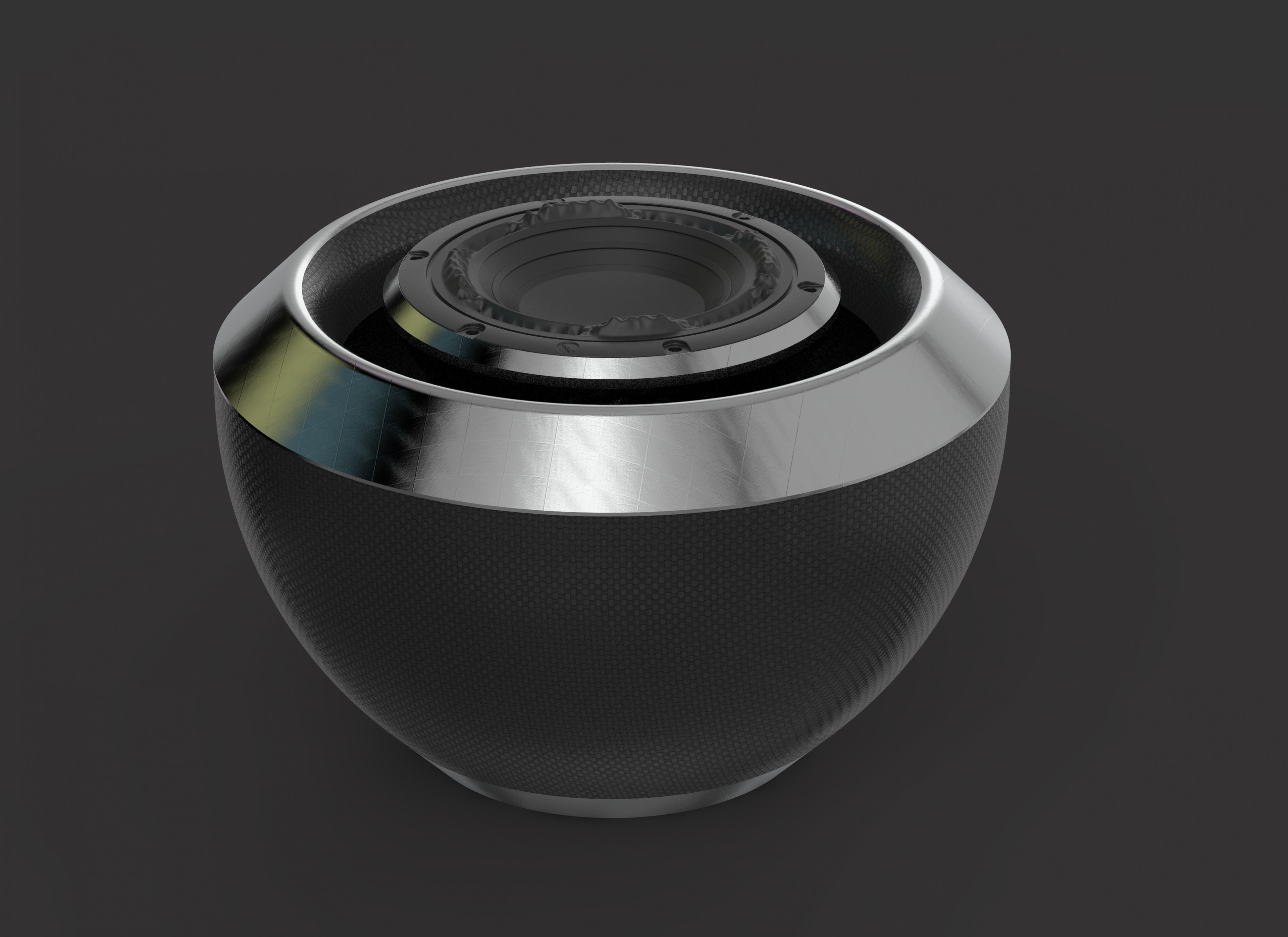

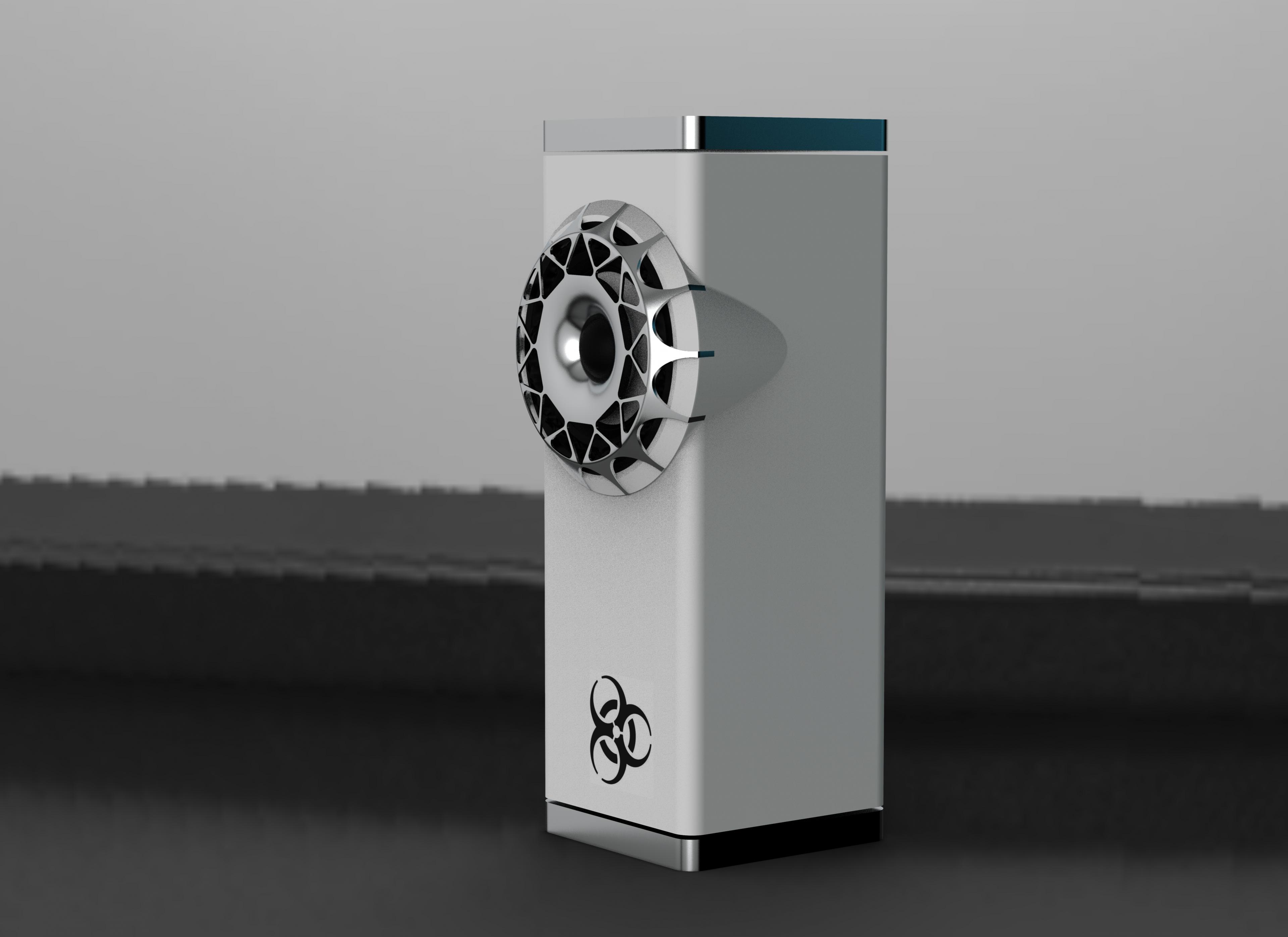

@Norman, glad you like them! I kept thinking the round ones reminded me of something and then I realized.... bedpan 😀 Also, thx for the pdf link.

Hi Haze Head,
I like your creative approach, i think that the most important step for you now would be creating fully functional prototype(s). It´s nice that you have designed this interesting PR solution, but keep in mind, that from conceptual sketch to working and reliable prototype, manufactured for reasonable price is very, very long way, been there, done that 🙂A lot of new issues and challenges will rise, when you actually start to materialise your ideas, but you will also move forward significantly in the direction, that doesn´t exist in the safe world of nice 3D models and renderings.

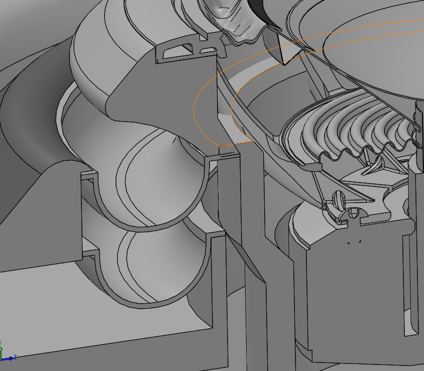

I am trying to understand your posted section shot- so the passive radiator diaphragm is the triangular shape on the left side of the section?
It has double suspension on the inner circle, and the same on the outer, fixed to the enclosure? I don´t see the advantage of this approach... So you will glue the outer suspension of the passive ring to the hole in speaker enclosure forever, without future possibility to replace the part, when it breaks?
I also don´t understand the advantages of the non-solid driver mount with brace behind, could you perhaps explain what this approach brings compared to normal passive with basket, or the double suspension in my link above?
Anyway, keep up the good work, i wish you luck and i will observe where this goes!

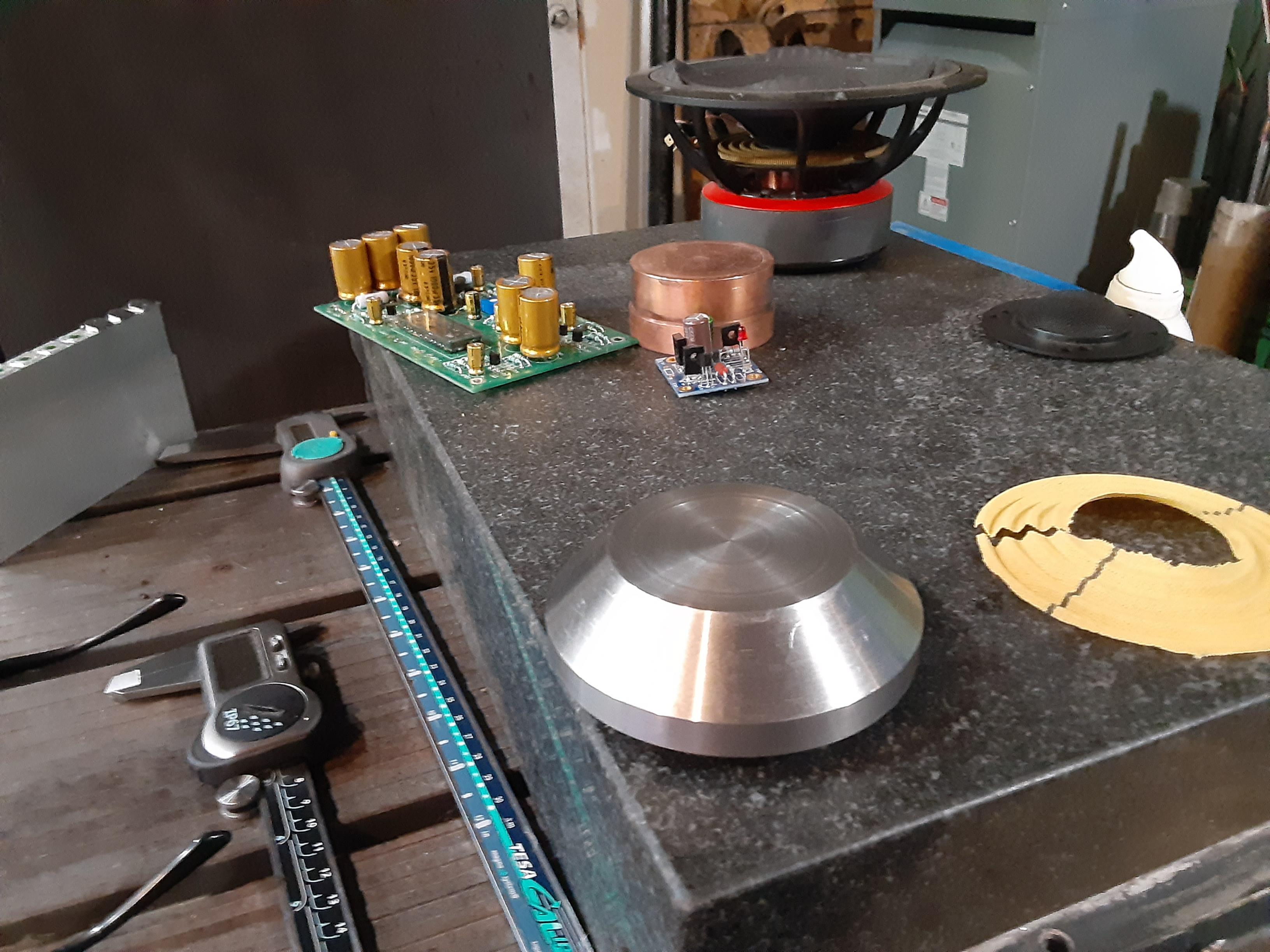

Thanks, Adam, I appreciate the feedback.
As far as that particular setup, and every other iteration I've worked on, the PTT6 is always supported, in this case from the rear baffle. Correct, the darker triangle part is the PR, but don't read too much into the minutiae, as no fine detail is worked out. For instance, obviously you wouldn't want a solid PR, heavy from that thick cross section. But you did hone in on the more important aspect of that configuration, being the inline, axial surrounds.
What I was attempting has, in part, to do with off-the-shelf surrounds readily available, in part to do with making the OD as small as possible, and in part to have a more balanced suspension profile. What I mean by that is I've a concern over the mechanical performance of having an inner and outer surround that will likely have differing excursion "resistance" profiles; unless custom surrounds are designed according to this specific application. I have no problem taking that on, but my material of choice, polyether, is not something I can seem to readily get my hands on.
That model uses dimensions that are tailored for the JL Audio 10W7 surround IIRC. Or maybe it was an 8," I forget. That particular render definitely has some issues but the main takeaway is the surrounds are 1: equally loaded 2: off-the-shelf 3: configured uniquely apart from any of the pre-existing patents. The direction I was headed was that in order to create a more stable PR suspension geometry, I could increase the axial distance between each inline surround, creating a triangular relationship between the PR and each surround.
Regarding the use of renderings vs. real life implementation, I understand what you're saying, and it's definitely true. What I've come to realize about those unforeseen realization pitfalls is that they can almost always be attributed to incomplete modeling. It's often some trivial detail left out of a model that turns into a major headache when reconciling it on the shop floor. After years of noticing this I've grown accustomed to spending most of the time on models and as a consequence it takes major motivation to finally move into the physical realm. It's such a divide that I'll occasionally make something IRL just to buck that habit. But to keep this about the PTT6 I'll add a couple of IRL experiments, contrasted with initial renders.
In homage to the PTT6s low distortion properties, a few parts have been liberated from their bar stock prisons, some more successfully than others. With a little fanaticism about clean lines around the fastener mounts, there are the "INKY" flush mount bolts that are contoured to match the PTT6. Most recent work is on a baffle mold for a slimline, non-PR version for a coaxial PTT build. Also, work is underway on an integrated coax tweeter as part of a grill. The Dayton soft dome is too tall so it's being hacked to use thin neodymiums and a custom thin magnet frame that will allow the tweeter to be sunken in closer with the PTT6 cone. It's something that may or may not ever get completed, but I can say with certainty that if not, it's for lack of an absolute complete model. One final thought about models; that this forum is so model friendly is something I love about it. Over at DIY Solar I would hash out concepts via models and really take a beating over it. It was bad enough that I was making memes about poo pooing models before you've seen the size ones drill bits 😀

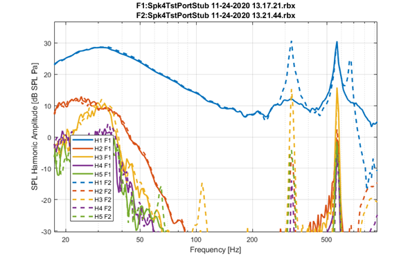

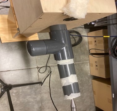

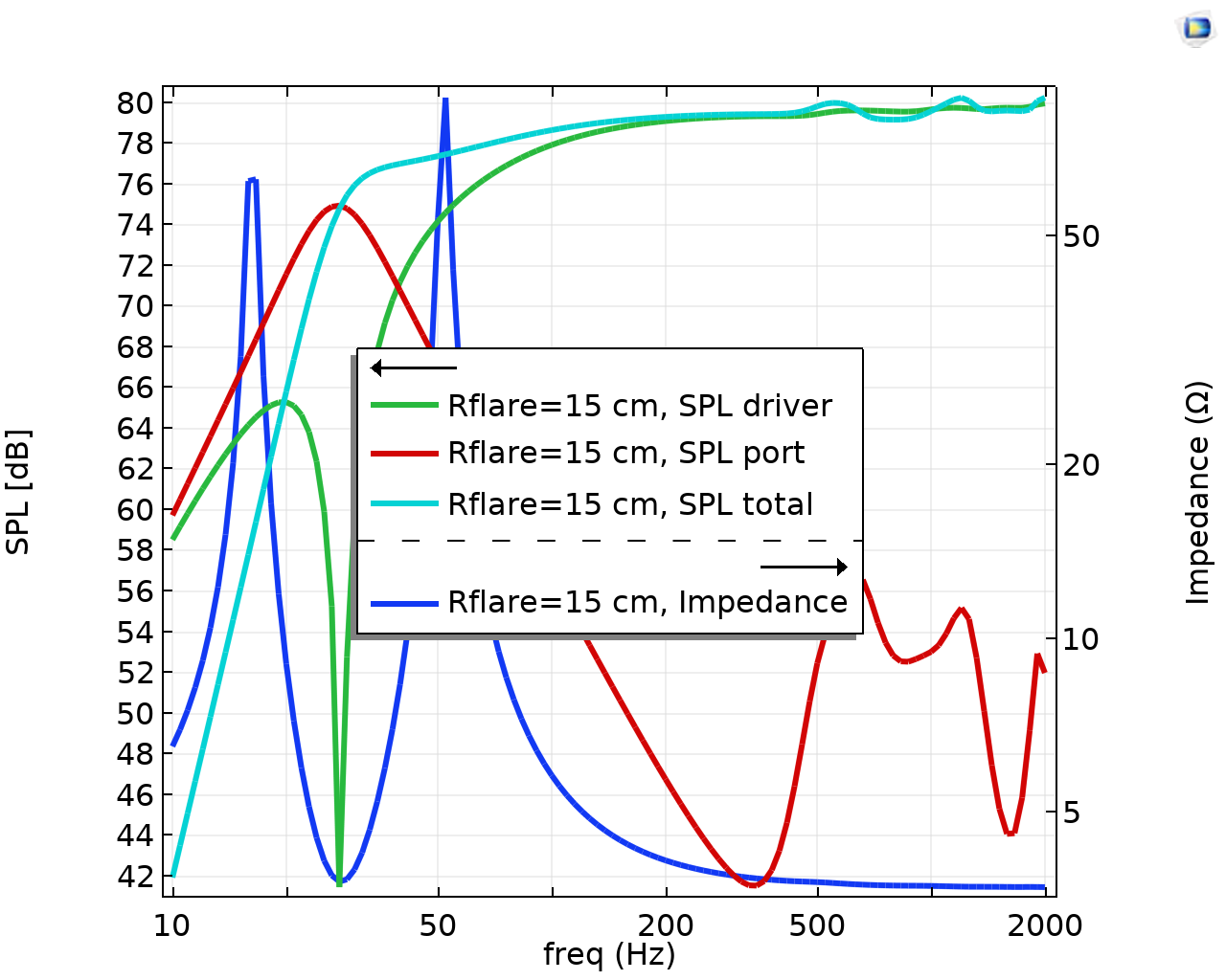

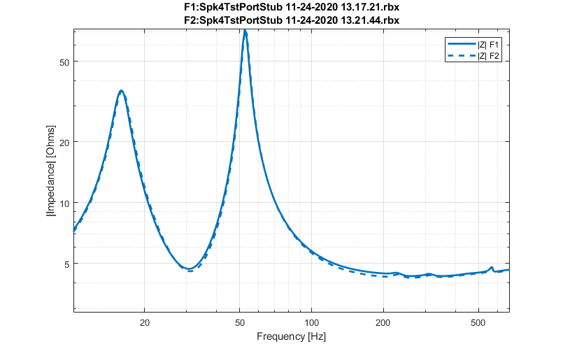

For inspiration, I would like to share a few results on how to improve a port. The PTT6.5 has a low Vas and low fs which enables very deep bass out of a small volume bass. The challenge is that the port gets quite long if it should keep a reasonable port wind speed. This moves the pesky port pipe modes down in frequency where they do more damage. The use of a PR avoids this problem but the PR system is now a 5th order system whereas the ported is only 4th order. The free air resonance of the PR causes a notch in the SPL response which causes a faster bass roll off compared to a port with the same tuning. This also shows up in the time domain where the PR system will have more ringing than the ported system for the same bass extension.
An interesting observation is that both ports and PR's transmit the internal standing modes inside the box. Both act as a mass loaded piston that gets accelerated by the air pressure acting on it. The counterintuitive result is that ports and PR's are quite similar in this respect.
But back to the pipe modes of the port. Several methods are used to reduce the impact of these modes. Port placement makes quite a difference (the pressure inside the box is not uniform so finding the optimum placmeent of the inside port mouth can help quite a bit). However, for a small box with a long port, the optios are limited. Alternatively, damping can be applied. The simplest trick is to perforrate the port at e.g. the middle where the pressure is at maximum for the first pipe mode (port length is half a wavelength). This is quite effective but the perforation also shortens the ort effectively. Another approach is to line the port with damping material (the port diameter must be adjusted to have the same free diameter of air flow. This is difficult to do in practice and the air flow easily gets restricted which lowers the Q of the port.
The method I find most attactive is to add one or more stubs to the port and fill the stub with damping material. This does not block the air flow but effectively damps the pipe modes.
The attached picture shows an experiment with a 57mm ID port pipe with a stub (made using std plumbing parts). Also shown are the port near field SPL with and without the stub. The Q of the pipe modes is reduced drastically and so is the SPL. The impedance graph reveals that the box tuning (frequency and depth of the impedance saddle point) is close to unaffected. Note that the box is empty so the box mode at 600Hz is unchanged by the addition of the stub. These modes need box filling to be taken out.
I have made a simple model in Comsol to simulate the box and port. This allows me to estimate the far field SPL when summing the driver and port outputs. An untamed pipe mode typically causes a deep cancellation dip and a peak. This may not be so visible at gated measurements at a short distance (the box shadows for a port mouth on the back) but will show up in the radiated power and as deep dips in the SPL in the far field. Note that using the damped stub, the summed SPL only has very small ripples across the port mode.
best of luck to you all and thanks for using our drivers,
Lars @PURIFI
