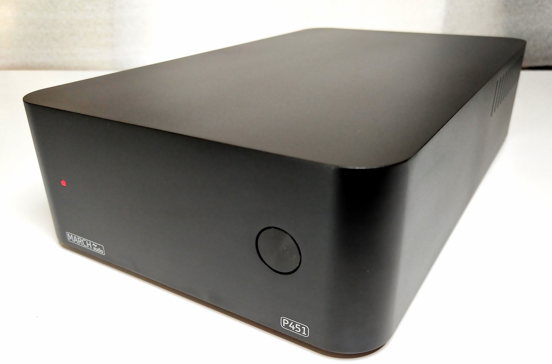

To power the speakers I built (posted on this thread here), I'm using the March Audio amp that uses the Purifi amplifer module.
These monoblocks produce 450W (and are stable into a 2 ohm load). The system sounds really good and very dynamic with the 2 Purifi drivers in a sealed enclosure.

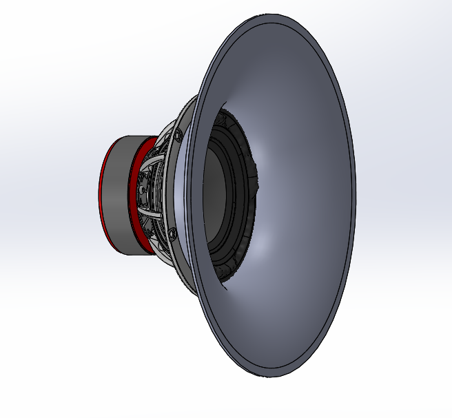

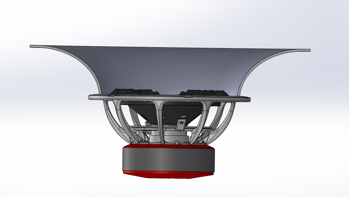

I'm getting closer to doing an IRL build and started with a baffle mold that puts too much tension on the fabric (rib structure composite build). As the construction strategy is being adjusted to deal with said problem I'm seriously considering implementing a full on waveguide into the baffle. There was going to be a 9" pseudo waveguide, but I'm thinking I could crank it up to 11.
Any thoughts as to whether the Ptt6.5 in waveguide is desirable? Thoughts on the current profile?
The dimensions are 12" OD X 5.8" ID X 2.25" deep, putting the contact about mid way on the butyl surround's flat bond surface. Not worried about the connectivity particulars at the moment, just the inner profile and whether it is/is not beneficial to use a large waveguide in general.

Waveguide on a 6.5in midwoofer is to improve efficiency or improve mid range polars? Or both? Interesting idea but the cabinet baffle is now wide. One of the attractions of Purifi was 8in woofer performance in 6.5in package. Plus, you have moved the acoustic center of the woofer even father back making time alignment with the tweeter more difficult. Putting the tweeter on waveguide to move it back helps but ideally, tweeter needs to sit behind the woofer to get time alignment.

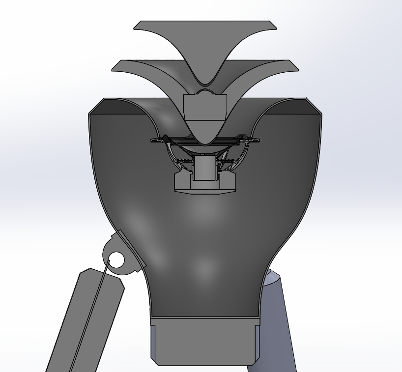

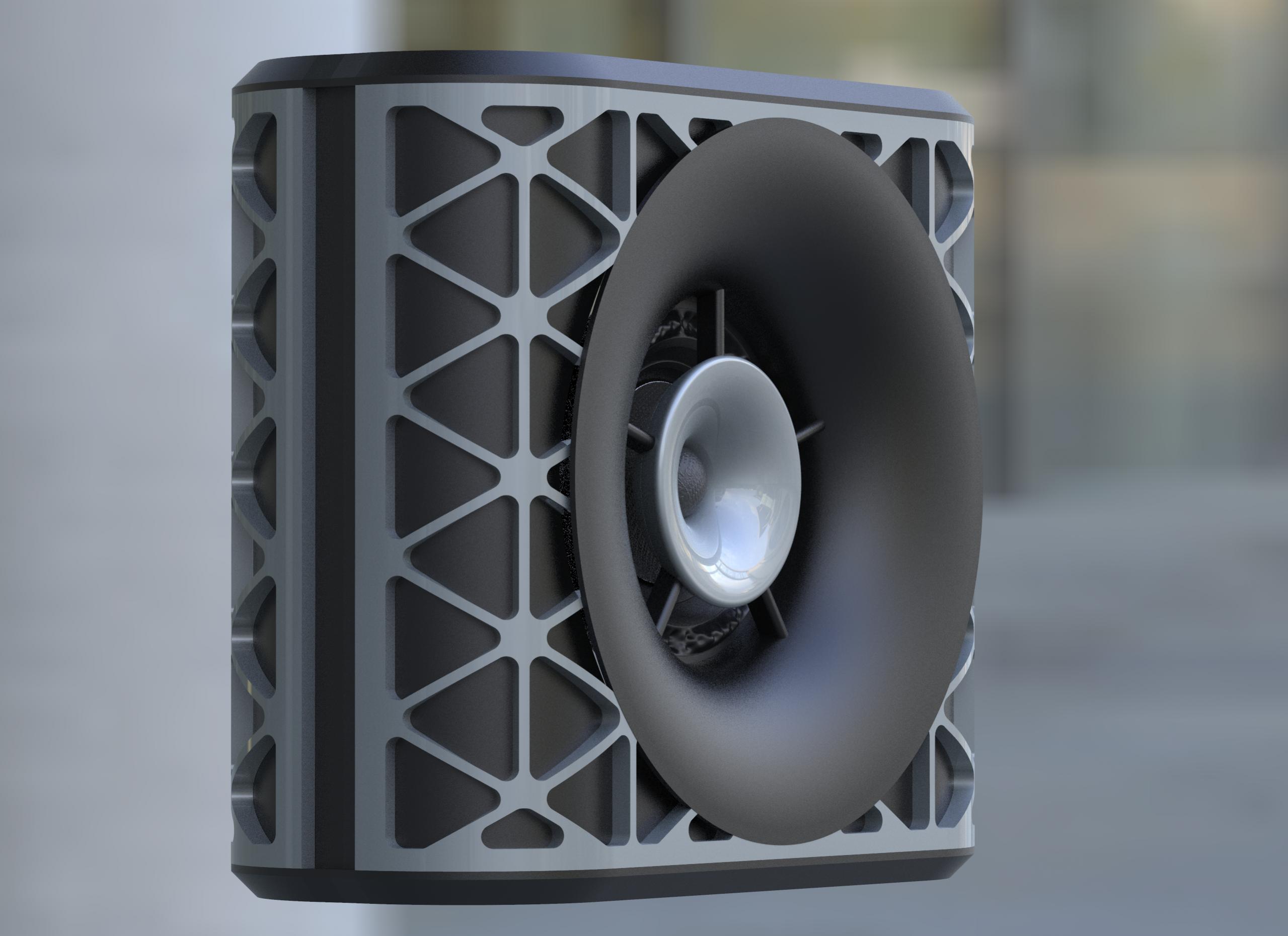

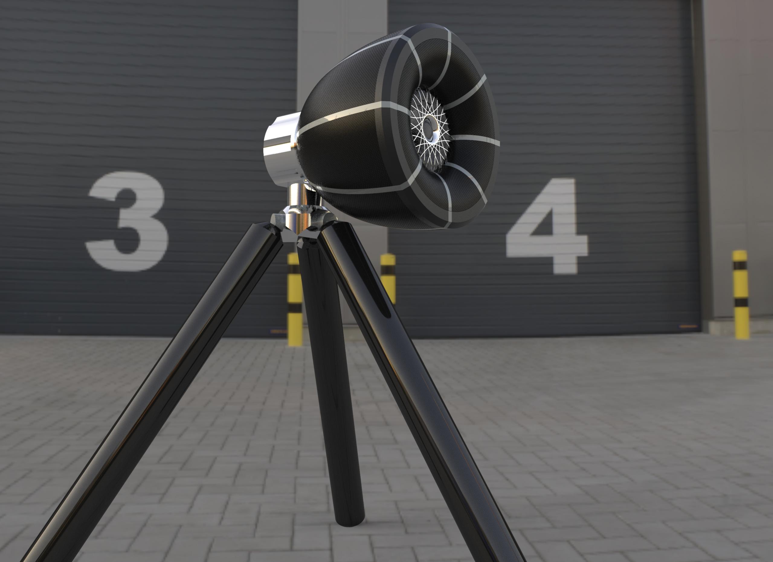

Starting to think that listening preference is going to be the decisive factor-
I've heard the 'nearly perfect' sounding full range rigs that basically are amazing for acoustic guitar w/vocals. That is not what I want. I like intense 'holographic' sound that works well with industrial/electronic music. Heavy/rich/punchy, if I had to use three words about my system goal.
One strategy that (at least on paper) seems to do what I want is the omnidirectional stuff. I've never heard one so I don't know if this is actually what I want. To Allen's and X's points about alignment; it looks like the omni config. will solve this issue as an added bonus?
Judging on listening preference alone would omni be a contender or should I be in slim baffle camp, or wide curve baffle camp, and finally the big fat waveguide camp? I have four baffle (two under construction) geometries emerging each is quite different; but not sure what to mainly focus on. Also, everything recent has a coaxial tweeter, for better or for worse, so there's that.

You have so many amazing looking designs there. Before spending a lot of filament lay down time and fortune on 3d printing, making mock ups out of foam core and listening might be worthwhile.
I don’t think you get holographic imaging with omnis. Narrow, good round overs on baffles seem to do better there. Good XO implementation is also critical.
@X
Yes, it seems I was conflating imaging with something different. Having recently stumbled on the LXminis and all the praise it got me thinking about that config. strategy. I really need to just hear the various styles for myself, and like you recommend, just try them out in lesser developed iterations. The initial thinking with the 'pseudo waveguide' and full waveguide was to minimize baffle edge diffraction, with the waveguide being the 'first edge' encounter. Thus freeing up the ability to have a more diffractively intrusive geometry after the waveguide. In other words, have a large frontal area but mitigate the usual consequence of doing so.

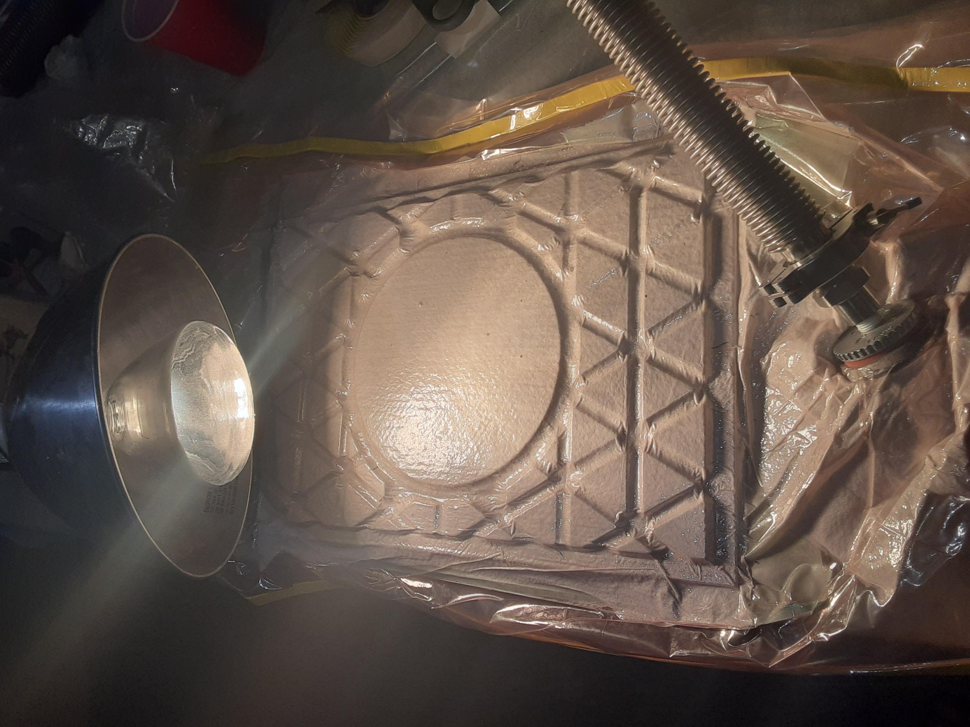

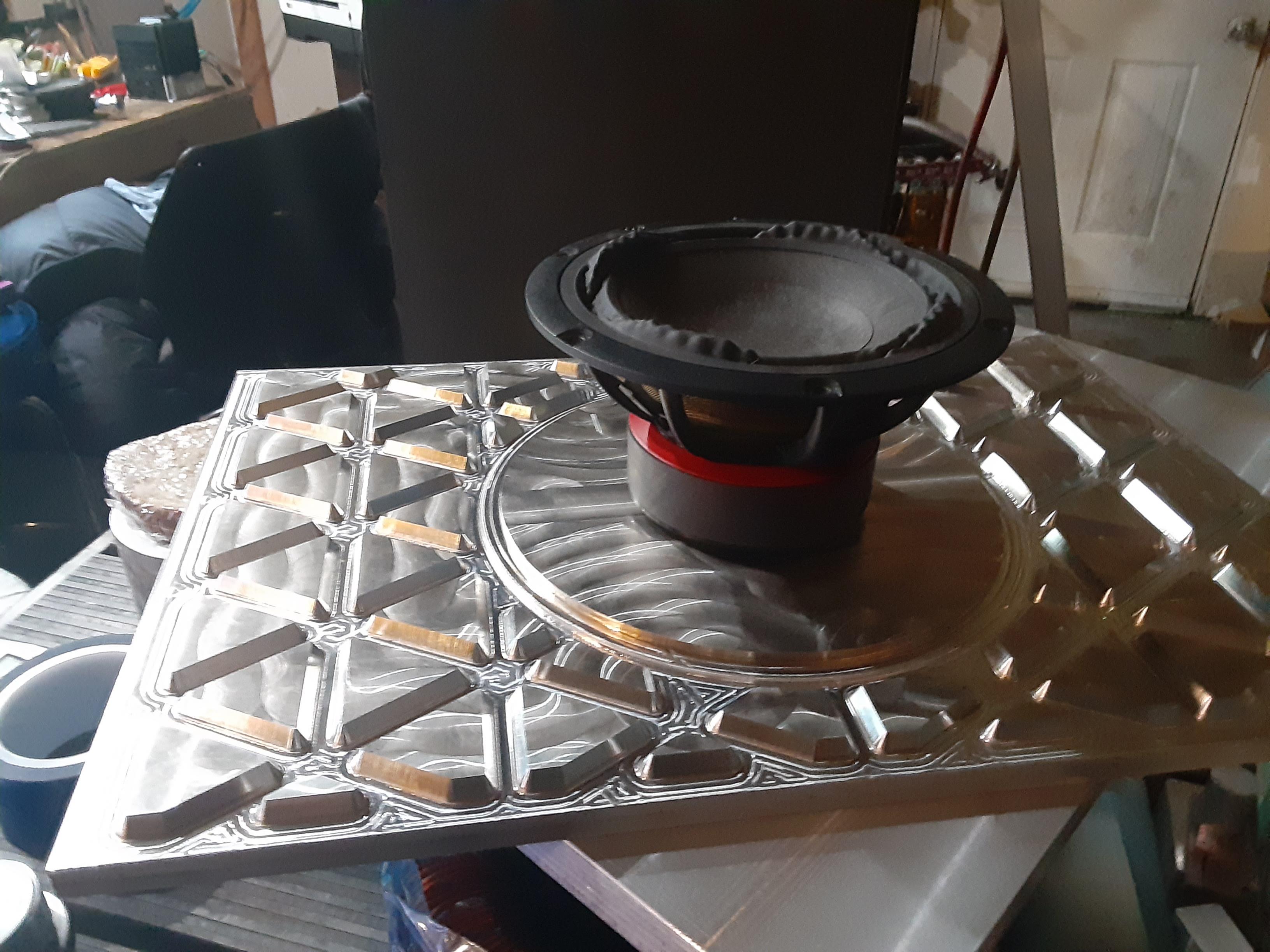

At any rate, I solved my construction challenge and now have a viable set of techniques to make lightweight/stiff iso-grid panels. The 12" X 18" baffle with 8.5" to 5.75" pseudo waveguide weighed in at 1 pound. So a 15L cab would probably be around 5 pounds, or as little as 2.5 if I want to get extreme with the layup. It's a huge step toward getting the PTT boxed!
