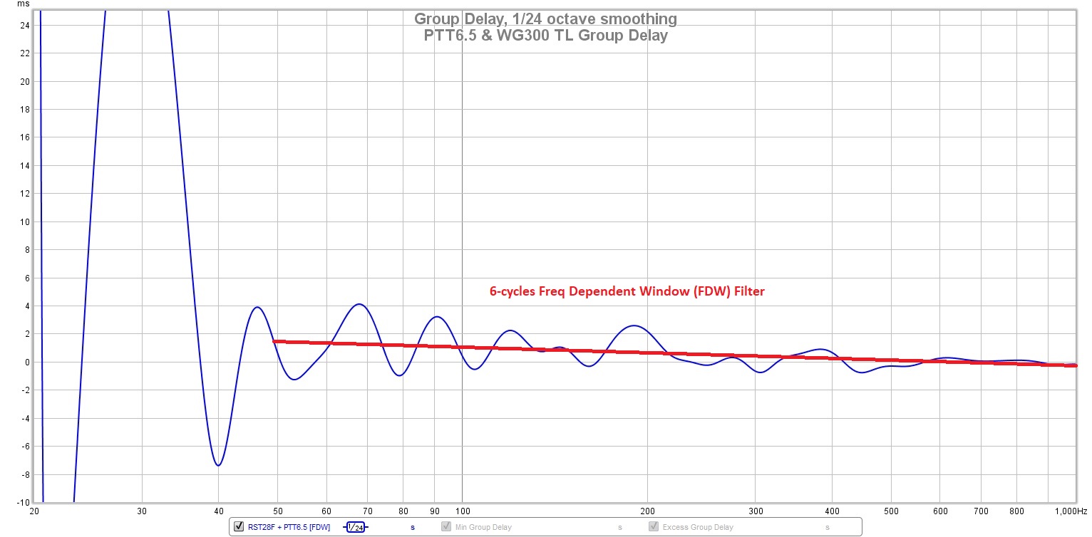

Question for XRK971 -
For your TL design ( page 21, dated May 24th '20 )
Do you have a group delay curve you can show ?
I'd like to compare against the Purifi application note ( modelled in Hornresp ) and a simple MLTL I did with low port tuning that was not entirely successful.
Thanks !

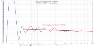

Hi IslandPink,
My measurements of the PTT6.5 and RS28F in a WG300 waveguide with the Harsch passive XO and TL yielded an average group delay of about 1.5milliseconds (I added a visual indicator straight line by eyeball to show the "average" value) at the 50Hz kickdrum frequency. It blows up at the corner tuning frequency circa 30Hz as expected as there is a round "knee" there and room modes dominate so it doesn't matter anyway. There are some wiggles and oscillations in the GD (+/- 2.5ms) due to a ripples in the frequency response. But the average group delay with 6 cycles FDW filtering to remove the effects of room modes. The number I like to look at is the difference between the GD at 100Hz and 1kHz. For this speaker, it is fairly low and indicates an excellent timing-accuracy between treble and bass.
Thanks !
and 'wow', that's quite a lot different to a simulation of the empty TL.
Roughly what stuffing plan did you use to achieve this ?

Basically as described in the plans: line main rear chamber with eggcrate foam and one side of the remaining TL with one side. No foam on the final path to the exit. Add poly fill stuffing from closed end to the first turn. Increase stuffing density to taste. Measure impedance sweep and look for point at which the double peaks straddling bass tuning frequency start to combine together to look like an single “horned owl’s head with two ears”. Adding reticulated fish aquarium filter foam (large pore size) at the terminus can also be used tune the impedance peaks. Use this sparingly as it is very sensitive here. Maybe 1/2in thick at most.
