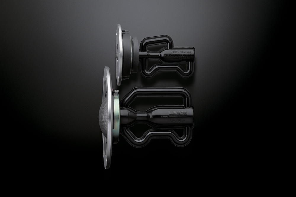

Lars, thanks so much for sharing above in post #816 on your work with damping port resonances. The first two paragraphs belong in a speaker design textbook. How often have I read the misinformation that PRs ‘block’ internal box resonances?
Your tuned and damped stubs remind me of those Yamaha uses in the new NS-5000 to better damp back waves off the domes. In their case not so much stubs as tuned pipes connecting the volume ends.
I am really jealous of the NS-5000 design team working inside Yamaha. On Monday someone gets the idea to use tuned pipes for damping. On Tuesday call the guys in the saxophone, trumpet, and French horn division to talk about acoustics in pipes. On Wednesday call the motorsports guys and discuss how they tuned the sound of the YZF-R1 and the V-10 they did for the Lexus LFA.
I often add a “stub” in my horn speaker designs while simulating it in Akabak to attenuate a peak. The formula is simple: calculate the 1/4 wave length of the frequency you want to reduce and make a “T” in the flow either through channels in the wooden cabinet or add a PVC pipe. I have seen Darnley use a big 4in PVC pipe stuffed with fiberglass inside one of his tapped horns.
For example, if you have a 300Hz peak you need to attenuate, that’s the same as an 11.2in long stub. Adjust the stuffing to get the level of attenuation you need. The placement of the stub is important and that’s where the simulation can help with optimal placement. You will want to place it where the sound is generated so that it has the most impact. So typically upstream near the driver vs the the horn mouth. For a reflex port probably near the inlet of the port is more effective than the middle.

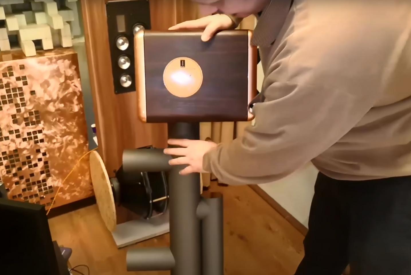

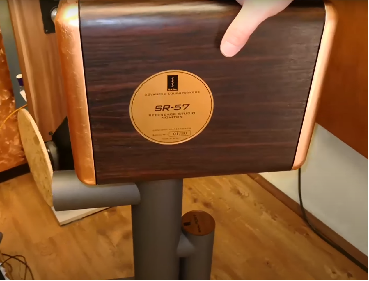

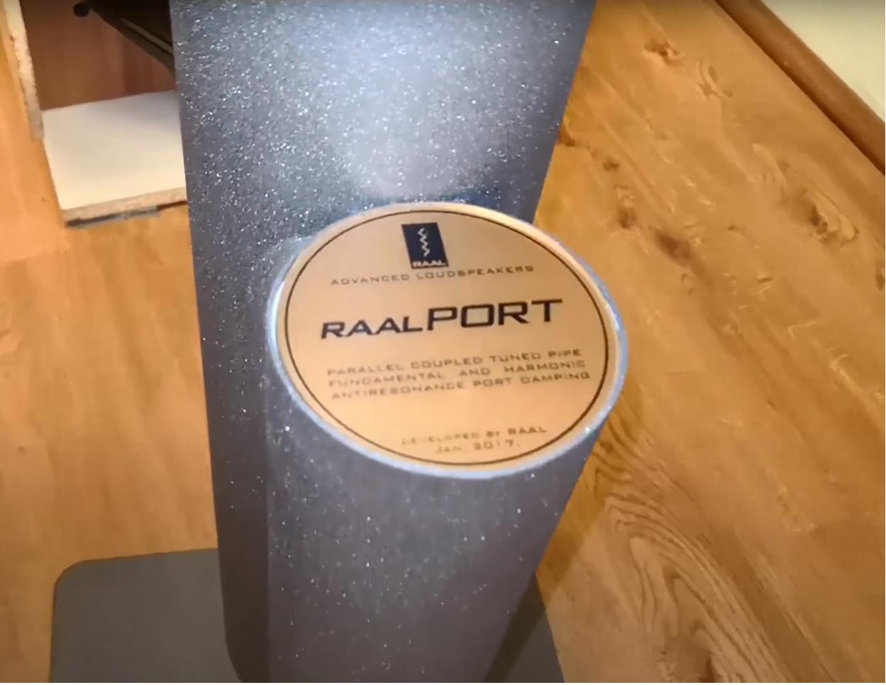

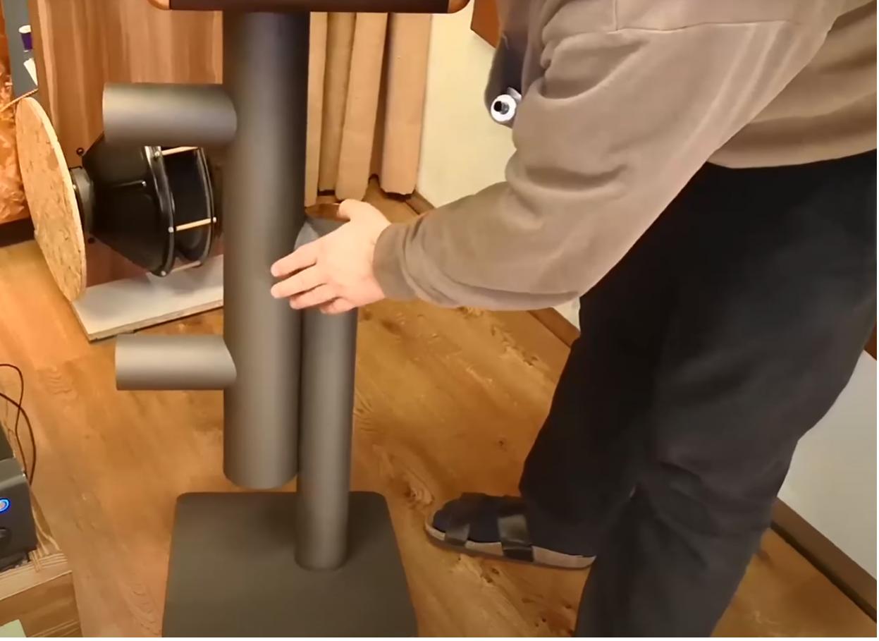

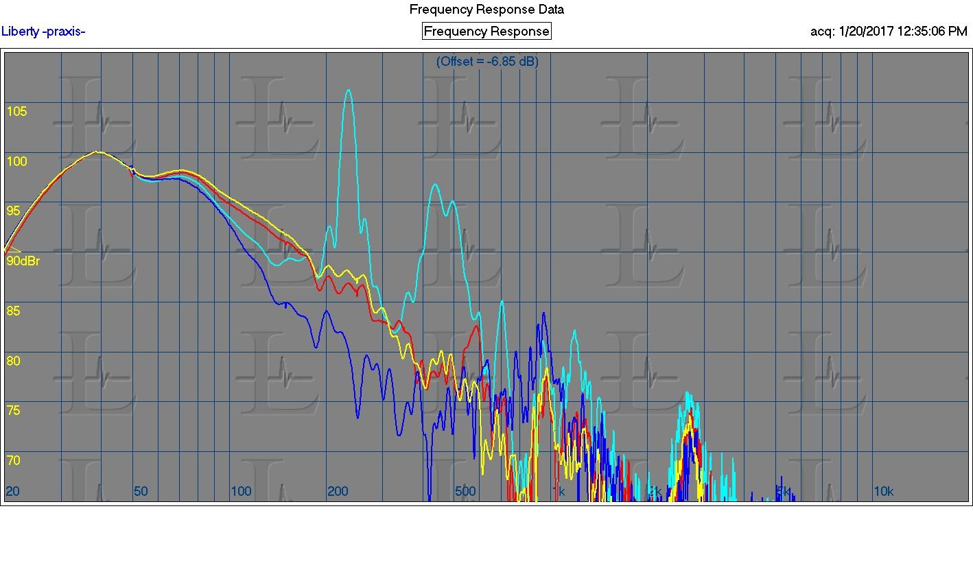

Aleksandar Radisavljević aka RAAL did something on that subject in 2017. He incorporated stubs into bookshelf stand. He used really large port diameter to get rid of chuffing but then was left with horrible resonances of such a long pipe. Measurements before and after. Few pics attached:
Turquoise - regular pipe
Yellow and red - with acoustic dampers
RAAL Advanced Loudspeakers SR-57+Benchmark AHB-2/DAC-3L+CD Transport Zoran Dimovski, 31.03.2018, - YouTube

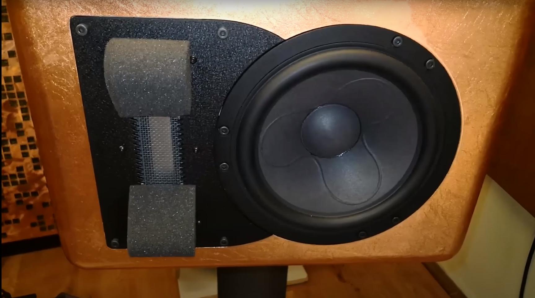

Lars, can you post some pics of the internals of the port and the stuffing? I've been investigating this here and while I can damp resonances successfully, harmonic distortion and chuffing get much worse, much earlier.
Hi Brandon,
Thanks for sharing. The port is simply a 57mm ID tube and the stub is made using a T section without much roundover. The port did not have end flaring so it was whistling loudly when sweepng it witout the stub (air flow exciting the pipe mode) and was silent with the stub. I will do some more measuements on port compression and distrtion next time. The air may hit some of the sharp discontinuities around the T section and make noise. I see that you use some slits and damping material on the outside?
Lars
View attachment 962422 View attachment 962423 View attachment 962424 View attachment 962425 View attachment 962430
Thank you for sharing! Very clever port design. Looks like 2 shorter and one long stub.
Hi Brandon,
Lars
Yes, wool stuffing in a chamber the taps feed into. I've moved to ever smaller slits hoping to get non-linear performance back up, but no luck. It would make sense that no matter how small the taps, if they are effective at damping the port resonance then there must be air rapidly vibrating or breathing into and out of those taps. This must create turbulence that the rest of the air mass of the port must interact with. I wouldn't think the Polk idea would be any different but they claim it is so I'll test that.
Yes. Two shorter positioned at 1/4 of the port length and one longer positioned at 1/2 of port length.
