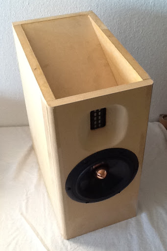

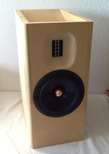

- I thought I'd share this , GR Research has an interesting Idea... they made a little Studio Monitor using one of their Mid-woofers and their new Redesign of the NEO3 Tweeter which most agree is a Great sounding tweeter - ( also one that won't break the bank ) -
- The woofer is in it's own compartment, but the divider between the top of the Mid-Woofer compartment and the tweeter is slanted up so the NEO3 can radiate back and up... and those that have heard it say it adds some very nice detail and " spaciousness " to the sound. Might be a Great sounding combo with the Purifi driver!
- ( spaciousness - is that a word?) - 🙂
Neat stuff. Basically a dipole tweeter with upwards reflected back energy for spaciousness. I have played with this by adding a dome super tweeter aimed straight up.
Spaciousness is a real word. 🙂
Think I'm with hallcon83 on this - great idea.
