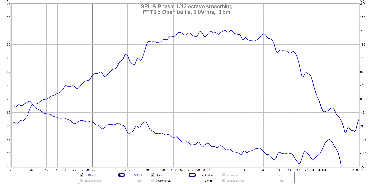

Here is a measurement in a 10in wide open baffle running full range no filters - looks like a good midrange! No breakups, flat and smooth. You could cross this at 350Hz and 2.5kHz easily as “mid range”:
If you are looking for a design that uses two PTT6.5 per channel, I think the TWW in a TL might be very hard to beat. An MTM is possible too but the TL alignment works better with the drivers closer together. The other option as I mentioned before is a bipole with front and back facing drivers and that will reduce baffle step loss for circa 5dB more sensitivity.

It seems to be very little room to come with some criticism in this thread but I’m going to give it a try. Regarding weight of the cone and BL my findings are that it matters a lot in terms of midrange openness and dynamics.
I built the tl as very nicely presented by Xrk with the PTT6.5. Several versions of crossover was tested. With more and less bsc and at different frequencies to meet the tweeter. All versions came out with a bit closed and boomy sound.
Finally I swapped to accuton c173-6-191e in the same box just to try. This comparison didn’t come out in favor of the Purifi driver. Another driver I compared with is the Phl1220 which brings more snap and liveliness and is, in my ears, on par with the accuton.
This is of course my personal opinion. Each to their own. The Purifi is a very bass capable driver, low distortion and you can play loud without it changing its character.
Correlation is not causality. It didn't work for you and you blame the cone mass, but you don't actually know if that was the case.
@hallcon83: Quite a sweeping statement, considering what is possible using minidsp (or similar) digital out, with good quality DAC. the linked modules look OK for what they are, but I also wouldnt consider them a step up; not in the slightest. If high quality analogue input is required; match with a high quality ADC. the idea of using pre-set filter modules seems kind of arbitrary IMO.
You’re right, I don’t know. I’m not blaming the cone mass. When it comes to midrange performance I blame the driver as a whole.🙂
