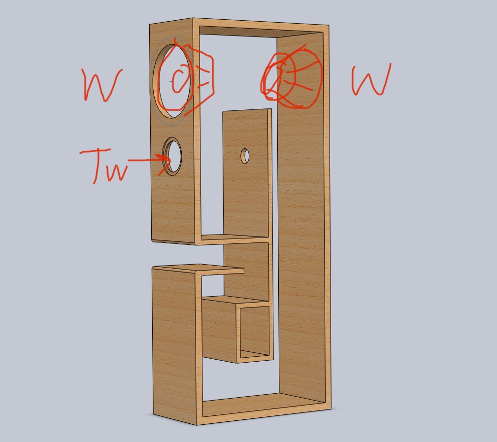

Hi xrk, your the man ...... I have a question , I'm having a hard time figuring out what your dipole or dual Purifi Mid-woofer TL would look like , could you draw what you meant when you described adding the second Purifi woofer and changing your TL design to tall version for me?
This is a markup of the TL for an RS225-8, but it would be very similar in look and size to what I had in mind for how to do a bipole PTT6.5 TL. I would use a waveguide loaded dome on the bottom just like how I have it now and use the passive Harsch XO for a transient perfect speaker. The XO and TL design would have to be tweaked of course.
- Hi xrk, Thank you for the help , now I understand what you were talking about, a drawing really helps - would you put some kind of support between the two drivers , a pole or something to help cancel out vibrations? - I was also wondering ,do thing that would lower the bass frequency cutoff like down to the low 30's - high 20's?

@hallcon, yes a brace made of a strip of 3/4in ply between the two magnets would be useful. Although the opposing cone motions will cancel out vibrations. The bass extension has to do with the TL length and taper ratio. The extra woofer will give more SPL and the bipole will reduce the baffle step loss and so in effect, increases the F3 bass extension deeper.

Regarding the bi-polar construction as shown in the drawing: At low frequencies it will work as expected. But at mid frequencies there have to be constructive/destructive interferences between "front fired" sound and soundwaves that originate from the back driver, "wrap" around the enclosure and then also propagate forward.Awesome! Subbed to the thread! If it turns out okay, I'll make them my next build for sure!

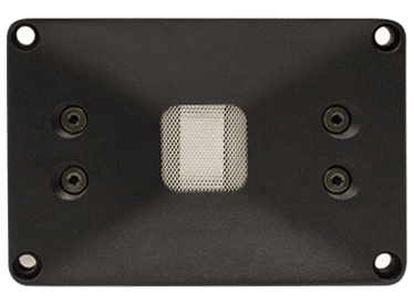

- I found another interesting Tweeter that I thought I'd list just in case some haven't seen it. It's a Ribbon designed as a point Source. Anyone had a listen to it??
Well, about the Raven "called" point source, I have yet to see some polar plot in both horizontal et vertical plane...
Thanks for the tip on the Raven. It looks interesting. I have a RAAL and a 3d printer does might try something like this. I have tried a deeper tractrix and there was too much destructive interference dips. But a shallower design like this maybe interesting. Although won’t give me the deeper physical setback I was looking for.
