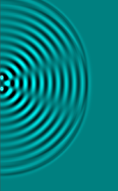

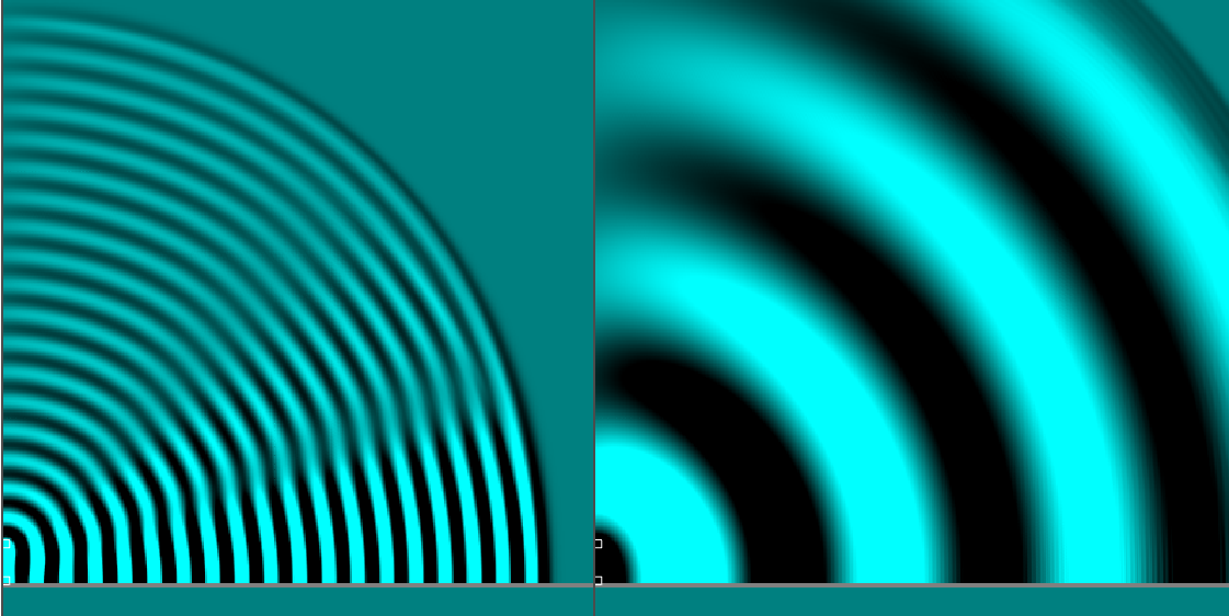

dimensions,
Take a look at the first image, the source is elongated. A wavelength is shorter than it on the left, but longer on the right. The line offers directivity down to a frequency related to its length. (The visual intensity is a guide only)
number of drivers required,
The second image uses the same source length but it is made up of only two small drivers, one at each end. Due to the space between them, their ability to work at higher frequencies is compromised.
The LX Mini woofer is sealed. It's temping to think a different woofer would be better but it's no slam dunk that it would be. The LX Mini is a very well thought out design. I think the bigger interest (for me at least) would be to try it with 4 channels (one per driver with the LX Mini design) of the Purifi amplifiers.

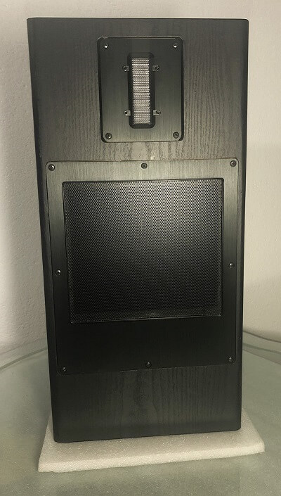

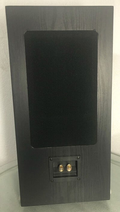

- Here is a picture below of the speaker that BZ designed the BS-3R that shows the general looks of the new drivers - the strange rectangle on the back of the speaker believe it or not is the size of the Port! BZ said that the woofer moves so much air that it has to be that size...
