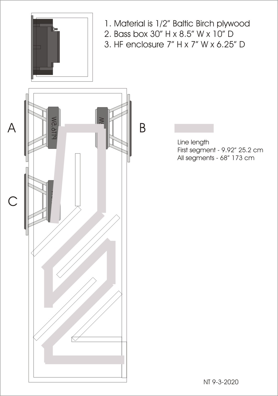

I had a few minutes to play around in hornresp.
2 drivers in about 36.6 litres, F3 is about 32hz
I will draw something up later.
I can't seem to figure how to add jpg's here (???)
But the line is 163cm long
beginning area is 426cm2
termination area is 65cm2
centre of the 2 drivers is offset 25.2cm from the beginning of the line.

Lets call this FiTL
In post 392 hallcon83 asked “I have a question , I have 4 Purify Drivers and am not sure of the best way to use them - does anyone have suggestions for a design..... ? ..... Or another way to approach this, if you had 4 drivers , how would you use them, what would you build??”
Xrk971 responded “Wire two in series as bipole (Push push front and back Magnets supported with common brace) in tall floor stander TL.
- 8 ohms impedance at 88dB
- No baffle step loss - true 88dB sensitivity at 50Hz
- Omni pattern
- Vibration cancellation”
Then AllenB opined “Stack them and attempt to gain directivity to manage vertical reflections.”
My reaction to both suggestions was YES, that’s a good idea. Actually which is the best is in my experience related to how the room they will be used in is setup. If I can site the speaker well away from the back wall sign me up for the push/push bipole. If the situation demands closer back wall placement then drivers need to be on front panel.
Then in post 404 ontariomaximus posted some rough starting TL parameters for such a TL featuring two PTT6.5W04 woofers per speaker. This all fits in with a short tower design I have been toying with featuring a tweeter on top inspired by the Kaiser Acoustics Kawero Classic.
The little tweeter box on top allows playing with time alignment and different tweeters (I’m a bit of a tweeter slut always switching). Of course the other oddness in the attached sketch is surely three not two woofers. The idea here is this TL could be built with its pair of woofers in locations A & B for the bipole or A & C for a forward fire configuration. Lengths are more or less along ontariomaximus’ with the fat grey lines measuring the center length. Angles are all 45 degrees because those are fairly easy to achieve on table saws, router tables, and CNC. Did not bother drawing those angles on panel ends for sealing at this very preliminary stage. Some will object the turns are too sharp. My reply is the bass I want out the line end port will have no problem making that turn and I plan for the higher frequency content to fail to turn instead bouncing around getting absorbed by the acoustic filling.
Comments and discussion welcomed. I am a complete neophyte to transmission lines and readily admit this is all highly speculative and preliminary as I climb that learning curve. Moving the second woofer between B & C locations effect on the line tuning is the first thing I wonder about. Is this ‘close enough in practice’ or would the interior need to be tweaked to more closely hit the 25 cm beginning of line to drivers’ center spec?

Hi Norman,
That’s sort of what I had in mind too but had not considered the dual drivers on the front option. I would try to keep rectilinear 90deg bends as it’s easier to build. But the slanted passages may reduce standing wave cancellation. Good idea of having an external tweeter box that slides back and forth for time alignment - important for a tweeter slut (albeit, high priced tweeters) haha

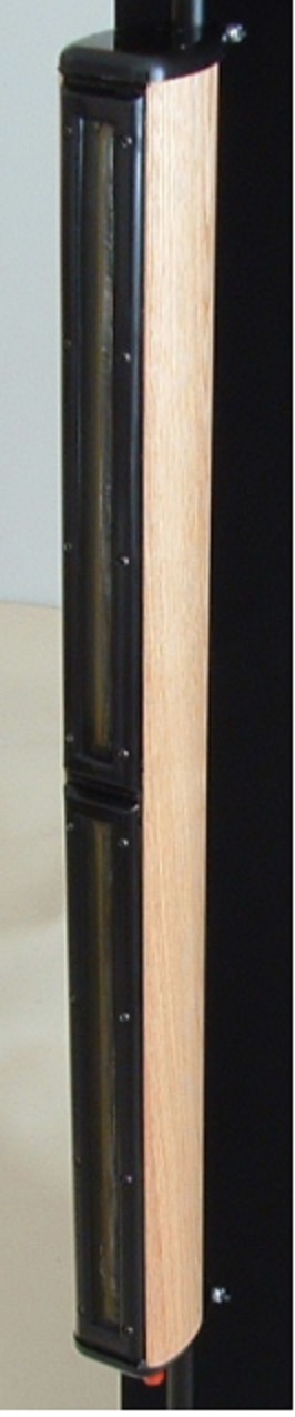

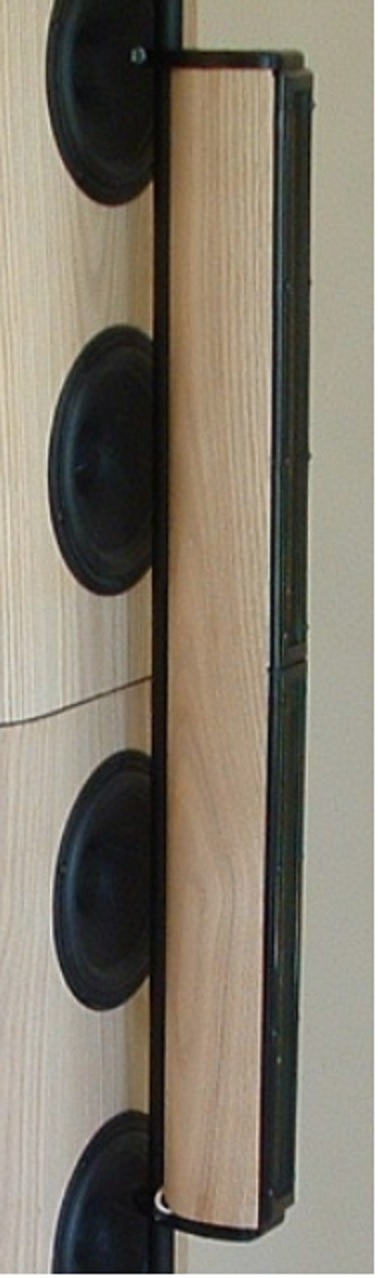

I found another interesting tweeter - there is a company out there that has a new version of an older Ribbon tweeter design, NewForm Research - Their Oval Ribbon driver's can be crossed over around 1,000 - 2,000 Hz, It's also very rugged and capable of Hi output , and is a very easy load to drive - "The Oval Ribbon is designed for use in a Coaxial Ribbon Line Source system but will work exceptionally well in any conventional Ribbon application" and comes in 15, 30 and 45 inch sizes.
