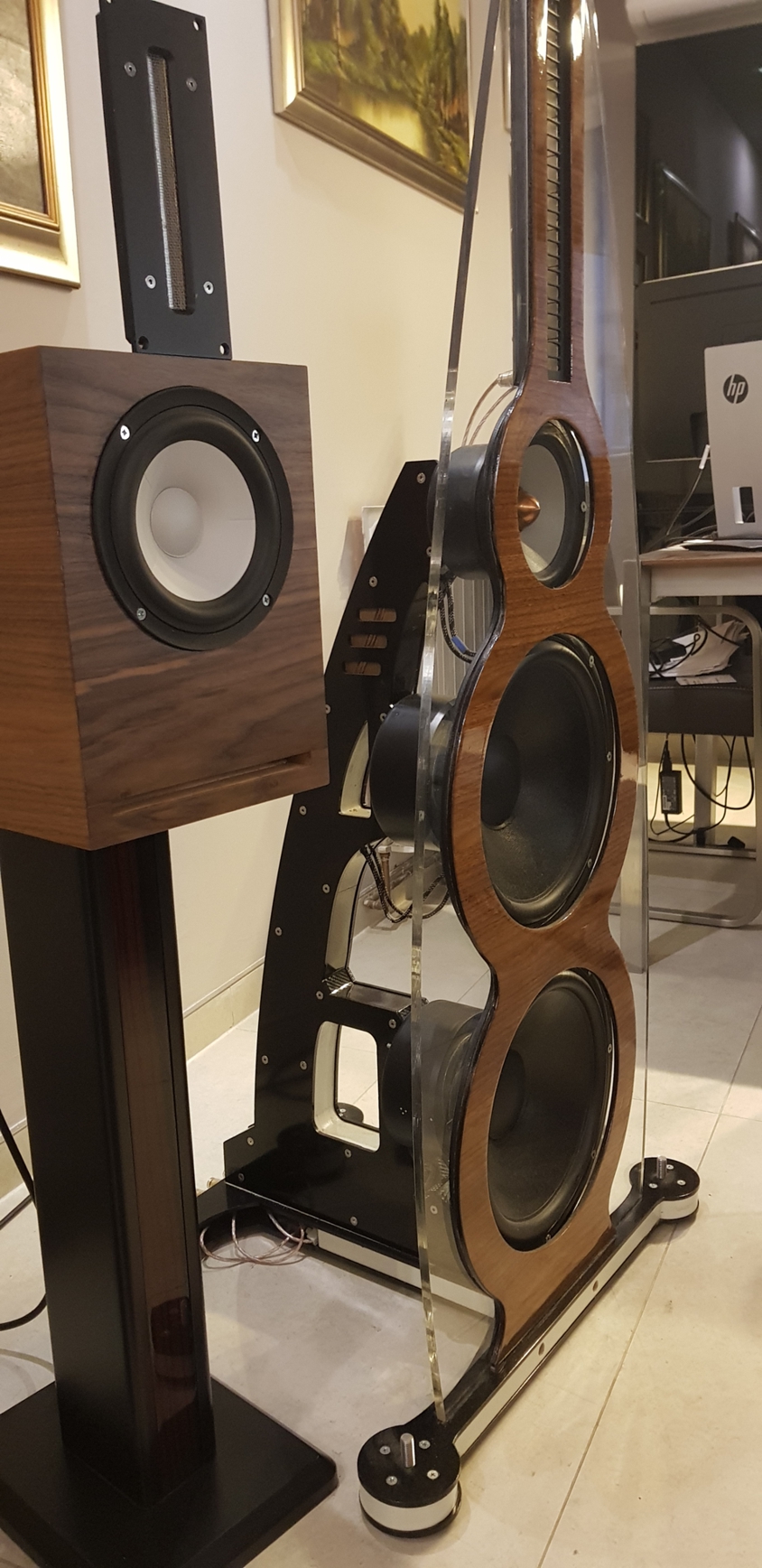

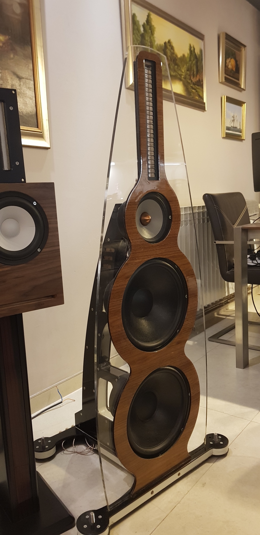

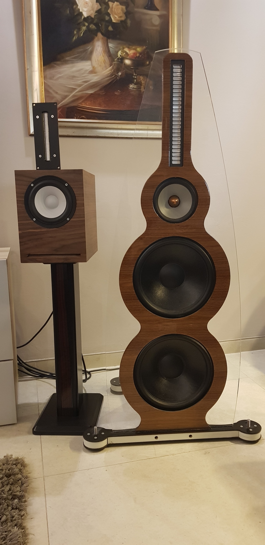

I've designed SB17CAC with my own dipole ribbon. Crossed at 1550 Hz LR24dB.
Minidsp 2x4HD used for crossover. Sound fantastic. Ribbon radiating in all directions. Much more realistic sound then with classic speaker.
Idea is to use Purifi 6.5 instead SB. Even if I don't believe that midrange will be any better with Purifi.

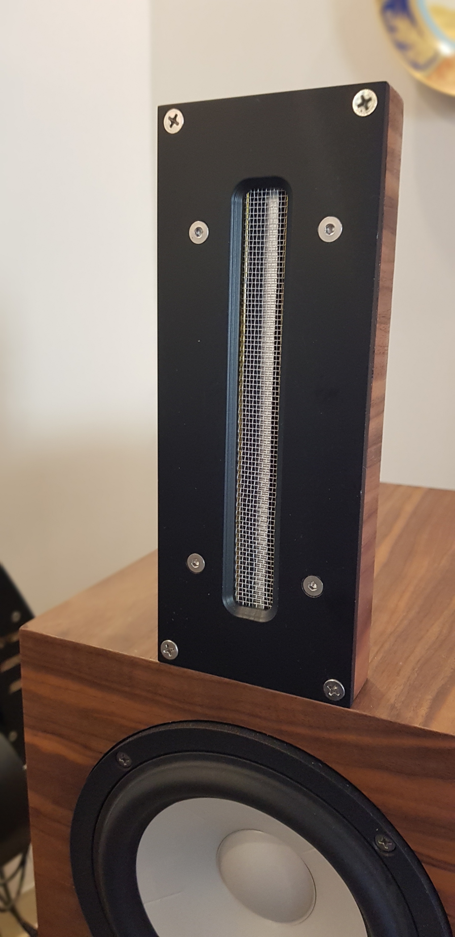

@Tesla Audio: Please describe the design and construction of your interesting ribbon tweeter.
Also, any performance measurements you may have made for it. Thanks.

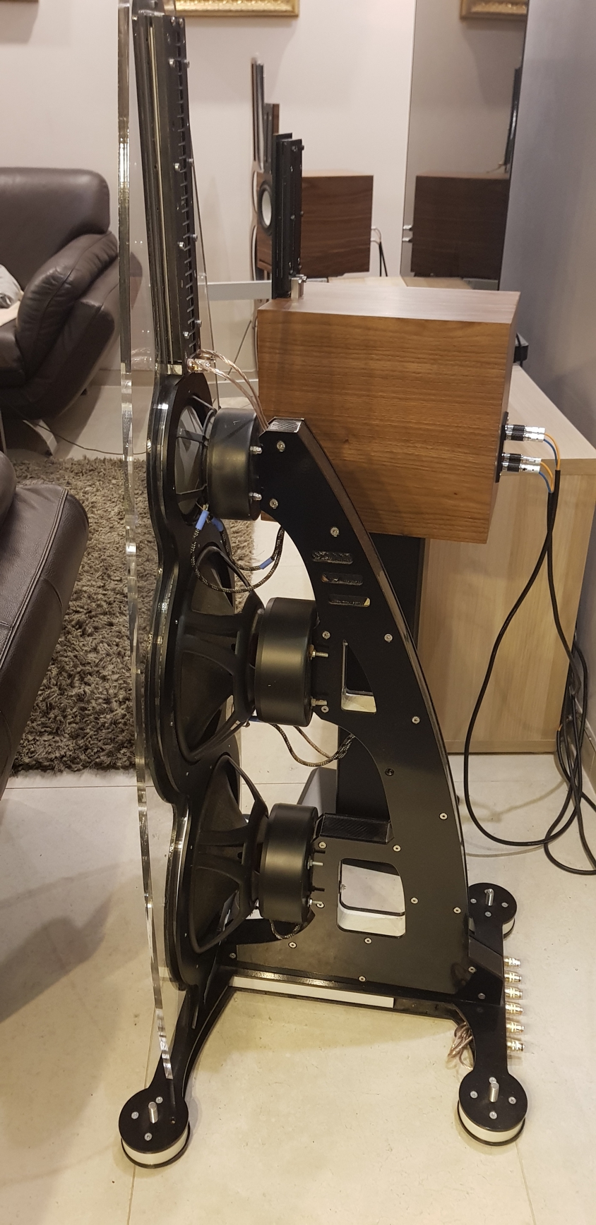

Ribbon is open in back side same as in front. Double array of Neodymium magnets is used to get more homogeneous magnetic field. 5 micron aluminium foil 150mm long and 14mm width. Gap between magnet and foil is closed in order to get less distortion. SPL is unbelievably flat, measured with calibrated Sonarworks microphone and ARTA/REW sw. In attached photo you can see response at listening position. Lower level arround 3-4kHz is advisedly made by DSP to follow ISO 226:2003 rules.
They are very nice Tesla, but you should show them big OB
No problem Cindra. Here you can see bigger brother 300mmx25mm dipole ribbon in 3-way OB system.
