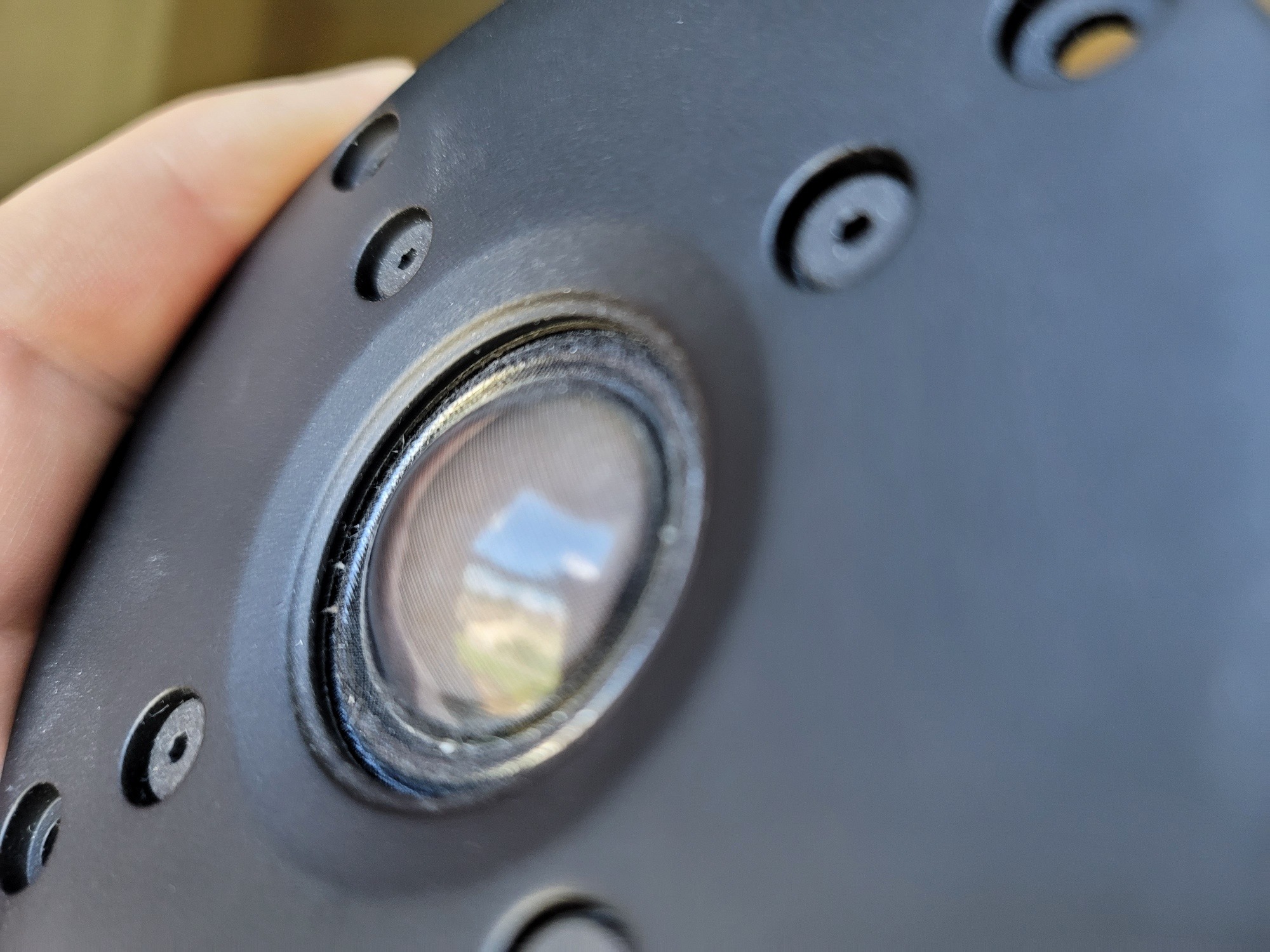

I have never boutght the name "phase shield" Piece of plastic tape or cast in front of the center of the dome most likely attenuates axial spl by making an obstruction for wavefront (not blocking) to modify dispersion. Sort of like what a dimple dome (ring radiator) does. Spl attenuation might mean also phase shift , but does is it just semantics?
Delaying axial waves from the tip of the dome like hifijim said - how could that happen? By making those waves to travel longer, past the shield?

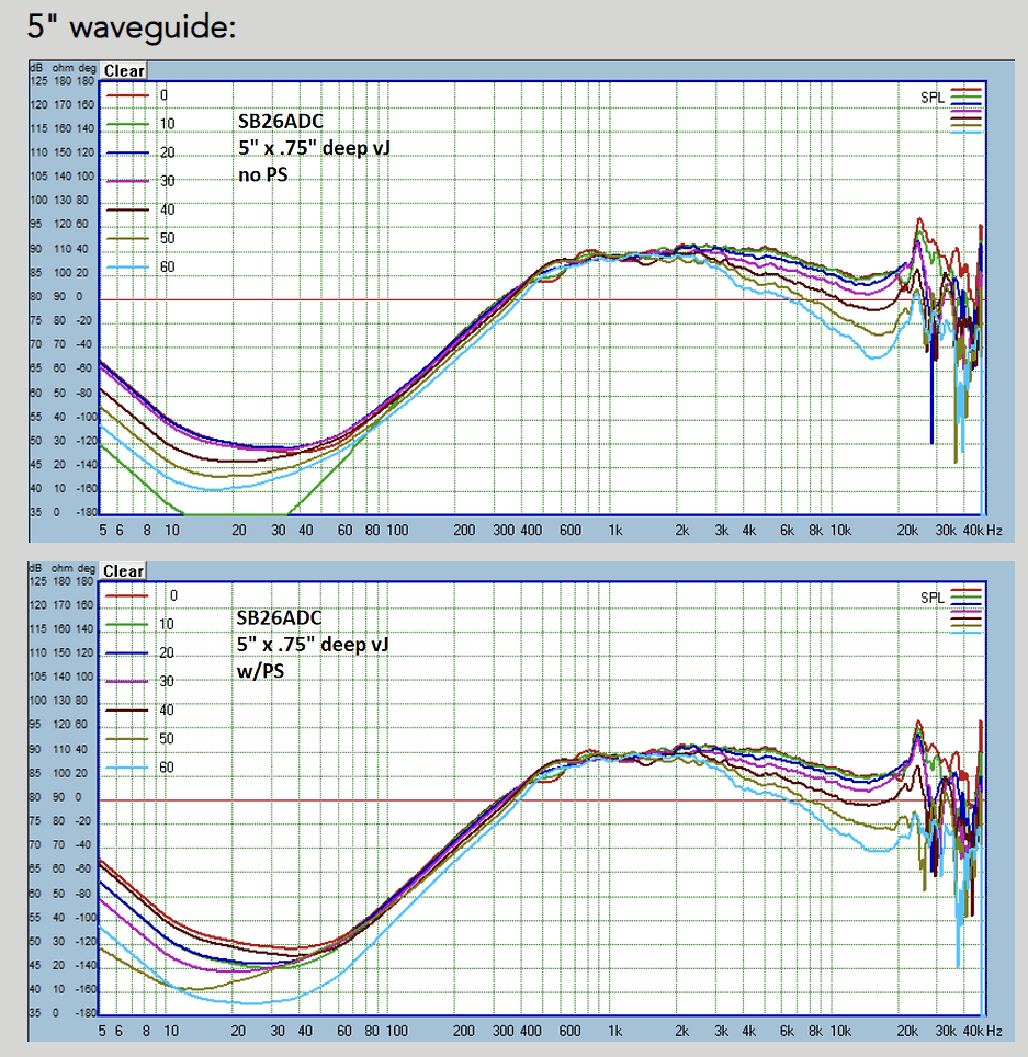

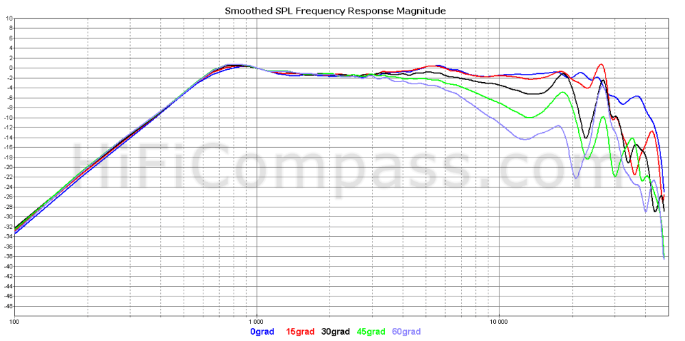

You might be better off thinking of it as reducing phase cancellation. In the SB drivers it also supresses the ultrasonic breakup peak on axis as seen in hificompass's measurements.
Compare augerpro's waveguides with and without phase shield, you can see that without there is more of a deepening off axis null forming around 16K. The phase sheild smooths this out. So the value depends very much on the driver and any face plate or waveguide to decide if it has any useful value.
I think it is more than just attenuation, and I sort of doubt there is much attenuation anyway. At 16k, the wavelength is 21 mm, so half wavelength is 10.5 mm. That is about the height of a typical dome, so when listening on axis, the sound from the center of the dome is 10.5mm closer than the sound from the perimeter, which means we get a cancellation at 16k.I have never boutght the name "phase shield" Piece of plastic tape or cast in front of the center of the dome most likely attenuates axial spl by making an obstruction for wavefront (not blocking) to modify dispersion. Sort of like what a dimple dome (ring radiator) does. Spl attenuation might mean also phase shift , but does is it just semantics?
The small disc in front of the tweeter increases the path length of the sound wave from the center. The trip from the center to the edge of the disc and around adds ~ 10 mm of distance.
Hello,You might be better off thinking of it as reducing phase cancellation.
It functions much like a phase plug in a compression driver (horn).

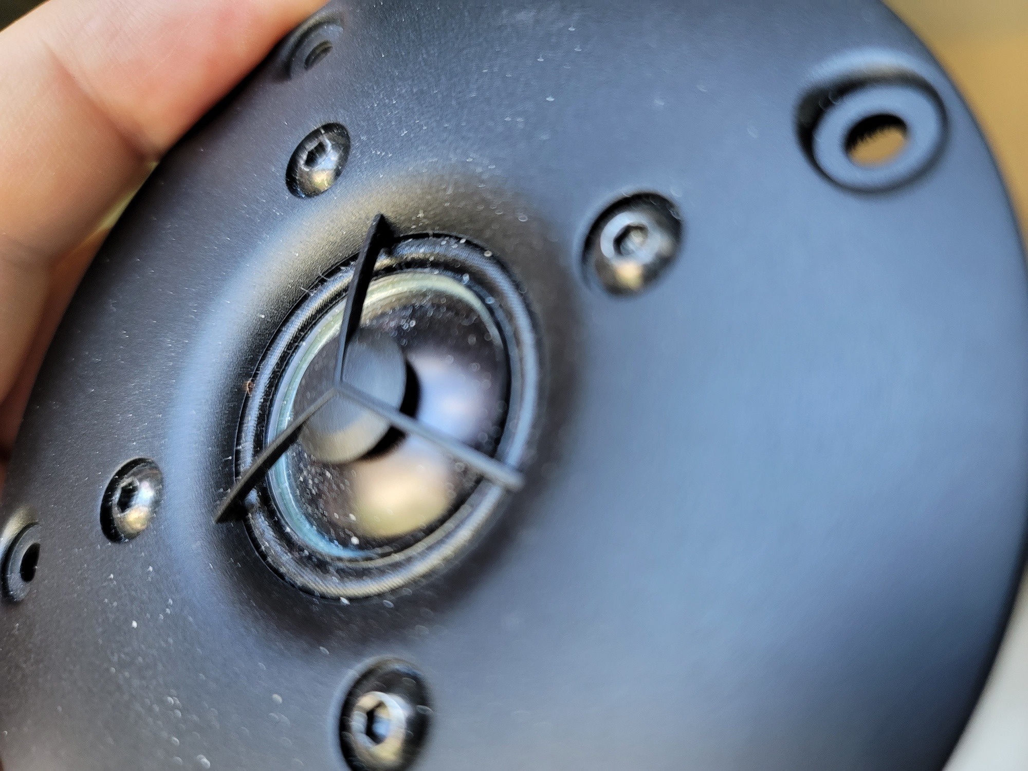

For grins a SB26ADC-C000-4 tweeter installed in a VISTON waveguide.

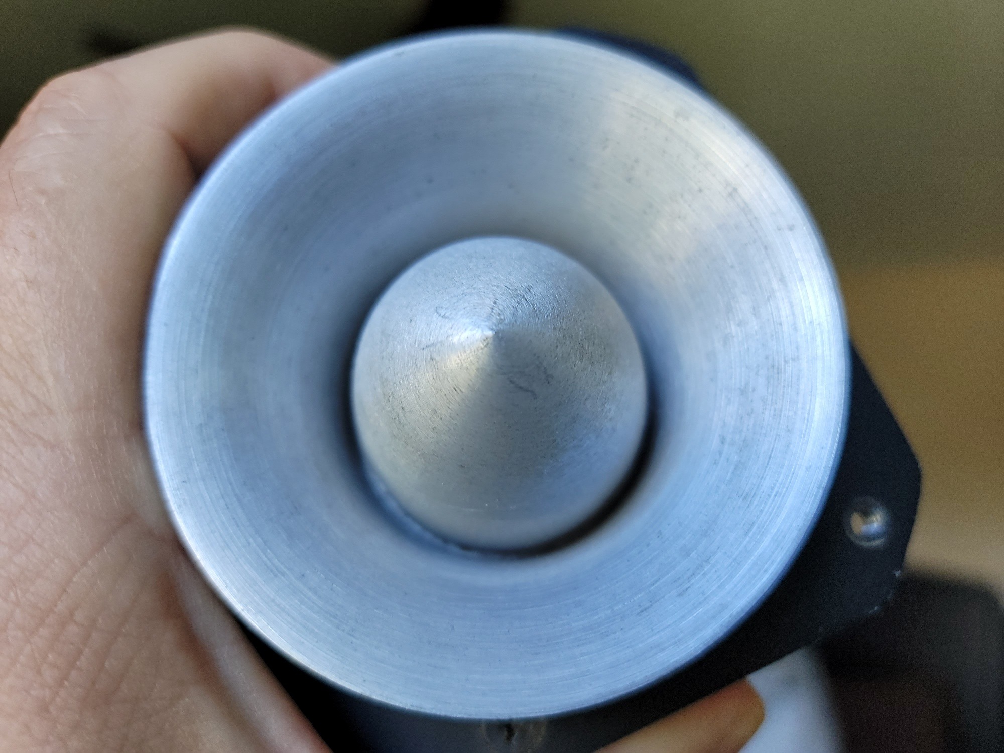

See the attached photos:
The tweeter measurements in post 2371 were made with the tweeter and waveguide in photo #4. fyi
