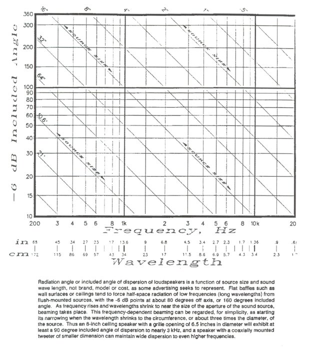

Just for fun. -6dB coverage angles for different size piston drivers. If I recall this is from Altec Lansing of yore.

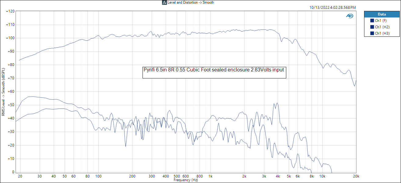

My PTT6.5M drivers have such low harmonic distortion that they are below the THD+N noise floor of my Behringer UMC202HD audio interface...With the 6 1/2 Purifi mid-bass drivers these speakers have much lower measured distortion than any of the other crop of Mid-Bass speakers that I have measured.
this is a plot @2.83 volts with AP Microphone, APX1701 amp and interface, and APx555 analyzer.My PTT6.5M drivers have such low harmonic distortion that they are below the THD+N noise floor of my Behringer UMC202HD audio interface...

Yes agree. To properly characterise ultra low distortion drivers I have to turn off all the HVAC and measure when the environment noise is at its lowest. I also find it help to measure closer than 1m. Eg. 50cm for +6dB and 31.6cm for +10dB improved SNR respectively.
Of course your mic needs to be capable of measuring this SPL without becoming too distorted on its own so be careful of absolute levels.
A clipping microphone/audio input shows high levels of distortion for ALL harmonics at the frequency that it clips.

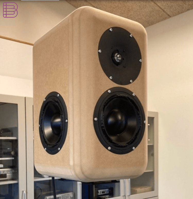

Here is an appetizer of the new tweeter with ultra wide controlled dispersion. in-box measurement at 1m (gated). Will demo next week at the High End Show in Munich. See our FB/LinkedIn for more details. Our web is also updated to a brand new version in the coming days. There will be a white paper about the new demo box View attachment 1172586

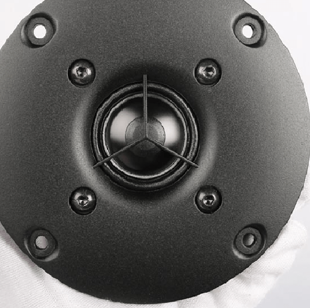

Looking at the attached photos of the SP16 and SB26ADC-C00-4 tweeters.
The circular disks that cover the center of the tweeters look to be similar.
Do they have similar function? Do they reduce beaming of the tweeters at increasing frequency?
It is my impression that they do.
Thanks DT
In the case of the SB26 tweeter, that is a phase shield. It delays the sound wave from the center of the dome just slightly so that it matches the sound wave from the perimeter. The center is a few mm closer to you than the perimeter, and at 16k - 20k, there can be some cancellation. The phase shield corrects this.
In the case of the Purifi tweeter, I would not presume to guess what is going on. It could be a phase shield, but it could also be a more sophisticated wave guide process...
@DualTriode
On the SB it’s a phase shield. It functions as @hifijim proposed. Hard domes are pistonic by nature. The second function is to protect against dents, I suppose. A soft dome, if dented, can be massaged out, with little impact on the function of the tweeter’s frequency response. (The breakup in the soft dome was chaotic prior to being dented). The micro-acoustics expert René @ Acculution could explain it better then I ever could.
On the Purifi what you’re seeing, and if we are looking at the same thing, well that’s also a phase shield. But the entire geometry around the dome’s periphery is a waveguide. Its highly optimised geometry + the baffle geometry is responsible for the constant directivity with a beam width of 70 degrees. This overcomes one of the limitations of traditional waveguides- controlled, yet limiting, dispersion
So altogether I think Purifi have called it their Coherer. It’s a nice name and I wonder if it’s patentable.
