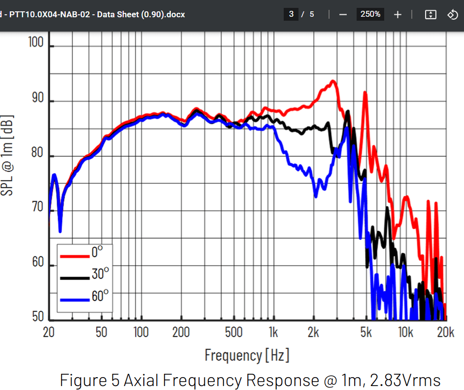

It’s a baffle effect.@lrisbo nr II: maybe a daft question, but: why is the SPL graph not totally flat (purely pistonic behaviour) in the 100 to 700 Hz band, but instead shows a number of minor dips?
What is the (electro-mechanical?) mechanism behind that?
The same phenomenon exists in other manufacturers data sheets.
To avoid baffle effects you need to take a nearfield eg. 15mm measurement, or a truely infinite baffle.

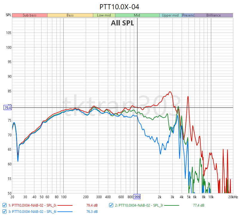

Thanks! I am investigating why the sensitivity is different from the 2.83Vrms graphs@lrisbo

Here's a screenshot for datasheet on the 10" woofer:
Zoomed in:

When I imported into a viewer- here's what is shown:
The sensitivity for the Frequency Response Data for the PTT10.0X04 zip file for download on the website seems too low:
This difference also exists for the PTT8.0X datasheet. (not shown)
For people unable to take their own measurements, this may be a little confusing. Can you please advise?

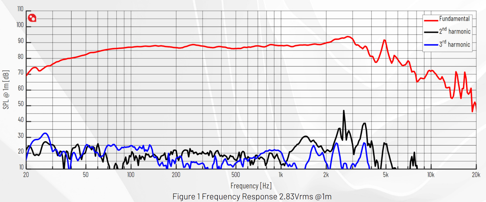

In any case, the level of 2nd and 3rd HD below 60 Hz is really impressive. It would be impressive on a 18" pro subwoofer, but on a 10" it is amazing.
