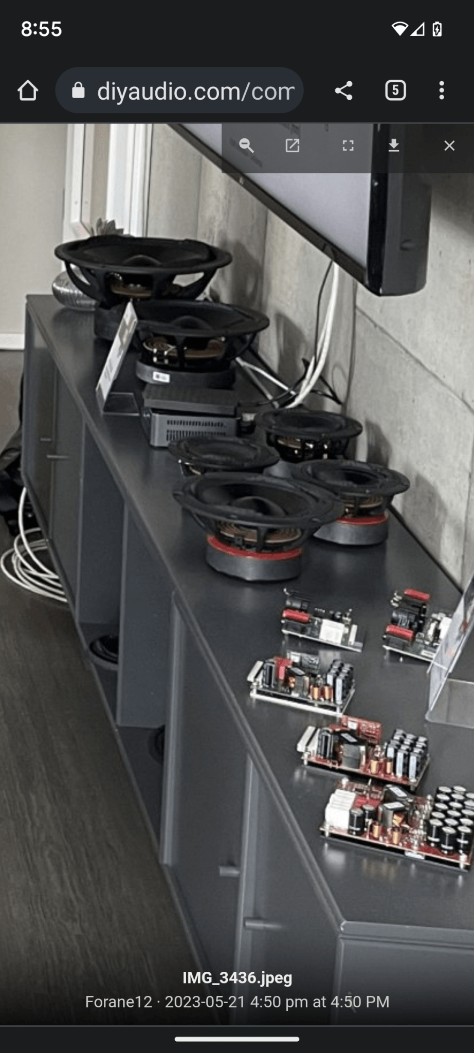

I was fortunate to hear the SPK16 at the Time House gathering and hear Bruno briefly explain the research Purifi conducted. Stunning small speakers but even more amazing were the SPK16. Amazing like there was no speaker at all but an orchestra in the room even though I was not in the sweet spot. Driven by the new 1ET9040 modules and a Mola Mola Makua/Tambaqui I was wondering how I arrived there enjoying it so much when I used to be a SE/Fulrange crusader…

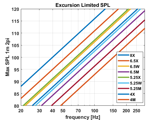

I’d really like to know the dynamic range, power handling and max SPL (unless I just missed it). I love all of these designs I just have a difficult time conceiving of how I could power most of them.
Several posts back a graph was posted showing the -technical- max spl of given size purifi drivers. Should give you an indication. Just calc the needed amplifier power and you have it.
Edit: could not find the post, but could find the image in my downloads, so here it is.

Interesting. Found it, thanks! I am consistently impressed by that 8" and can't wait to see what the 10" will do. Question still stands, how much power does that take? And I shudder to think of the expense to reach 20hz with purifi drivers and amps. I know it's actual endgame, but still. It was nice looking at Revels and acknowledging that they were $80 SB Acoustics drivers treated perfectly. Now I know there's actually something better without snakeoil makes my stomach turn in an impoverished, inadequate way.
