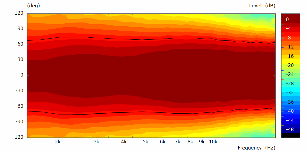

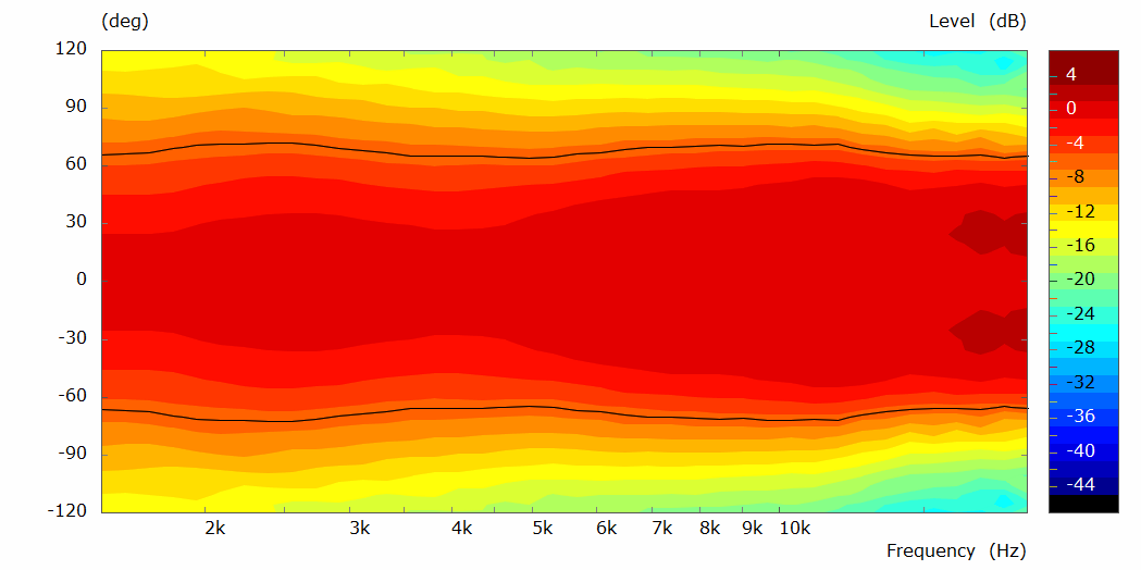

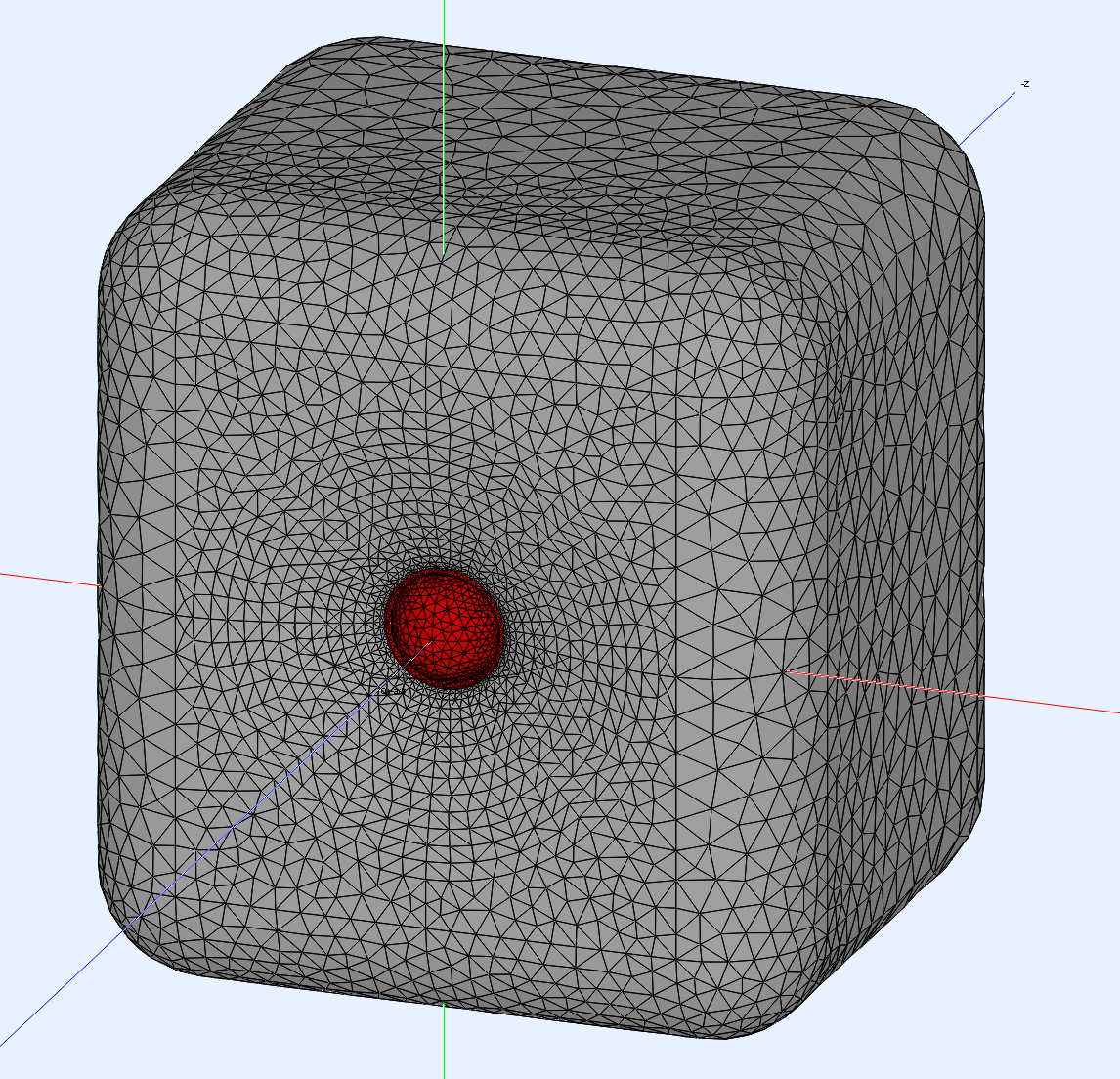

ATH DOME Profile 70 degree coverage 16mm Deep, where did I read about a 70 degree waveguide 16mm deep...
147mm wide Axisymmetric
https://www.diyaudio.com/community/...-design-the-easy-way-ath4.338806/post-7351271
Normalized to 10 degrees looks better
