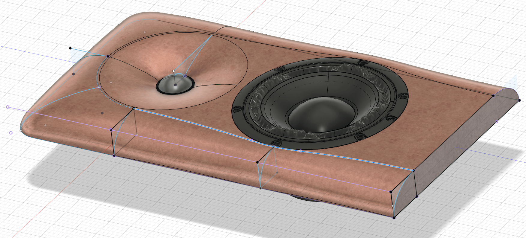

Updated baffle concept with waveguide, I think I like this one better
Very nice Duncan !
Wondering which dome you modelized ? one guess : Bliesma T34A ? another SB Acoustic SB26 ADC ?
Thanks, I had to try quite a few materials and lighting options to find something that worked. This baffle is more 'slippery' than than the other one. There is quite a few profiles that form it.I appreciate the color/texture you used for rendering the image. It visually has a lot of contrast which clearly illustrates the shape.
Thanks, T34A, I'm trying to concentrate on designs for the drivers I already have 🙂Very nice Duncan !
This waveguide is too wide to work ideally with your M74B without putting a similar waveguide on it. The T34B works better in narrower ones that would fit better but be bigger than what you had before.
I have been thinking about 3D printing a shell to fill with resin but I doubt it will be gold 😉. If I buy a fast printer maybe I will try.Just remember to 3D print it in gold for a cool 1M a baffle @fluid
I know that I can't use it with the M74B but I'm thinking to a future (next year) project with the Purifi 8" and a T34 A or B waveguided ! The Fc would be around 1250 to 1500 Hz
Get you a Bambu labs printer. Every maker needs one in their garage! I've printed like 20kg of front baffle / waveguide parts and it's never needed any tuning / changes. Stupid fast, too.Thanks, I had to try quite a few materials and lighting options to find something that worked. This baffle is more 'slippery' than than the other one. There is quite a few profiles that form it.
... What is your plan for fabrication? Outsource to a CNC shop and have it carved out of MDF?I have been thinking about 3D printing a shell to fill with resin
T34A needs to be really wide to work well in a waveguide and then making that go low gets big. The box does help quite a bit but the directivity can get less even quickly. The T34B can't get as wide in the top octave from the dome shape, but that makes it easier to maintain the directivity lower in a narrower waveguide. I've got a freespace simulation of mabat's Tritonia for the SB26 tweeter when I was considering a similar idea, that is solid down to 1K but the directivity is more smoothly narrowing with increasing frequency. Bliesma drivers can be wide without wavefront modification, SB's cannot so it depends on which directivity shape you want to target.I know that I can't use it with the M74B but I'm thinking to a future (next year) project with the Purifi 8" and a T34 A or B waveguided ! The Fc would be around 1250 to 1500 Hz
I probably will get an X1 Carbon with AMS because I do not need another project, but something in me feels like there is something wrong with that 🙂Get you a Bambu labs printer. Every maker needs one in their garage! I've printed like 20kg of front baffle / waveguide parts and it's never needed any tuning / changes. Stupid fast, too.
It would be quicker to outsource it but my own CNC machine might get jealous 🙂 Either CNC MDF or 3D printed outer layer filled with resin. Unfortunately there is too much real life stuff to make either likely to happen very soon. Rendering and simulation is easier to fit in with the spare time I have.... What is your plan for fabrication? Outsource to a CNC shop and have it carved out of MDF?

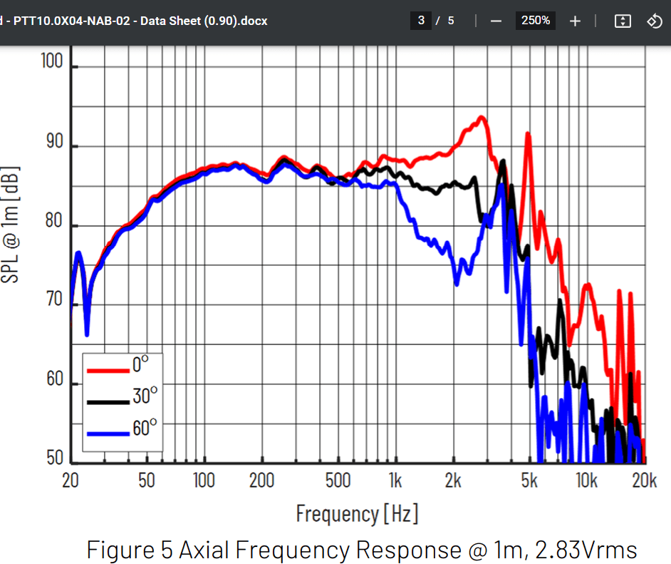

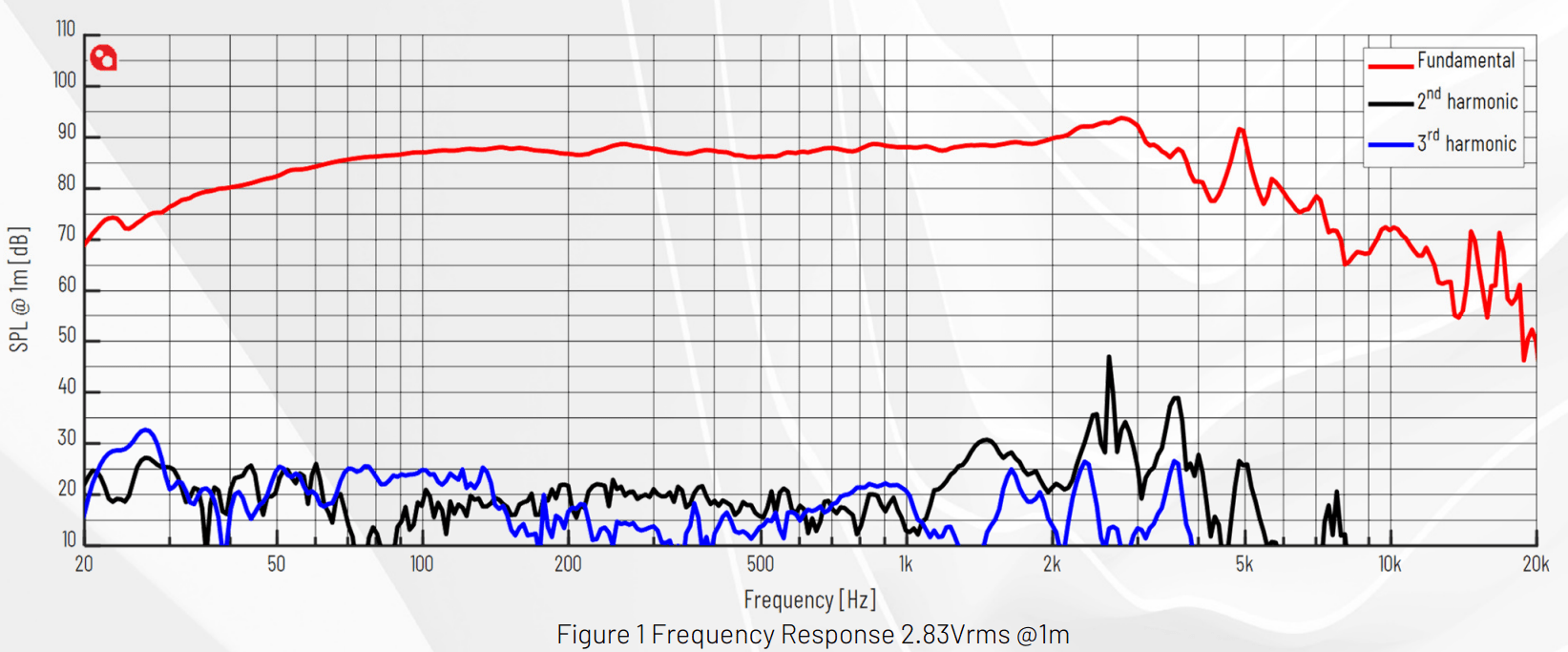

Here's a screenshot for datasheet on the 10" woofer:
Zoomed in:
I think we all appreciate manufacturers releasing FRD and impedance data for direct download:
https://ptt.purifi-audio.com/shop/p...,6022,6023,6024,6025,6026,6027,6028,6029,6030

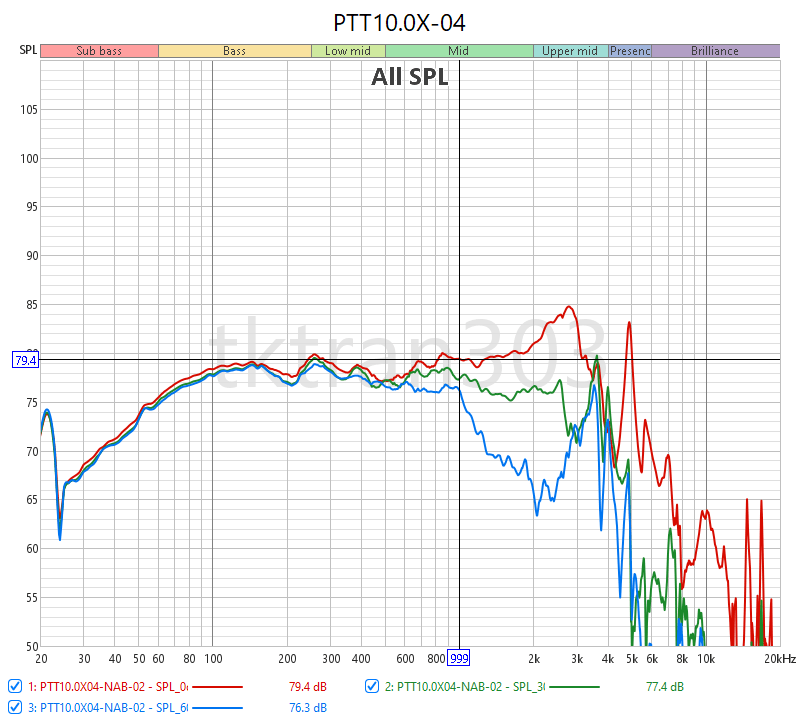

When I imported into a viewer- here's what is shown:
The sensitivity for the Frequency Response Data for the PTT10.0X04 zip file for download on the website seems too low:
This difference also exists for the PTT8.0X datasheet. (not shown)
For people unable to take their own measurements, this may be a little confusing. Can you please advise?
