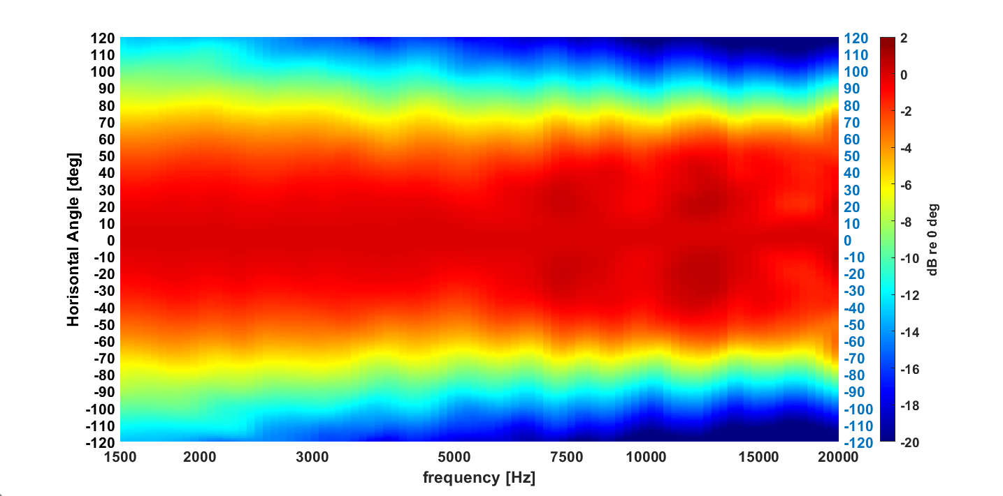

Looks amazing when ingeneers uses knowledge in combination with tools. Just wondering if the crossover and correction could be done with a dsp ? . Always thougt that dsp with mic meters away from a speaker is wrong, you cant correct anything after the fact ?.

But is the dispersion in the top end created by intentionally adding diffraction around the tweeter, similar to older constant-directivity horns?
Here is an appetizer of the new tweeter with ultra wide controlled dispersion. in-box measurement at 1m (gated). Will demo next week at the High End Show in Munich. See our FB/LinkedIn for more details. Our web is also updated to a brand new version in the coming days. There will be a white paper about the new demo boxView attachment 1172586
thanks! EQ of on axis response and xovers can of course be done with a DSP or as an active line level filter. However, the dispersion of each driver cannot be changed by EQ. Only if you have an array of drivers with individual shaping for each driver. This can do active beam formingLooks amazing when ingeneers uses knowledge in combination with tools. Just wondering if the crossover and correction could be done with a dsp ? . Always thougt that dsp with mic meters away from a speaker is wrong, you cant correct anything after the fact ?.
Thank you for your answer. That was what I ment with , you can not change things in a speaker after it has happend, so you can not simulate a waveguide in a dsp. And why should you when it looks like you have made it near perfect. What it looks like is, you can measure what happens in the boks and correct the speaker with no time delay ?. Could be fun if you could make dsp (sub)woofer correction with a tweeter as a mic inside the boks, and not a normal mic outside 🙂thanks! EQ of on axis response and xovers can of course be done with a DSP or as an active line level filter. However, the dispersion of each driver cannot be changed by EQ. Only if you have an array of drivers with individual shaping for each driver. This can do active beam forming

What is the function of the small ring in front of the dome? It looks like something we usually see there to decrease high end dispersion.

What made you settle on ~75 degree as the beam width? Is it it preferable to 80, 60, or 45 (x)? Or is that how it fell into place after the optimization process?
My room is 6.4m L x 4.8m W with asymmetric cathedral ceilings (2.4-3.2m). We know controlled directivity allows for consistent tonal balance in horizontal axis, but wider dispersion is better for larger rooms I think, in terms of a sense of spaciousness.
But I have no empirical evidence for this (yet)

The paper notes "Tweeter and waveguides are typically optimised for on axis and polar responses in infinite baffle (2pi). However, the responses when measure in a box in free field (4pi) will be much different due to the finite sized box. For this reference design we have chosen to optimise the tweeter waveguide to match not only the specific tweeter but also the specific box to be used". By specific box it is meant the external dimensions and edge rounding radius, or is the internal volume somehow being considered as well? I imagine it's the former, but you have gone so far that I could be easily missing something else.

yes, its the external box shape that matters for the diffraction. the internal shape matters for the acoustic modes inside the box but that is a different story 🙂

very good questions. To me the super side disperions simply sounds more spacious and with more air. The soundstage is in 3D. I do not hear it as brighter as some would suspect. It depends on the recording of course and how it was mixed (I prefer straight AB stereo recordings without further processing or mixing). As for why it ended at 70 deg: I asked the optimiser for wide and smooth but also to be be able cross to the woofer seamlessly.I haven't had a chance to look at the white paper.
