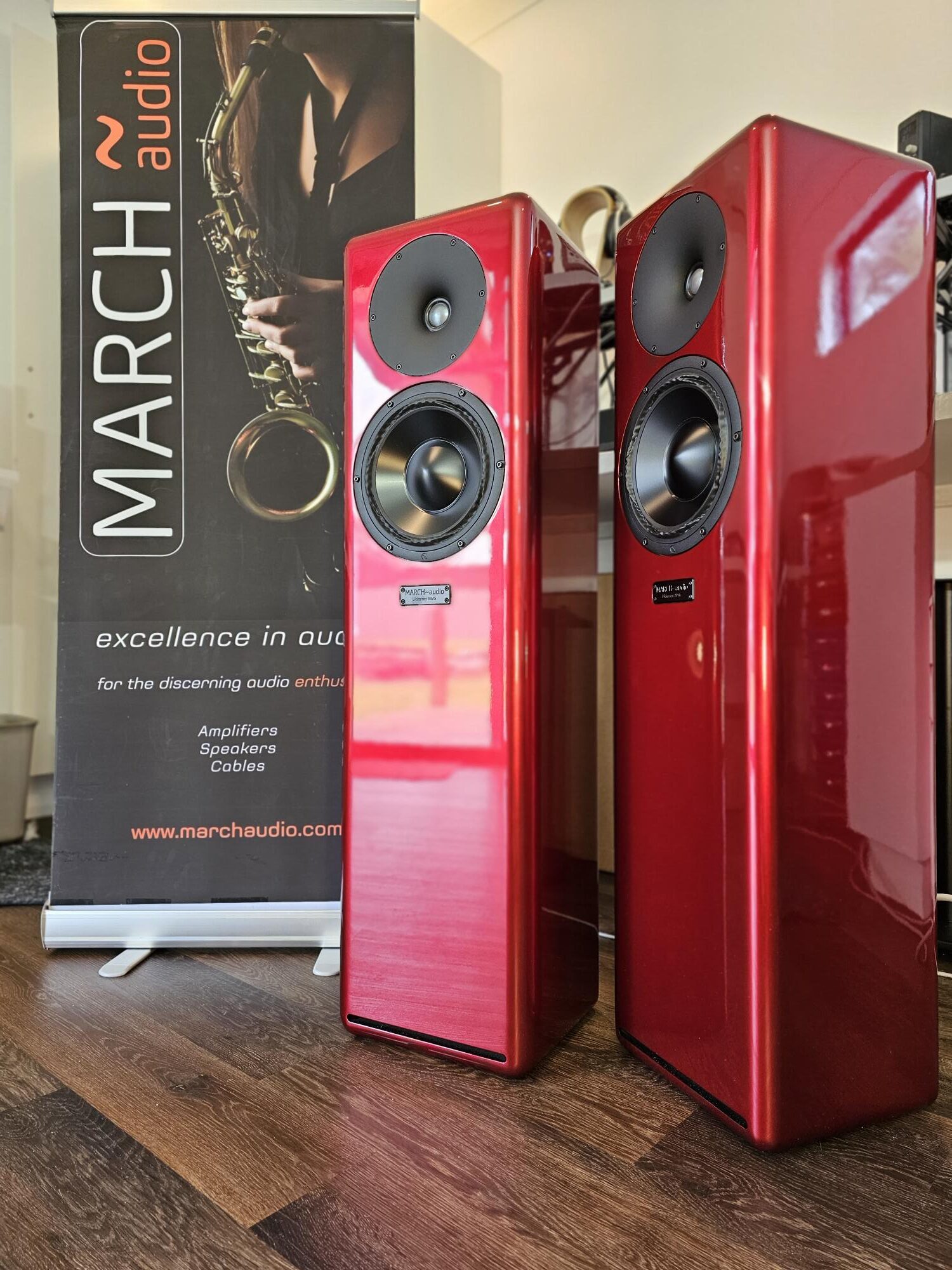

Alan March premiered a PTT8.0X0 design, albeit with SB Acoustics' SBTW29BNGW at the recent Australian Hi-FI Show held in Sydney

first time I read that the reason for the good sound is blamed on the room...Alan March premiered a PTT8.0X0 design, albeit with SB Acoustics' SBTW29BNGW at the recent Australian Hi-FI Show held in Sydney

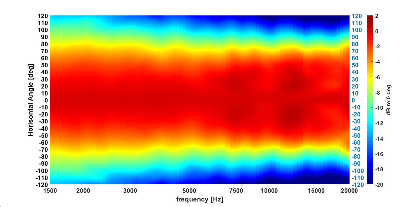

Here is an appetizer of the new tweeter with ultra wide controlled dispersion. in-box measurement at 1m (gated). Will demo next week at the High End Show in Munich. See our FB/LinkedIn for more details. Our web is also updated to a brand new version in the coming days. There will be a white paper about the new demo box

yes it is also crazy. the answer is FEA driven shape optimisation of the waveguide with a ‘coherer’ (shape optimised objects that shapes the wavefront around the throat). We have a white paper coming online when the new web is updated on the DNS servershow is this wide dispersion possible that high in freq with a 1.3" driver?
