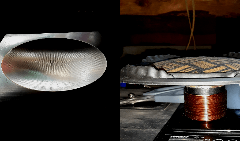

I'm gonna do a lil 'in before' so I can say I made a Textreme PTT. It's a structural dome rather than the standard dust cap of the PTT; the mild curve allows for concave or convex placement without being difficult to implement. Currently, I don't plan to do further work with this (build it out, test it, etc.) because at a certain point it gets more entertaining to do your own thing rather than work within an existing geometric set. In other words, I'd rather be working with my own designs, motors, VC, cones, etc.
Brilliant work @Haze Head . But please don't give @lrisbo any new ideas. The PTT drivers are plenty expensive already...
