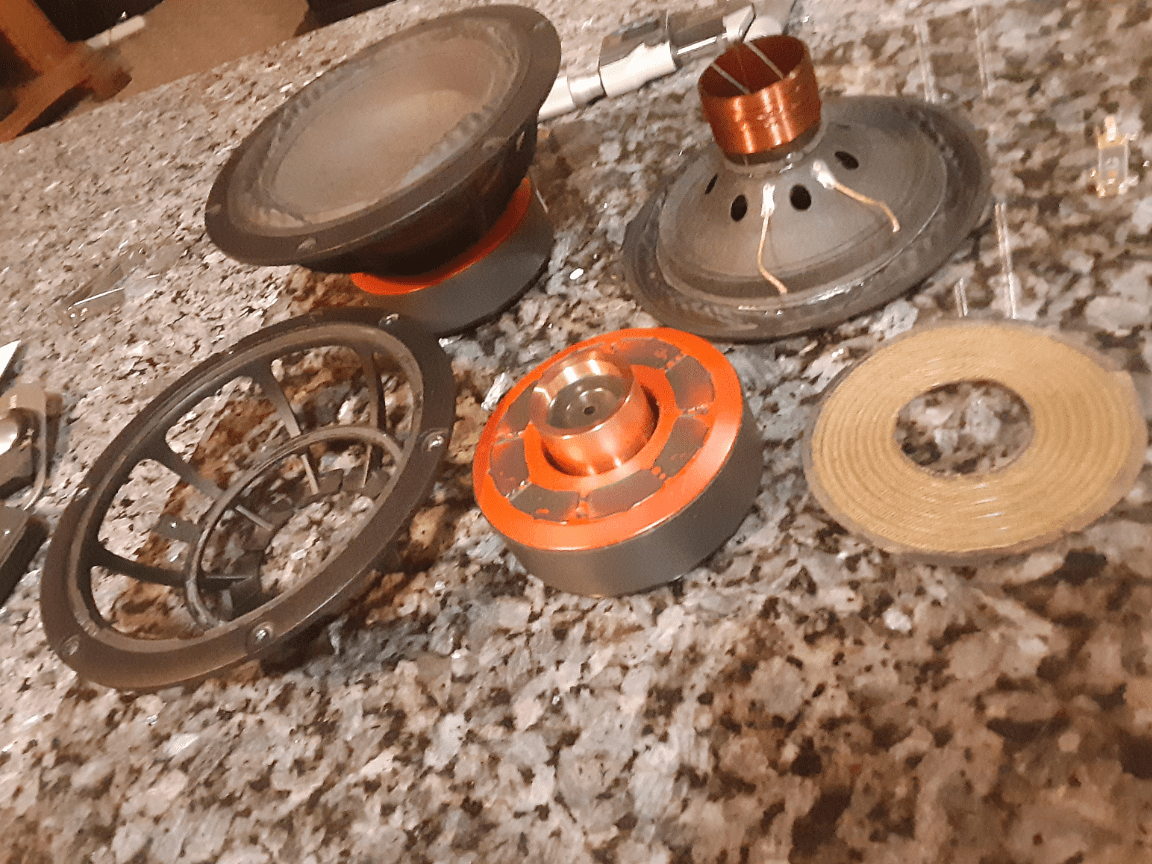

A smashed fiber cap (read, smashed beyond repair), is fairly easy to remove. Don't use a heat gun. What ended up working much better was to cut slits in the center and gently peel away from the glue line. The cap is not structural, at least not like the cone, which is much thicker material. Because of the difference in thickness the cap tends to give way leaving the cone unaltered. Now what you do beyond that point is up in the air. Maybe there are similar geometries to be had at repair shops. At any rate you can probably remove and replace a garbage cap for next to no money.

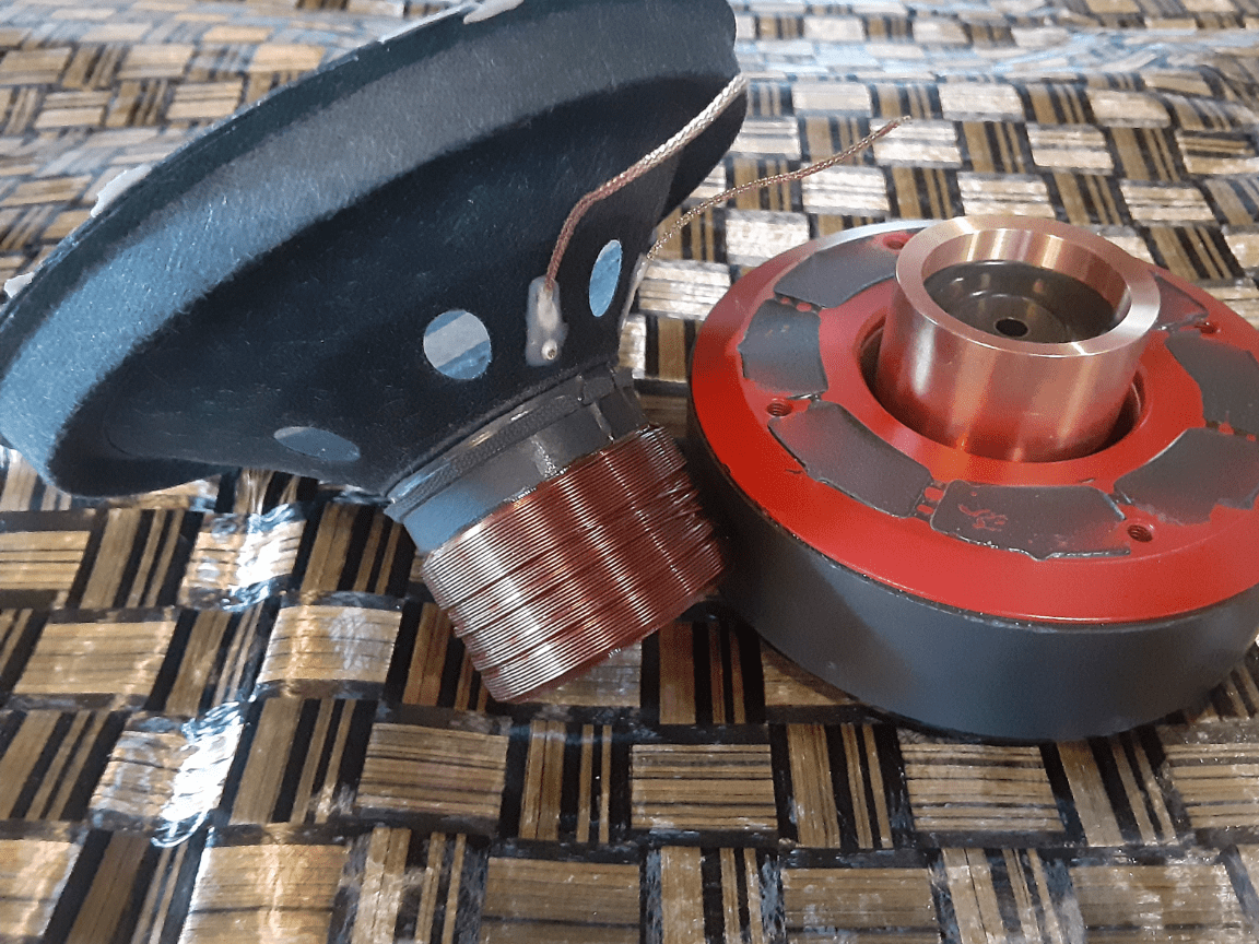

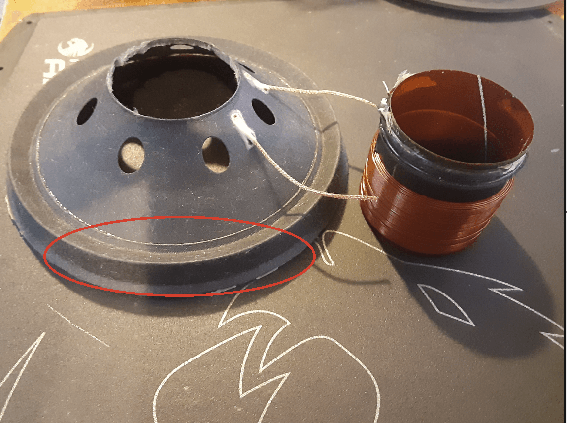

So I mustered up the courage to inspect the damage closer, and attempt some sort of repair on my driver today. I was hoping it would just be a cosmetic dust cap repair.
It is with a heavy heart I inform you gentlemen, the driver is no longer with us.
Upon closer inspection it was apparent the amplifier had pumped so much power into it that the excursion has maxed out the surround travel, and bent one side of the edge of the cone back toward the inside (magnet side). The cone no longer travels linearly, and the VC starts to rub with any more than about 50w into it.

@mainframe99 --not so fast! Nothing on that kit is off limits to repair. I have my 6.5 completely stripped to parade-rest. All it took was a pointy object, a small flat screwdriver and my fingers. I will be doing some heavy modding to mine, including different cone geometries/materials and totally different spider design. I'll offer to hook yours up too, in exchange that you do the A/B testing to figure out what sounds good and what does not. All you really want in top shape is the motor and the VC winding. Everything else is just stuff glued to other stuff, i.e. you can work on it.

On my driver this part has torn as the edge of the cone has been pulled and pushed.
I think it had about 600~1200W going through it for about 4 -5 seconds. The part of the track playing was brutal low end EDM synths. It is clear the cone and coil tried free willy the fu** out of the motor. The speaker was about 2m from me when it happened, I thought a bomb had gone off. After I finally switched it off there were dogs barking and car alarms going off. /jk

unfortunately, thanks to the elimination of Force Factor Modulation in the Purifi motor the BL keeps constant even at huge positive current (what causes the outwards push). a conventional motor has a negative current squared force term that limits the force or actually turns the force negative at very high current

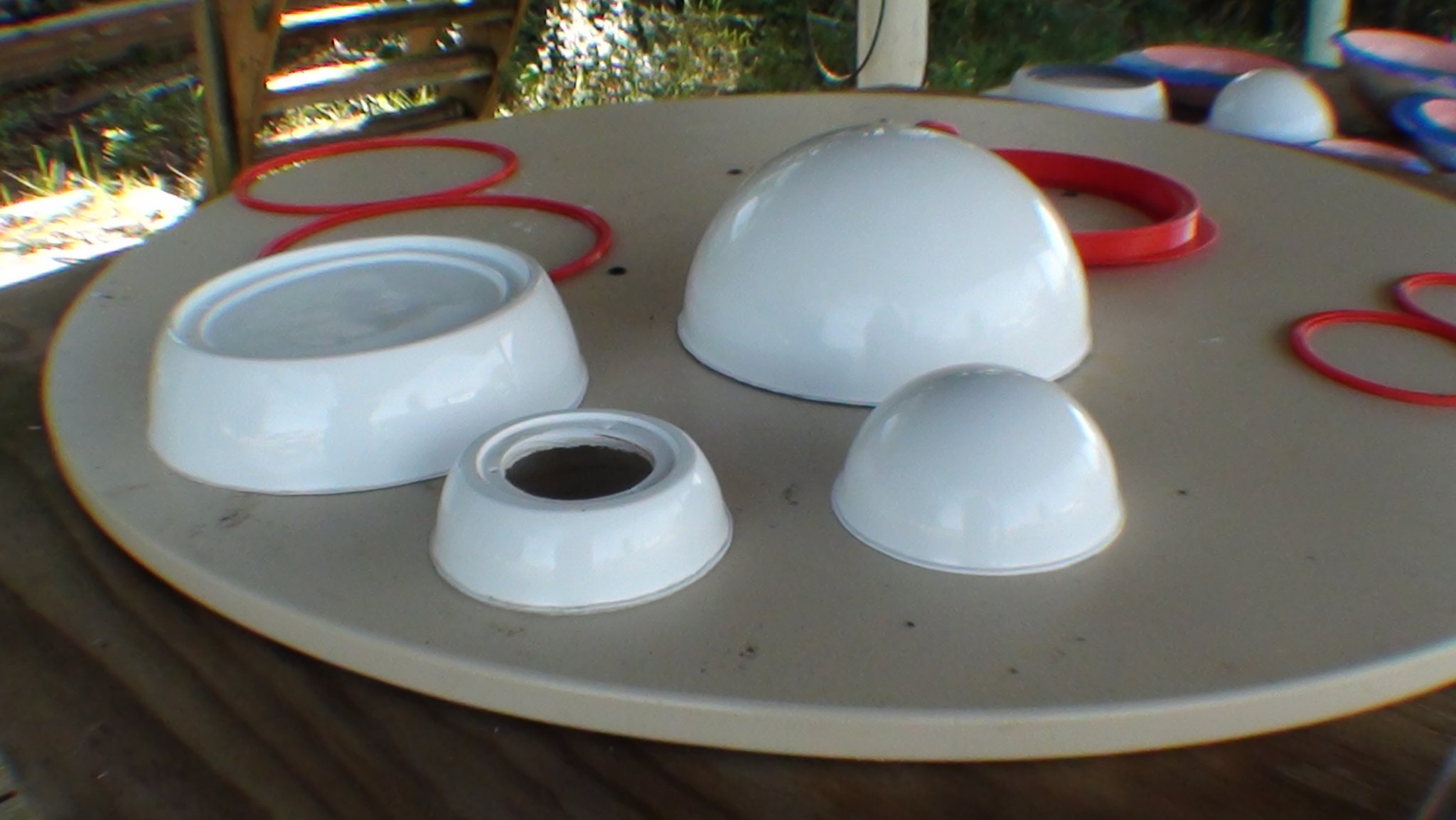

Absolutely beautiful woodworking! I love all the custom router jigs you made to create the spheres. The structure inside the big sphere for absorbing reflected sound is really interesting. Did you add it after trying the sphere without it, or was it part of the original plan?
