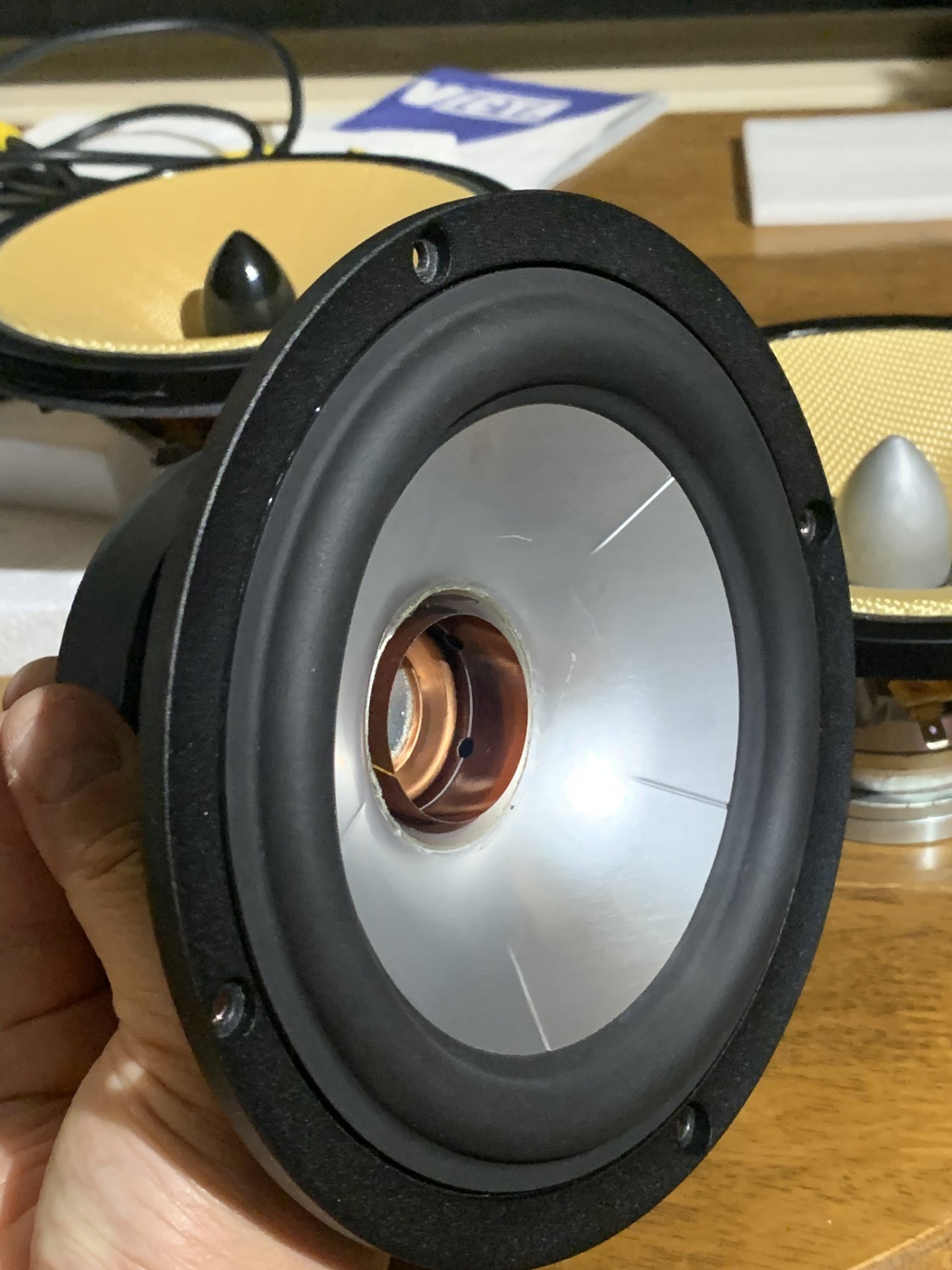

People have mention the bliesma beryllium tweeters in a 8” waveguideIt is a very very promising combination. There are a few areas of concerns and compromises to be aware of.
You will need to cross the 2 at 1.2-1.5kHz. It is a compromise as the TW29BNWG distortion starts to rise pretty quickly below 1.6kHz or so. And on the other end, the PTT8 gets directional after 1kHz. Even then, you will find the PTT8 beats the TW29BNWG in distortion at the crossover point. The PTT8 is that good.
Your bass alignment will need some thoughts. Ported PTT8 works. A small-ish box around 30L will get down to 33Hz or so. You will have a very long port for that though, more than 1 foot in length even with 3". Purifi demo box has some trickery to minimize the issue that arises with such long ports.
As for passive radiator, which is the popular solution for the PTT6.5, I don't recall seeing anyone tried it with the PTT8 yet.
As the 3rd option, if you choose to do closed box, it will cut off around 50-55Hz. Perfect to transition to sub-woofer in a non-directional crossover frequency.
I have personally tried very close to that combination. TW29BNWG + Dual PTT8 ported. Dual coz I wanted to make sure it will have enough omph plus it cuts the port length in half. There are other issues to deal wish such a center-to-center distance between the TW29BNWG and the 2 PTT8. But honestly it sounds pretty good but obviously not technically perfect.
Both TW29BNWG and PTT8 have fairly flat response, so there won't be much correction needed so designing the crossover passive or active will be a breeze.

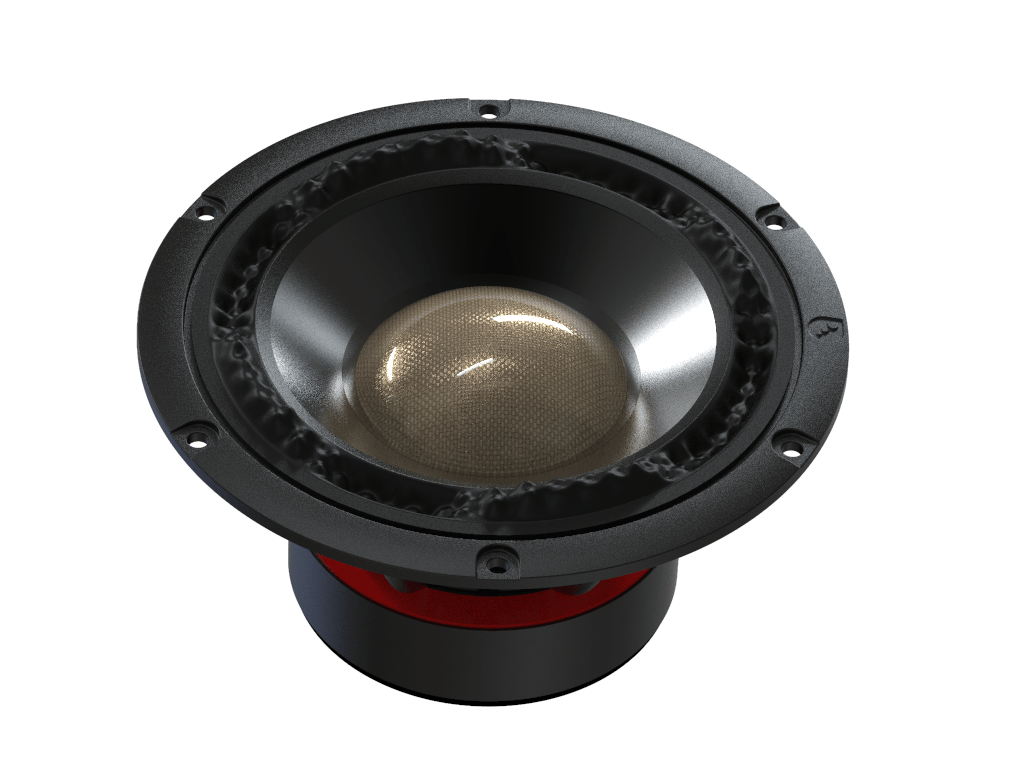

I have 4 x PTT6.5X that I wanted to use as midwoofers. But since I want to have closed boxes to avoid phase issues with my subwoofers, they seem to not like closed boxes. Some say they should only need 5-6 liters to work in a closed box - but then all the distortion advantage also goes out the window becasue of the much higher internal air pressure. So I looked into using them as midrange - maybe as MTM around a 6" waveguide, either with the SB26ADC I already have or maybe upgrade to Bliesma T25B to better match sensitivity and maybe sound quality.Has anyone tried the PTT6.5M midrange? I am building a 3 way and deciding between using the PTT6.5X that I already have as midrange, or should I get a PTT6.5M at extra cost. SPL wise, it is borderline. Depending on the passive crossover design it doesn't have a lot of SPL headroom matching with PTT8 woofer.
MTM constructions can be tricky though. So that's why I looked at the M-version. But it breaks up severely at 3kHz. And I can't really see the idea of having a passive network between my active system and the driver, to try and dampen the breakup, when other drivers can push the breakup to 5-7kHz - even the alu-version does that easily. And IMD does not seem to be any issue when using it as pure midrange.
I have only two saying anything about the Purifi M-version - that I could find. One said that there was nothing else to say, then that it was clean, low distortion and easy to work with. The other said that it was boring, closed and missing dynamics - he loved the PTT8 though.
So little data to run on - other than raw data. And that's the tricky part, since we as DIY'ers might hope that we can squeeze something better out of it, than others - or at least something better than other drivers.
To really use the claimed strength of the Purifi M-version. I thought that maybe if I used the linear stroke of 3mm to push it to around 150Hz. Then I could imitate the design of the Snell tybe B minor - add a 12-15" woofer on the side to add some true punch. And this woofer would not need a high pass, making it easy to mate with multi-subs. Keeping the speaker narrow, seems to me, as a good way to make it "disappear" acoustically and also make it more elegant.
But I'm in doubt, whether I actually need maybe 2 x 8" minimum, from around 4-500Hz and down, to gain that punch-effect, that makes a speaker sound dynamic and powerful. Only having one 6,5" down to 150Hz seems like it would struggle. Not because it would distort.... but simply because it has too little surface area to make it sound realistic.

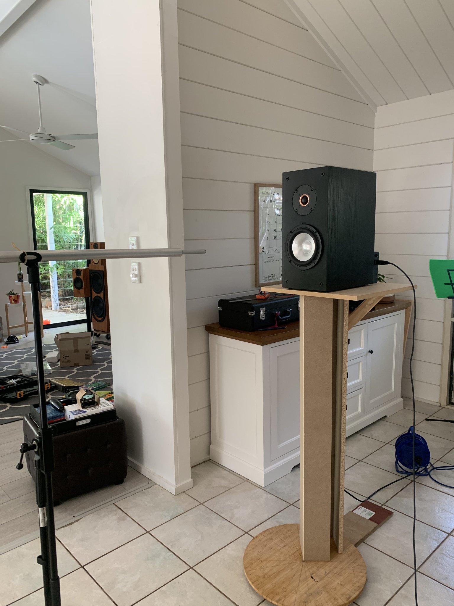

I played around with some of the ideas. I have PTT6.5X in a 7.5L closed box. The distortion is not bad. Relatively, looking at dBr It hugs around -60dB until starting to rise below 200Hz. Purely looking at SPL it follows the official distortion profile fairly closely, maybe 5dB higher sub-100Hz. Originally I tried something similar, which is to cross to a 4 sub arrays tuned with MSO. I tried 80Hz which is the lowest it will go but, despite all theoretical claims, I still find there is still directionality at 80Hz. Low frequency sounds more like home theater sub rather than stereo music. I believe it will need to go down to 50-60Hz which PTT6.5X in a sealed box won't go.
I also tried MTM with different tweeters (including TW29BNWG) and PTT6.5X in individual 7.5L boxes. I haven't been able to tuned it to sound as good as a single PTT6.5X. Lack of skills probably and it won't gain much other than SPL at lower frequencies, so I gave up on that idea.

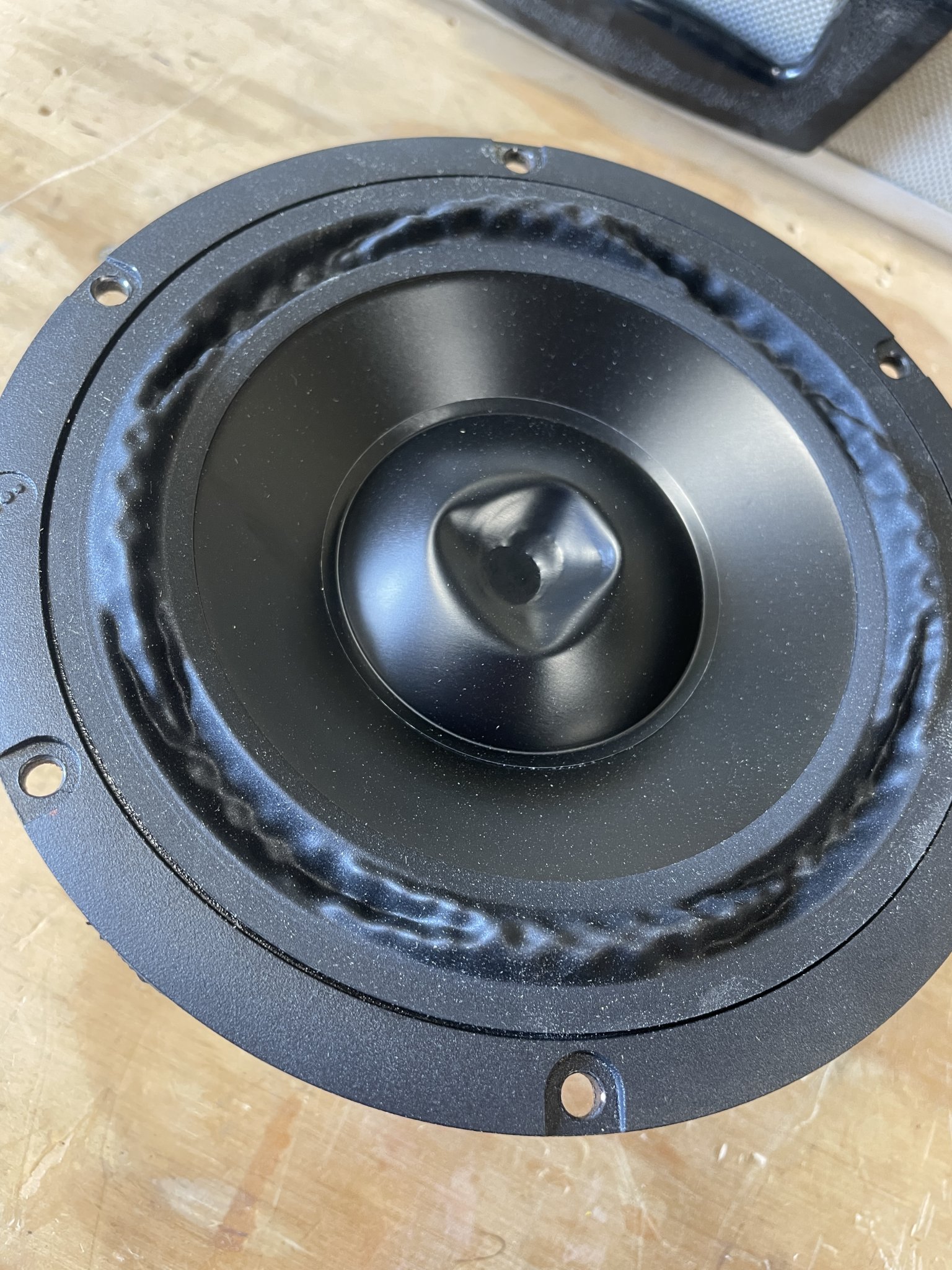

So I was taking a nearfield measurement and had the mic about 10mm from the cone. The measurement went smoooothly. Heres where I shouldve A. turned the amps off, or B. removed the mic. Right after the measurement I went to open VCAD to do the baffle step response to load onto the measurement, but no!, the VCAD logo is right next to the Firefox (web browser) logo in the stupid windows 11 Dock. I accidentally click firefox, it fires open so fast, goes straight to the last webpage I was on which happened to be youtube and proceeds to immediately play the music video I was watching the previous day. As windows volume was at full and I was using volume control in REW for the measurements, the kick drum immediately proceeds to send the purifi into the mic with such force the mic stand fell over. If you look close, you can see the mics imprint in the dust cap 😢
RIP purifi cone. I have some paper cone versions to fit in place, to listen to while I sob.

@mainframe99 the driver's still good, I mean you didn't blow it right? If it's functional what about taking a latex mold off the good driver and making an epoxy replacement dust cap? Edit; assuming you cant pop the metal one back out without looking like a crushed beer can.
Is the dust cap just dented or is that a hole in it?
Removing metal dust caps is relatively straightforward. Just an application of gentle heat eg. Hairdryer (or butane powered heat blower) and gentle pry with a spudger (or scalpel) All hail @5th element

…Then when you go to do your next order from Purifi, ask for a replacement dustcap to travel in the post, then reattach…

We can send you a spare dustcap?
