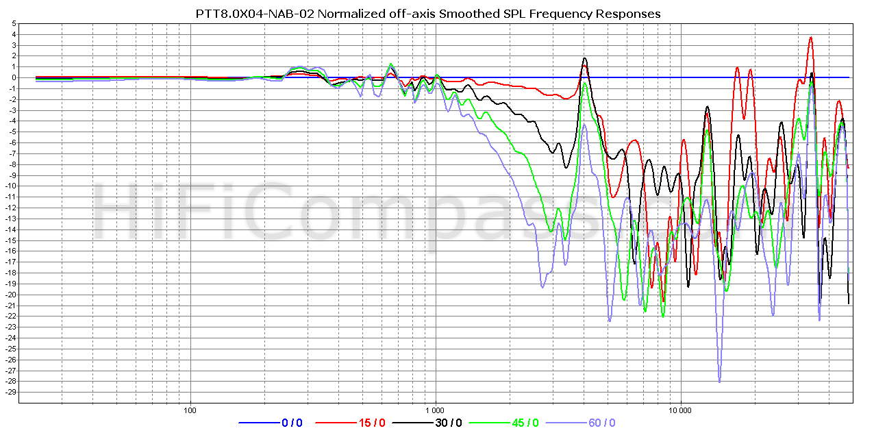

I meant how does the PTT8 sound in the 300 to 1300Hz range (approx) vs the PTT6.5 in the same range? My tweeter reaches to 1200Hz with low distortion and approx 80° dispersion so wondering if I would loose midrange quality if I crossed to a PTT8 instead of a 6.5.
Reactions: tigeranand
I take it you’ve seen @Yevgeniy’s review ?
https://www.diyaudio.com/community/threads/some-speaker-driver-measurements.317632/post-7237652
You can compare and contrast using the comparison feature at his website (registered user only) or open 2 tabs to compare and contrast.
Useful graph here-
Depending on your cabinet design, in-cabinet dispersion and tweeter’s in-cabinet dispersion a crossover from 1000-1800Hz looks like a reasonable start to play with; and depending on phase alignment at crossover region or other factors it might move up or down.
