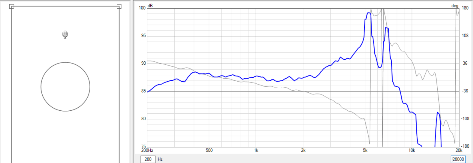

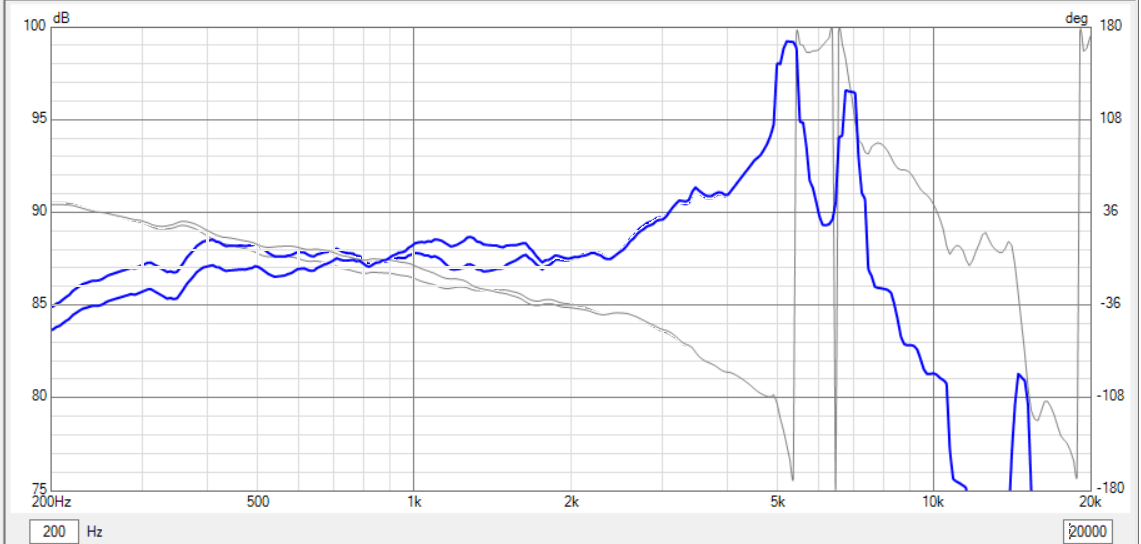

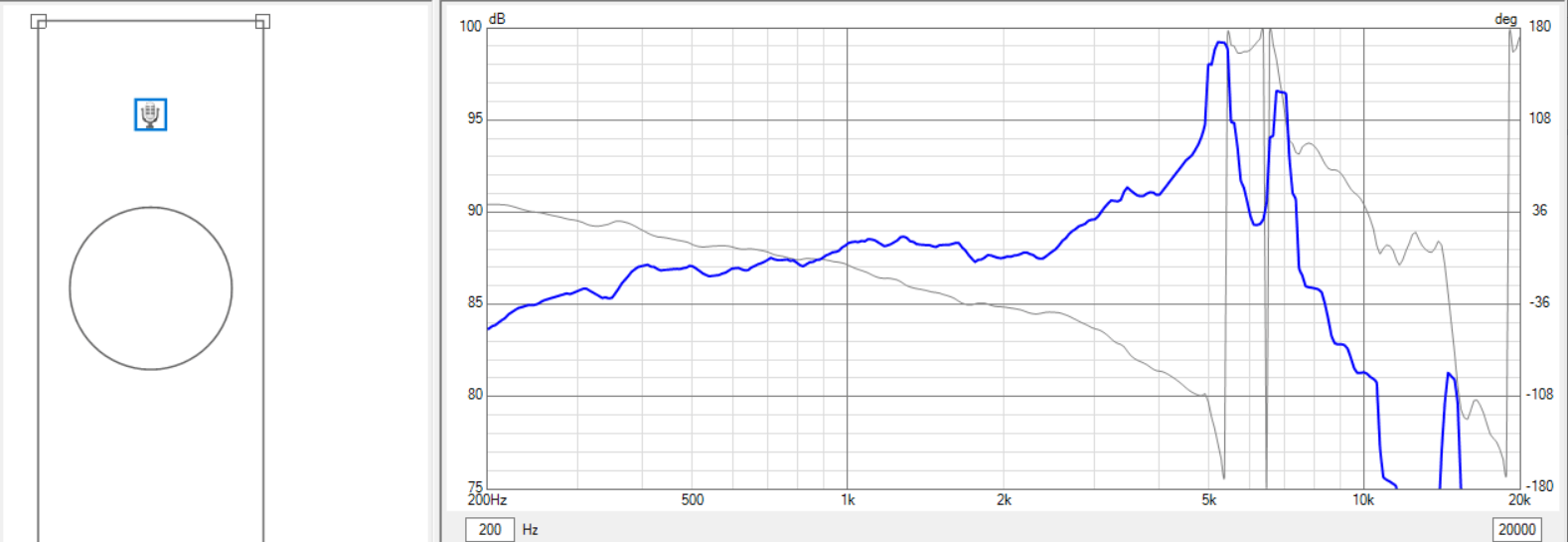

B) Baffle dimensions- A wider baffle like 350mm wide allows a buttery smooth response all the way out to 2KHz.
eg:
In a narrower baffle it looks something like this eg. 24cm wide:
Here's an overlay of the difference:
The narrower baffle results in a loss of about 1dB under about 600Hz, but a bump centred around 1.3Khz.
If you're doing a passive crossover; for the narrower cabinet that means
i) 1 dB sensitivity loss (passive crossovers are subtractive)
ii) having to deal with that 1dB bump around 1.3Khz with your crossover (more components)

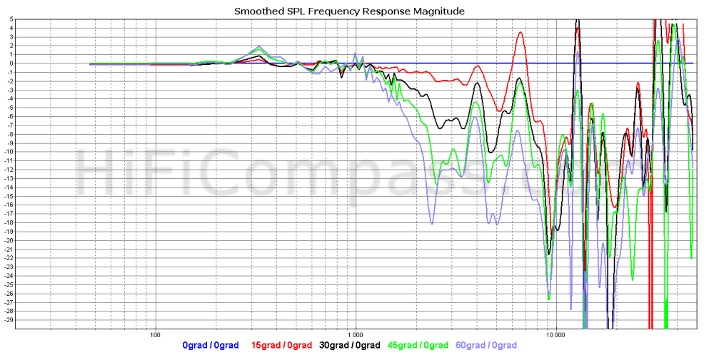

How did you calculate that beaming starts at 1k?
Speed of sound/diameter of cone equals 1988 hz
Or am I wrong?
Or am I wrong?
Dutch & Dutch C8 cross their 8" at 1150 Hz... So maybe something else is in play too 🤔How did you calculate that beaming starts at 1k?
Or am I wrong?
If you look at all the 8" drivers on hificompass.com and examine the normalized off-axis response, you can see this beaming. In nearly every 8 inch woofer, the 30-45-60 degree responses follow the 0-axis responce up to about 1k. They start to diverge from the 0-axis response somewhere between 1k and 1.2k. By 2k, the 45 degree response is 4-6 dB lower than the 0-axis response.How did you calculate that beaming starts at 1k?
This is a typical 8" driver normalized off-axis response. 15, 30, 45, 60 degrees.
... more thoughts... There is a guideline from the "pre-simulation era" that says that a driver starts to beam when Ka = 2.
For a driver with an Sd of 220 cm^2 (typical of an 8" woofer), Ka=2 corresponds to 1300 Hz.
So all of this broadly agrees with @tktran303 's statement about starting to beam at 1k.

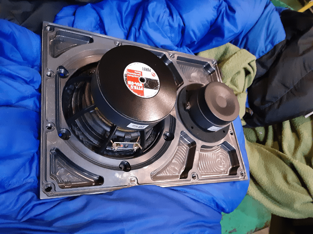

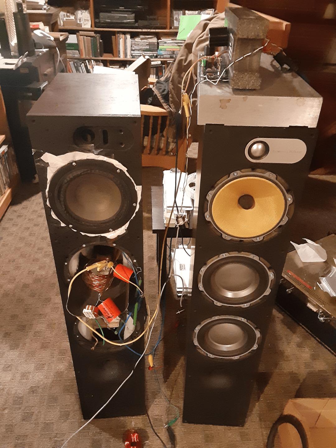

It's been two years since I purchased a set of PTTs. Only now have I finally fired one up and I'm doing a lil celebration. To get just the one driver going I spliced it into a BW cabinet I had lying around. The upper chamber is about 12L sealed but the tweeter hole is acting as a vent. To approximate the recommended crossover I had to roll a nasty air coil from some 12awg magnet wire and at some point I gave up on counting turns and went for big.
It's running on straight battery power through an M2. The BWs are bi-wire so I am running the PTT and the BW tweeter together. It's pure Frankenstein but I'm loving it already. Just the cobbled together hardware is giving a serious glimpse into the potential of this stuff and I can tell it's gonna be excellent in final form.
Seeing the PTT in the narrow BW cabinet has me leaning towards a narrow version of the aluminum baffle. The original baffle I made for it is 8" but that almost seems too bulky now. Can't wait to get all this gear into a final package!
