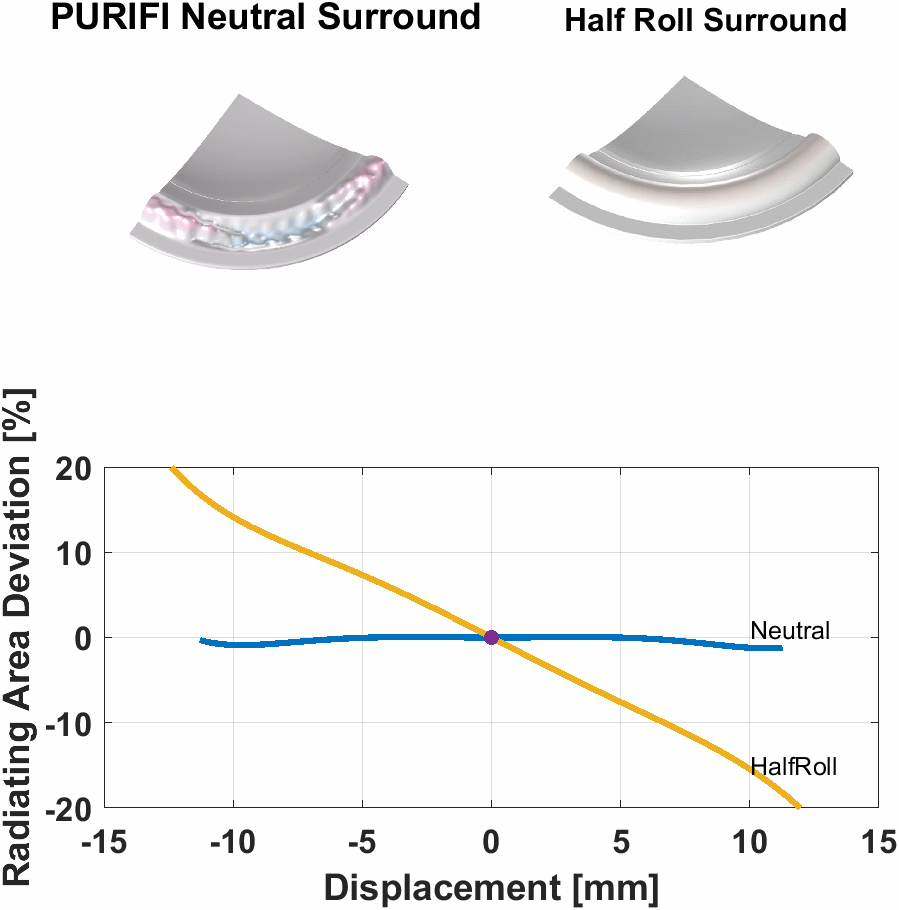

Here is an animation of Comsol simulations of a 5.25" driver with our strange surround and a std. half roll. The cone is reproducing a 1/4Hz sinusoidal motion with amplitude of 11mm. The graph shows the relative modulation of the total radiating surface area (aka Sd(x)). For example, 10% deviation causes a 10% change of the sound pressure (Being proportional to Sd) which manifest itself in 10% amplitude modulation of any higher frequency signal superimposed. In other words 10% IMD. The new surround keeps that modulation at a fraction of a percent.

So... as a midrange driver, where the p-p is maybe 1/10mm ( 3 way). It almost vanishes? But as a woofer/midrange combined (2 way) - it's a big deal?Here is an animation of Comsol simulations of a 5.25" driver with our strange surround and a std. half roll. The cone is reproducing a 1/4Hz sinusoidal motion with amplitude of 11mm. The graph shows the relative modulation of the total radiating surface area (aka Sd(x)). For example, 10% deviation causes a 10% change of the sound pressure (Being proportional to Sd) which manifest itself in 10% amplitude modulation of any higher frequency signal superimposed. In other words 10% IMD. The new surround keeps that modulation at a fraction of a percent.
Lars @ Purifi
Yea, @digitalthor, that's the premise. It's what gives it so much value in broad operating ranges. That way it can operate far lower than previously feasible at high SPL while still producing higher notes at no variation. Simplifies your directivity and crossover a lot. Just consider the expense of some three-way nets compared to the increased price of a purifi woofer. Using a Purifi woofer as two of the ways in a three way makes less value sense, but it's still quite good in theory. They are tonally similar and hold similar properties. Something like a TMWW would still greatly benefit from the low distortion at all ends of the spectrum. The proposition of value always looms large, however, and the surround does not appear to add much value in the mid as you suggest.
