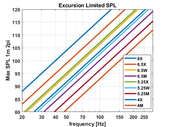

@ErnieM thanks for the response. I used this to get an idea of SPL based on xmax - would this give an accurate number? http://www.baudline.com/erik/bass/xmaxer.html - it says ~113 at 200hz for 8.5mm x 4" cone. I am not sure what this translates to at 1m but it's probably enough either way, I've not got a large room.
I guess I could always double up on the 4"ers... :p:p
Reactions: 1 user
Joined 2005
When using that calculator gives with PTT4.0X’s effective piston diameter of
8.5cm = 3.34”
Solving for SPL max @200Hz and 8.5mm excursion gives 111dB @1m
Here’s a good graph you may have missed:
Reference:
https://www.diyaudio.com/community/...ifi-woofer-speaker-builds.352063/post-7123950
You may notice the PTT4.0X here has a max SPL of 116dB.
Cross referencing with my own values, I believe that @lrisbo uses a slightly different method of calculation- the mechanical excursion (15mm) for this graph.
They are slightly higher but both methods get you into the ballpark figures.
I prefer to use VituicCAD2 to simulate the max SPL - using both linear excursion + thermal power handling limitations; and plots an amplitude vs frequency graph based on the lower of the lowest of the 2, but then conduct real world SPL testing outdoors, when weather permits.

Thanks @tktran303 - this is good confirmation and it's probably loud enough. With stereo and in-room I am sure I will rarely if ever want to touch the limits of this driver. FWIW I have read subjective reviews of PTT drivers where people hit xmech inadvertently because the driver sounds so clean even up to that limit, so I guess I'm willing to accept xmech as a genuinely relevant number here.
