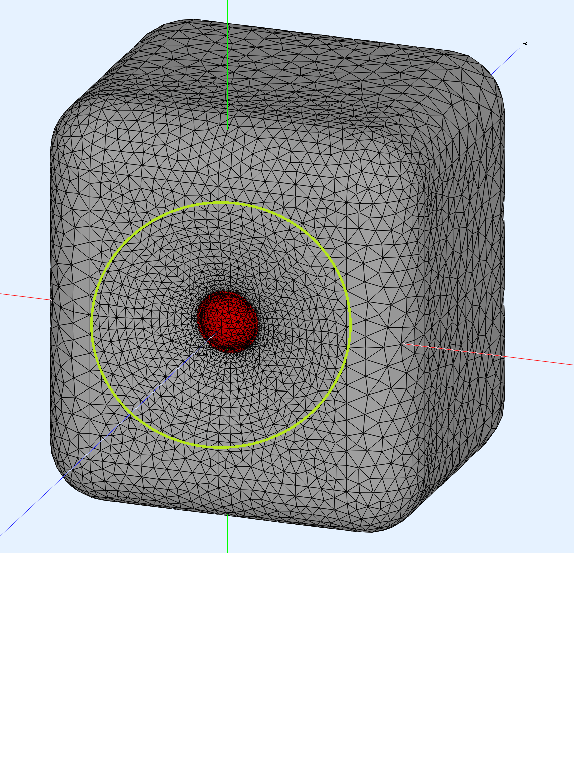

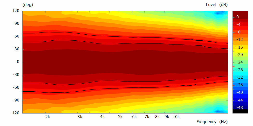

Really nice. Is it a waveguide+cabinet simulation ? Have you got a picture of it ?If 60 degrees is wide enough then some 1" drivers enter the picture. Probably counerintuitive to most people that bigger domes can be wider at high frequencies than smaller ones. Black lines represent 3dB and 6dB down.

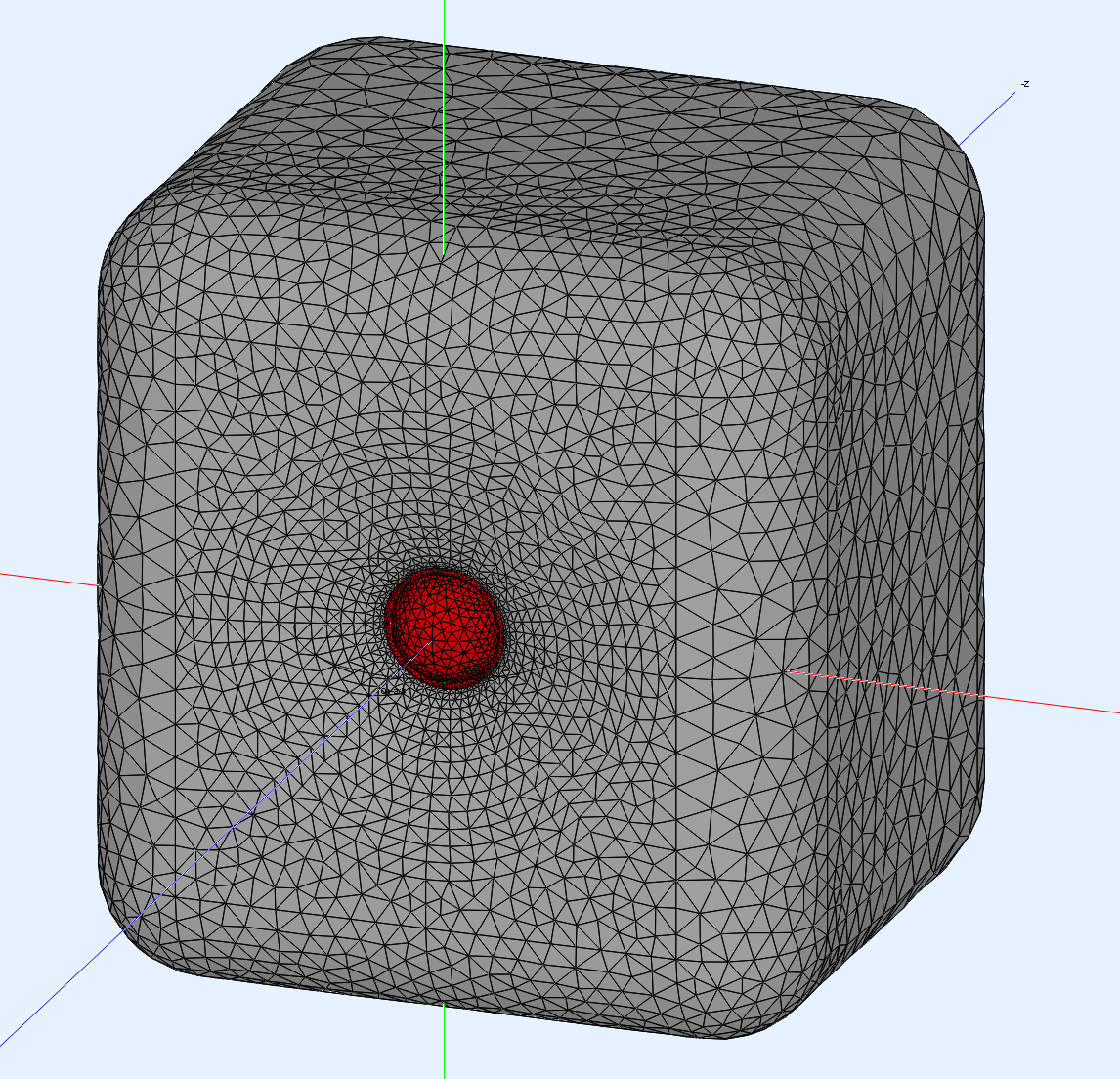

Are there any trends you saw, other than being shallow, in your optimisation study for your new tweeter that could be applied generally when hand designing? At the very least for CD in your design.there is nothing golden about tractrix or any other classic shape. The shape must be optimised in each case for the specific wavefront that the particular dome emits
as always, it’s difficult to generalise. but i optimised a similar diameter WH for a plain non rounded box. The result was a deeper WG but also more shallow dispersion. probably the deeper WG hides the box edges better at the cost of more narrow dispersion. So heavy rounding makes quite a difference.
for good tweeter performance, I would start with a smooth transition without any major obstacles or profile changes from the tweeter to the waveguide throat. Attention should be paid to minimise any discontinuity from the waveguide to the cabinet. The shape of the profile of the waveguide determines the dispersion.
