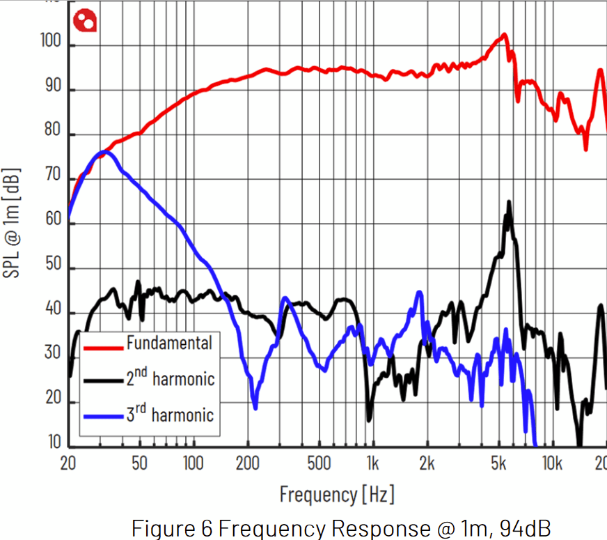

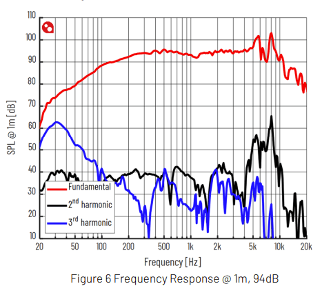

In terms of distortion, the PTT8.0 remains un-matched for typical mid-bass frequency range uses eg. 50Hz to 2KHz:

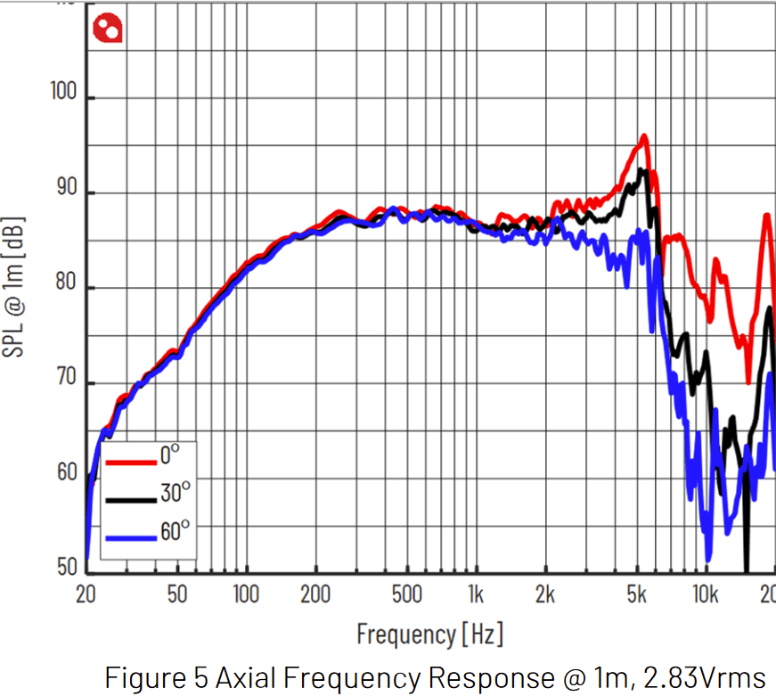

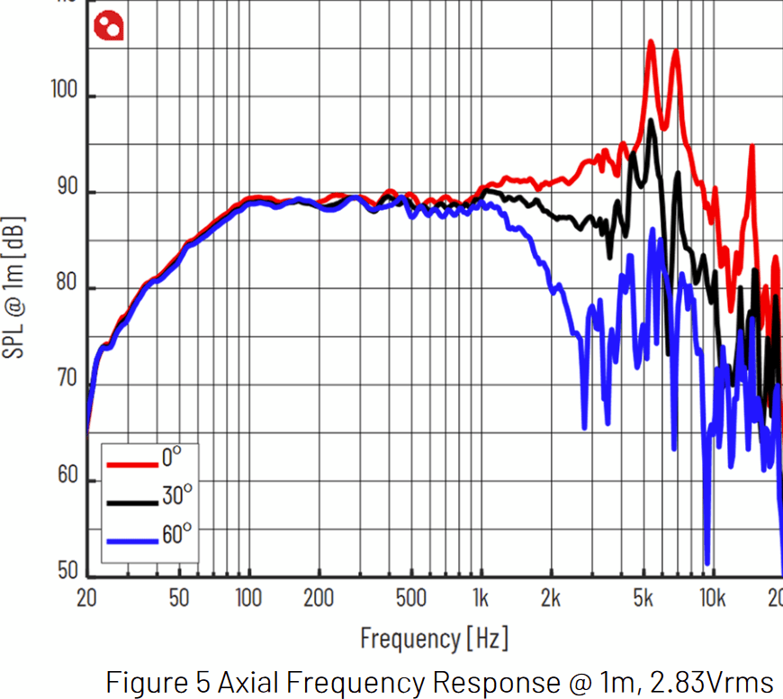

But in terms of wide dispersion, the PTT4.0 is unmatched above 1KHz.
Exhibit A: PTT8.0X04-NAB
Exhibit B: PTT4.0M04-NFC
click on thumbnail then Left and Right cursor keys to compare and contrast harmonic distortion and on and off axis frequency response.
Exhibit A harmonic distortion:
Exhibit B harmonic distortion:
Exhibit A: frequency response:
Exhibit B: frequency response:

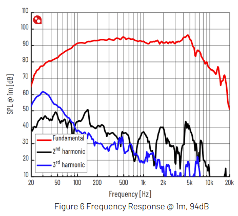

My thoughts are based on the data presented on hificompass.com. All versions of this driver have low enough distortion that I would not use distortion performance as a decision criteria. All are very high sensitivity and very high SPL capable. The paper and silk versions have resonances at around 6k. The typical upper crossover for this driver will be in the 3k -4k range, and a 6k resonance will be difficult to deal with. The aluminum version has its resonance at about 11k, and this will be significantly easier to work with.Apart from the price, why would you go for the M74-A rather than the M74-S?
j.
So, I'm not the only one who has observed a significant price increase for these. Unfortunate, that.Crazy if you know that you could buy them for 1300€ a pair just a couple weeks ago.
Part of the reason I like the PTT5.25X is the absence (reduction?) of a break-up related distortion peak. This peak appears to be much more pronounced in the OEM PTT5.25M:
I wonder why it's so less prominent in the PTT5.25X than, really, all the others?

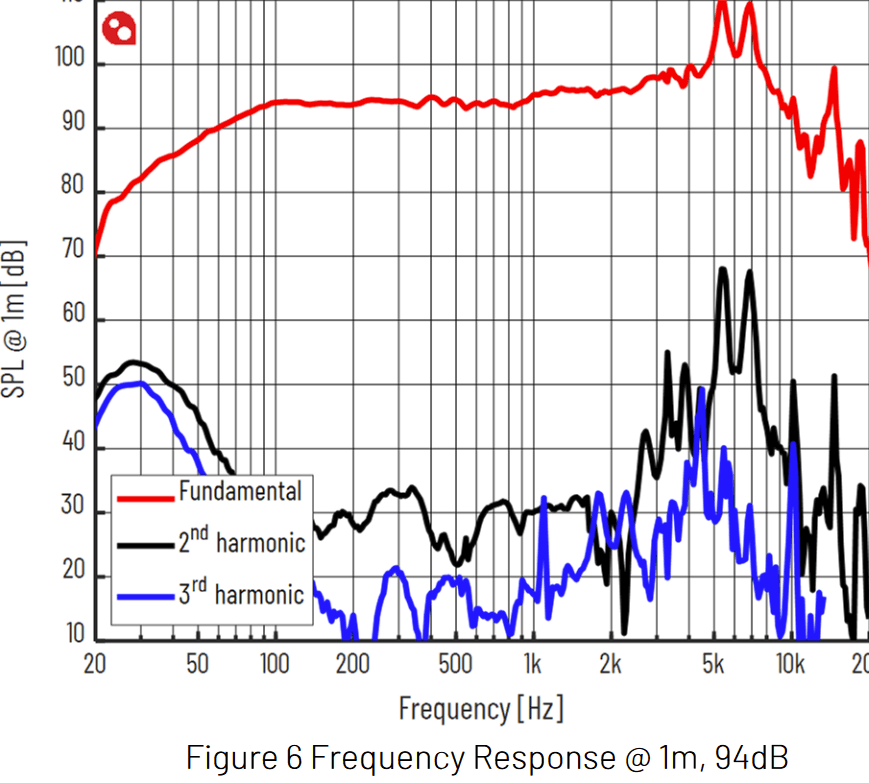

In simulations, the peaks behave the same way as the larger 8.0X, and the recommended passive circuit seems to work the same with a little adjustment. Funny that their peaks are so similar on such different sizes. Long ago when I designed a simple passive x-over for a 5.25X04-NFA based nearfield monitor, it practically snapped into place like their whitepaper.I wonder why it's so less prominent in the PTT5.25X than, really, all the others?
All peaks seem to be around the 5khz and 7khz region respectively, when they appear. Variations of the 4.0M NLC have their peak either slightly above or below 5khz, the aluminum pushes their peak above 7khz. The 10.0X is right on 5khz, and the 8.0X shows both 5 and 7khz. Some of the 6.5M's and 6.5W's seem to be trying to push that breakup higher and higher. Even my scaly lizard brain is telling me it has to do with the way they design something. If the style of circuit application in their whitepaper could be adapted to other drivers, why aren't they selling the circuit as an add-on?
