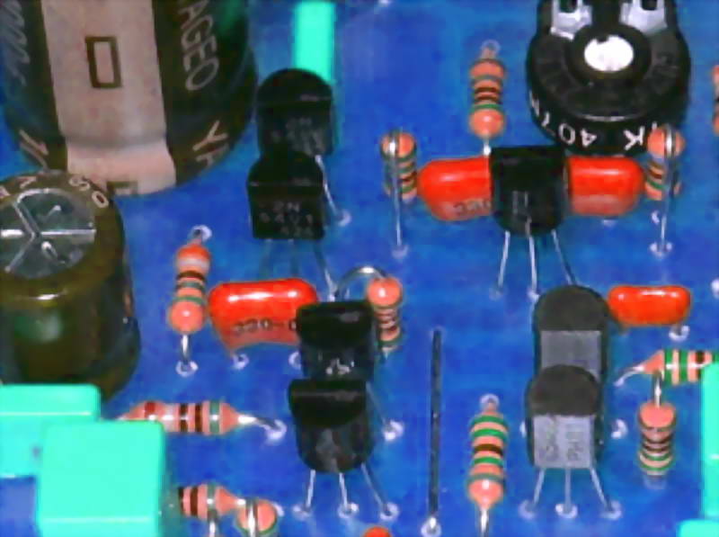

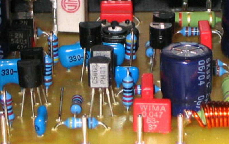

Explendid amplifier designed by Michael Bittner, our MikeB
Michael is preparing a voyage inside Symassym
With the full description of the circuit.... hows and why this or that...and the reason of this choice and not the other one.
Something not so common, people do not use to describe, entirelly, an amplifier.
But Michael had this idea, to offer one more aid to forum guys, not only to understand Symassym, but also to develop their own amplifiers, based on his researches.
This will not be done instantaneously.... maybe a couple of days or a little bit more, as he cannot enter in his space of time dedicated to sleep.
But he already told me his intention.... and Michael intention is a promiss (he promissed me to send one pc board...used one...yeah...junk!....)... this way i know very well that he is fast with his decision....ahahahaha!
Score is 4 x 1 dear Michael...hummm...hard to face the ones that have big mouth and time to spend!
regards,
Carlos

Hi Kanwar !
You can see some specs of the amp here:
http://www.diyaudio.com/forums/showthread.php?postid=684856#post684856
There is one typo, i wrote "TIM" instead of "IMD"...
DF for 1khz into 8ohms is ~1200. DF is heavily reduced by the outputcoil,
and so drops to 120 at 20khz.
before outputcoil it is 12000 at 1khz and 6000 at 20khz... (might be wrong)
I did not optimize for DF, but as i use plenty of feedback, the DF is quite high.
The fact that a such simple coil reduces DF that dramatically tells me
that there is not much left when the signal finally reaches the voicecoil
of the speaker ?
Carlos, principally the DF describes the amp's ability to control the
speaker, a too low DF results in unprecise and not tight bass.
Some people do like it, i don't...
Mike
