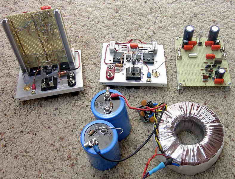

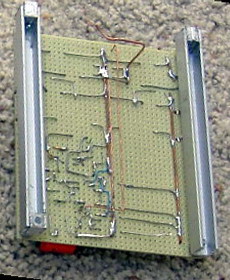

Hi Guys,
I should get transformers later this week. Maybe I'll have time for a listening session before early next week. If not, I'll have to wait a couple of weeks, as I'll be out of town for a while.
Carlos, I have good reason to be humble, as the following questions will demonstrate. I think Mike had recommended the silver mica, and there is an surplus electronics store near me that has these caps cheap ($0.25ea), and various polystyrene too.
Meanwhile, a couple of grounding questions. I have all the grounds on a single 1.2mm wire as a bus. From one end to the other it goes like this; input ground, feedback ground, ccs ground, 2n5401 base ground, vas ground, rail bypass grounds, speaker common and zobel. Pretty much like the schematic from left to right, except that all the rail bypass caps are grounded near the right end.
I can easily cut this bus wire into two or more segments and use connecting wires to bring the segments to a star at the common return. I'm thinking that input and feedback should go together on a separate segment, and that the ccs, 5402 base, vas, and bypass caps are not too sensitive to small ground voltages, so just the one split, or?

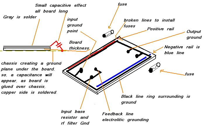

I really do not know the better way...as i have repeated thousand times the same
Type of connection, and never had hum problems.
I suppose the way i made the things, the distance to metal chassis that represents small caps that have been helping me all those years.
Lets wait "Doktor Michael", and i suppose he will prefer the star ground with everything going into same grounding point.
My way to to is a "belt ground".... around the board i use do install a very thick copper with enormous ammounts of solder surrounding all the board... a ring ground, a closed coil... a short circuited loop...will make one sketch showing the idea...very simple and effective, as practice showing that hum is something that i listen when i put the board directly over some transformer.
Tell us more, if possible, in advance, alike children Michael and I could not wait, we are sharing mails asking one each other...did Sheldon told some?.... have it made his analisis?.... did he apreciate our baby? (his baby in the reality, i am capturing a small piece of this glory to myself).
You are beeing reserved to talk,so i imagine you may face problems.... but have checked all VBEs, and the invertion did not burned nothing... this question of Hum is creating enomous concern my side Shel... are you having hum?
Oh my God...so old.... and accept guys calling me Charlotte....i cannot believe that....big Charlie, the terrible guy of the University Parking place, the elevator damned guy, behing the Apple three...those girls will not believe!!!
Those amplifiers, AKSA, GEM and SYMASSYM 4 are units that i put my name and honor on them, things to trust, and everyone that find something bad can call me Charlotte...oh God!!!...protect big Charlie!!!
If something fail..i will be damned...but i am here to face... go ahead!...point with precision on the target.... shot me fast!

Hi Sheldon !
Sorry for my late response...
About the grounding, take a look to my board-design:
http://www.diyaudio.com/forums/attachment.php?s=&postid=707913&stamp=1124661679
There you see, that feedback and input share one gnd. The feedback-gnd
is connected to the inputgnd, and from there is the connection to the
groundstar.
This is quite important, as any difference between feedbackgnd and
inputgnd gets amplified about factor 32.000, this means that a difference
of 1mv would already drive the amp into saturation.
I would say, you should have 3 grounds, one for input/feedback,
one for vas/ccs/cascode (the one with the base to gnd), and the rest.
This would make 2 splits in your case...

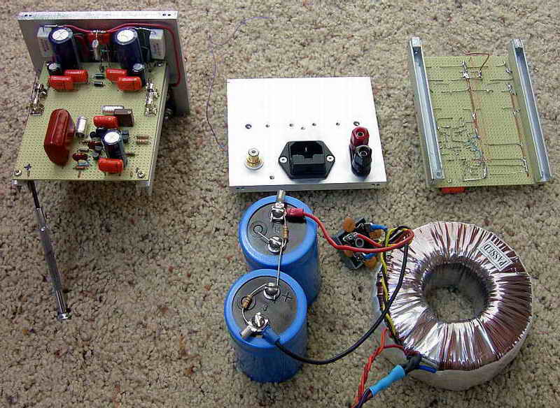

Thanks,
Mike, the inputs are at one end, the vas ccs and cascode in the middle and the ps gnd and speaker common at the other end, so they are kind of like a fuzzy star. I separated at the input end and ran a wire to the power/speaker common. Now the star is a little sharper. We'll see, but I think this should work fine now.
Carlos,
Not so many sharks here in SoCal. But better we find ways to stay out of their way than to try and wipe them all out, as we have done to so many large predators in the past. No top dog in the kennel means that the whole system falls apart. As for the music, I listened to it no problem. Thanks, some nice stuff.
I have cable, so modem speed is not the problem. Brain speed is the problem - that, and brain data storage facilities. It's full, so when I learn new stuff, something old is pushed out or further back. Unfortunately, I don't choose what to forget or bury, my brain does. Someday I will forget my name, or worse, my wife's name. The technical name for this disorder is CRS (Can't Remember, Shi - errr Stuff). this disorder is progressive, so it gets worse with time. In the first stage the emphasis is on the first word. The next stage, emphasis is on the second, and so on.
I fumbled around with adobe, and if it worked the picture should show up. The camera batteries died, so will have to wait for some better ones.
Sheldon

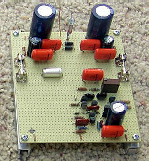

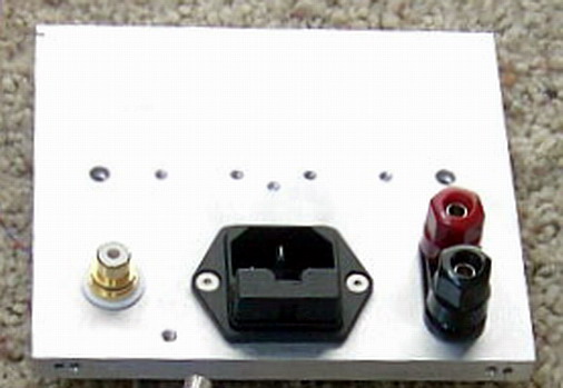

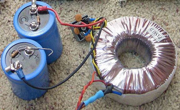

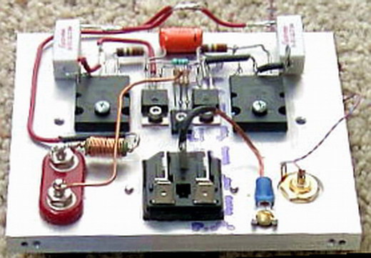

Finished the second channel today. It works fine. The DC offset is a bit higher at about 9mv, but unless there is a compelling reason to fiddle with it, I'll leave it at that. As far as the speakers go, that's no problem at all. Residual AC is about 0.3mv, so good too.
When I compare the trimpot setting to get about 12 ma across a 0.22R, it's 112R for the first channel and 103 for the second. This is for a 24V supply. I'll retrim when I get the final 36V power supplies and the rest of the case is built, as the entire case will act as a heat sink/radiator (it will be plate aluminum). When the final setup is finished, I plan the leave the trimmers in place. Is that ok, or would a fixed resistor be better?
I've built to the schematic except: The large feedback cap is 1000uf(I may use these at first for bass), and the input cap will be 10uf. Just because I had some and the decoupling caps are at the far end of the board, I also added a 10nf cap to each rail, so for the input board it's 100uf, 0.1uf, 0.01uf. Finally, the common is lifted from chassis earth with a pair of antiparallel diodes (a trick I got from Kuei over on the tube forum).
I'm very pleased so far. These look like keepers but I'll give them some good exercise once they're fnished. Carlos, I think you'll be able to keep your given name, no problem. Maybe even add a title.
