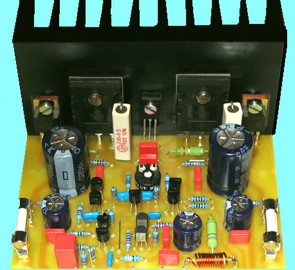

Hi Sheldon !
Looking to your pictures it seems to me that you are very good with metal works !
About the trimpot, yes, you can/should keep it, it's normal to keep it,
and as you used a high quality trimpot that is sealed that is no problem !
Your inputcap, what a monster ! What kind of cap is that ? It is so BIG !
I am anxious about your evaluation with the stereoversion !
Mike
Mike
Thanks Mike,
I've always enjoyed taking pieces of material and making something. Now I have some time to do it. If I had more room, I'd get a bunch more tools. Can't ever have too many tools.
The audio input cap you see there is a 4.7uf 250V MPP. I got it from the same electronics surplus place that I get many of the components. Or did you mean the blue power supply input caps? Got those from the same place. They are Sprague Powerlytic 24000uf-40V. Cost $3.00 each.
I expect it will be a couple of weeks before I get the last bits and have time to put it all together, but I will report back.
Thanks for the nice design Mike, and Carlos thanks for the inspiration to build it. Thank you both for the help.
Sheldon
Sheldon

Carlos, Grrr ! Hehehe, this was the revenge for the "decent camera"... 😀
Hi Sheldon,
I will try to explain a little, but this is not my best talent... 🙁
(And Carlos is right, have not too much time right now...)
SymAsym, because the inputstage is asymetrical using no complementary
transistors, but the vas is still symetrical, forming a pushpull-vas, still
not needing any complementary matching. Pushpull-vas means, that
the upperdevice lowers it's current in the same ratio as the lowerdevice
increases its current and viceversa.
So, this topology is a mixture of symetrical and asymetrical amp.
The designphilosophy... Principally an amp showing low distortions
for higher frequencies, or nearly same THD for 1khz and 20khz, and
having not much high order harmonics. I also spent much attention
to such details like having no turn-on/off thump, good resistance to
powersupply variations, thermal stability.
I chose this topology as it gave me "all" i wanted !
(And, after having tried many, this seemed the best one)
Principally i prefer the fully symetrical circuits, but the matching of
complementary transistors never really suceeded. For some reason
i do not understand, pushpull-vas always showed the stronger/tighter bass...
Mike

Thanks Guys,
No book necessary or even wanted. Your brief answer is all I wanted Mike. It gives me plenty to chew on. Thanks. Enough distraction, back to business for you then. Carlos and I will relax for you.
Sheldon
Sheldon
