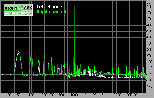

Hi !
I made some realworld-measurements...
Obviously my right channel has some defect ?
Hum is present, but is below -80db, and not audible.
But, i can't tell if these results are good or bad...
See yourself:
http://www.lf-pro.net/mbittner/rmaa/Symasym5_1.htm
The measuring is in fact only 24bits, but rmaa seems a bit buggy,
showing better results on 32bits than on 24bits...
Mike
Seems to be an aweful lot of 4, 5 & 6 + higher harmonics here -- i would say that it is undeserving of a very good rating. The right channel is also shelved up >1kHz -- i'd guess that is a noise issue.
dave
