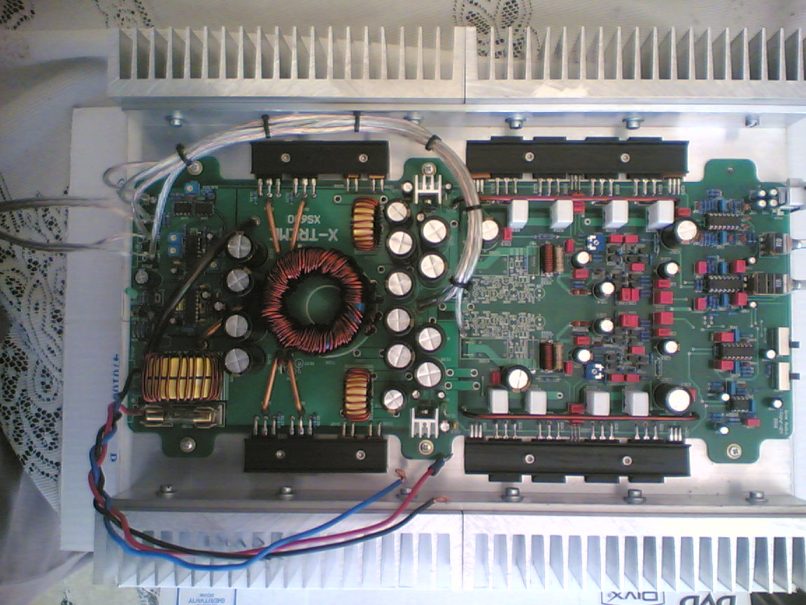

Hi All
I liked the original one that Michael built so much that I had to have a slightly more powerful version. This is my version of sysasym utlising 2 pairs of output devices per side with +/- 42V rails.
