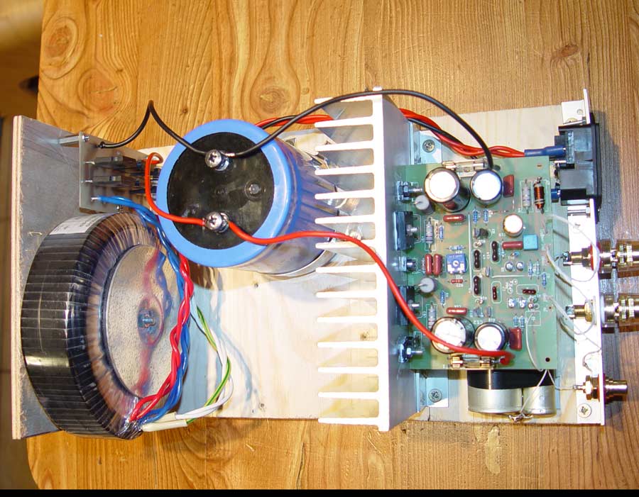

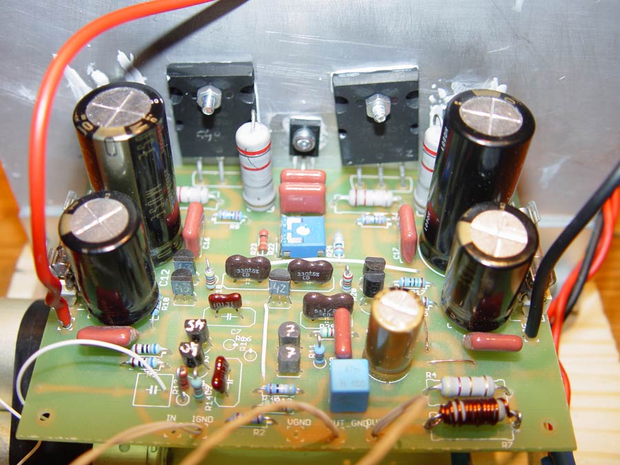

i have first monoblock assembled but the fuses are blowing. i have 2,5A fast ones.
i've checked PCB three times - everything looks OK.
tkank you for help 🙂
Piotr
EDIT
only positive rail fuse is blowing.
i'll try to bypass them with 100 R resistor
First monoblock works fine 🙂
I've checked all the board again, reassembled it with wires and it started. 😀
I have in PS 25V/300VA toriod and 22 mF Sprague (Big Can) Elyt for each channel.
Drivers - 2SC3298/2SA1306, power trans. - 2SC5200/2SA1943 Toshibas.
Rest of transistors as on Mike site. Carefully matched.
DC on output 3,5mV 😎
Second channel tomorrow (hope so 🙂 )
The only thing is the "buzz" (brum) from speakers.
How to avoid it?
Pictures soon.
Greetings
Piotr
