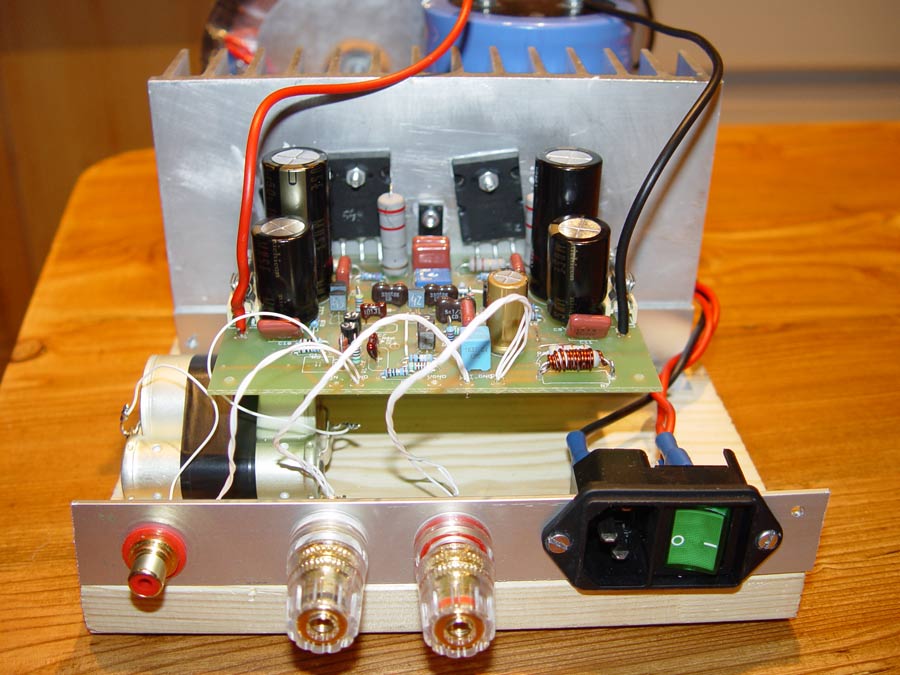

jacco vermeulen said:
Pavel means: not mounted straight.
OK.
They are mounted like that because of gaps between radiators racks. Look an the picture where bolts are.
And I do not have a threader... 🙁
I know its not perfect 😉 but thats my second ever, first "real" amp (first ever was chipamp :wave2: )
Hope its only aesthetic issue 🙂

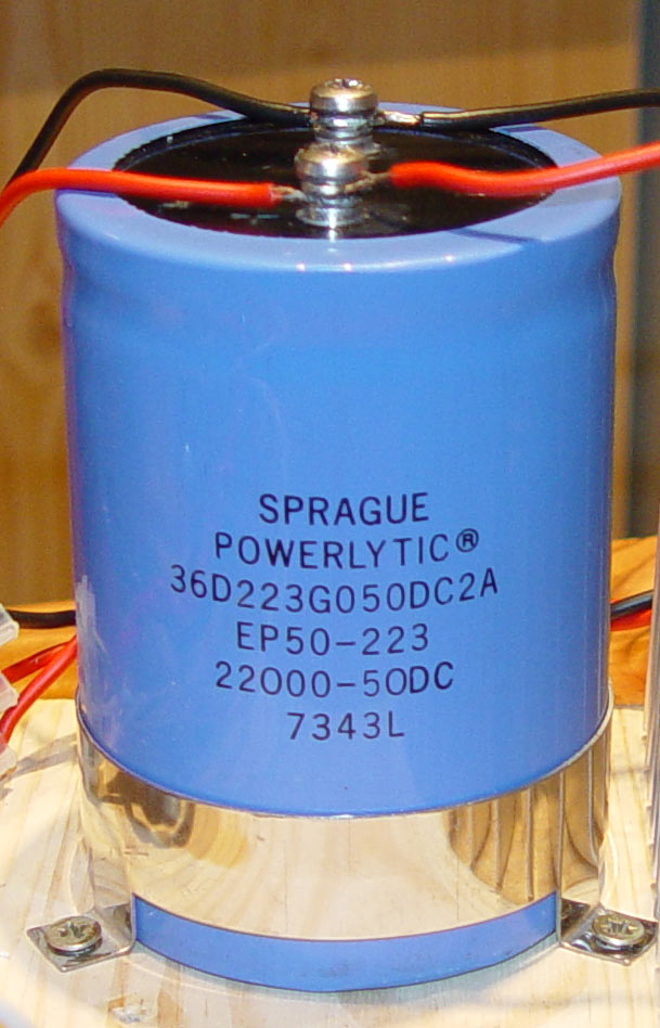

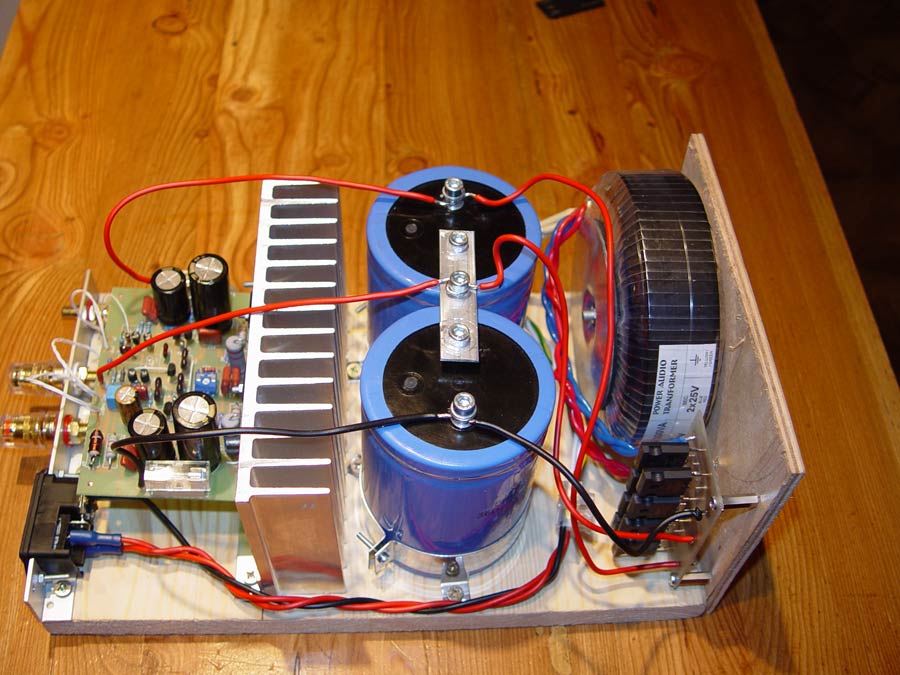

kubedes said:
:yikes: What's the votage rating of the 22mF elyt cap ? If it's not at least 80v, don't start your amp again!!!!
It's amazing that your amp does play at all without any gnd connected. Likely that it has very weak bass.
You have to rework your powersupply, you need 2 elyts in series, where the middle connection forms the ground and has to be connected to the ground output from the rectifier and the VGND connection on the amp board.
Mike
Corrected PS.
Now everything sounds fine.

MikeB said:
:yikes: What's the votage rating of the 22mF elyt cap ? If it's not at least 80v, don't start your amp again!!!!Mike
As on pic above i've corrected PS.
Elyts are 50VDC, but they survived .:angel:
Mike
That was just like you said.
Poor bass and "floating" sound
Thank you :worship:

More interestingly,
how does one get sound with a ps-cap connected between the 2 rails ?
I can understand that the circuit could operate but where does the speaker return go to, or is that the top black wire that goes to the rect. bridge ?
Anyone care to enlighten the dysfunctional ?

pinkmouse said:
What's the rest of the encolsure going to look like?
Size 16x16x35 cm (width x height x deep). Typical monoblock.
Front panel clean, few mm bigger (higher and wider) than rest of the case.
All aluminium 4 mm - naturally anodized. (I do not like black )
Power switch and diode indicating "operate" on top just behind front panel.
I have little time to design it precisely.
More interestingly,
Looks like a very close call, that blue thing seems to be a +30 years old.
jacco
look at this picture. that posibbly clear that "black wire" problem.
Photo was taken in such angle that this two diffrent balck wires look like they're "connected "
That's coincident 😉
lower wire is "ground", upper is "negative"
I haven't found any info about those big blue caps
those are in mint condition, after swiching off amp is playing at least 4 seconds.
Friend of mine relaced PS caps with those Sprague in Jeff Rowland amp (can't remember which one) and the result was great.

I know that this is likely not the final configuration, but I'd suggest one change: Orient the mains input vertically and move it all the way to the corner - away from the pcb. As it is, the mains wiring runs pretty close to your input signal paths and may induce some hum at mains frequency. You can experiment with this a little, by removing the mains switch/socket from the frame and moving it around carefully while powered up and listening for hum on the outputs. Also, put a nice tight twist on the mains wiring.
