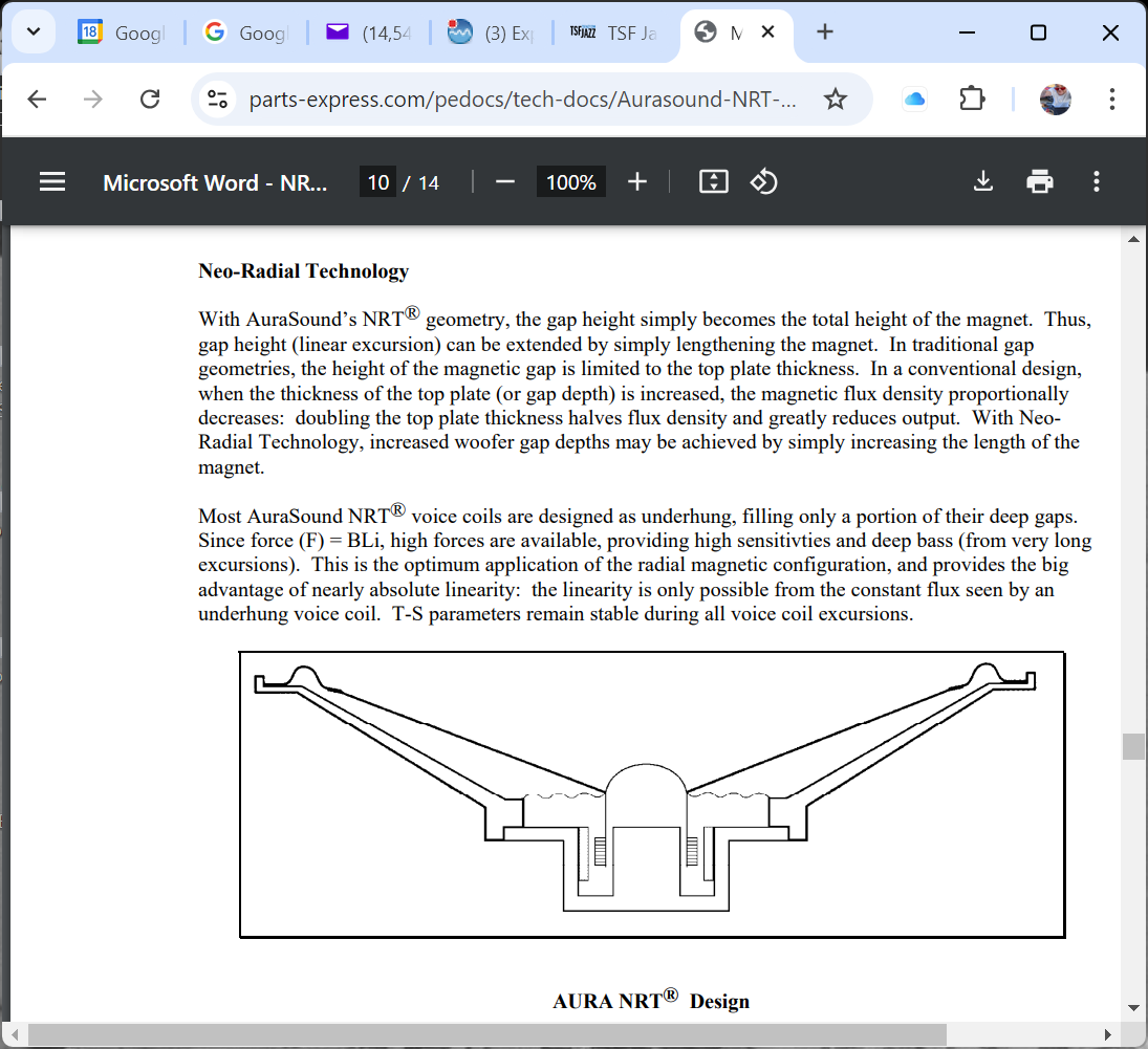

It looks like I may have misunderstood the marketing blurb I read a few years ago. They appear to have a unique design, with one side of the rare earth ring magnet directly adjacent to the outside of the voice coil, but there is a ferrous cup and pole piece that I didn't notice. Thanks for the correction. There are diagrams in this pdf
https://www.parts-express.com/pedocs/tech-docs/Aurasound-NRT-Whitepaper.pdf

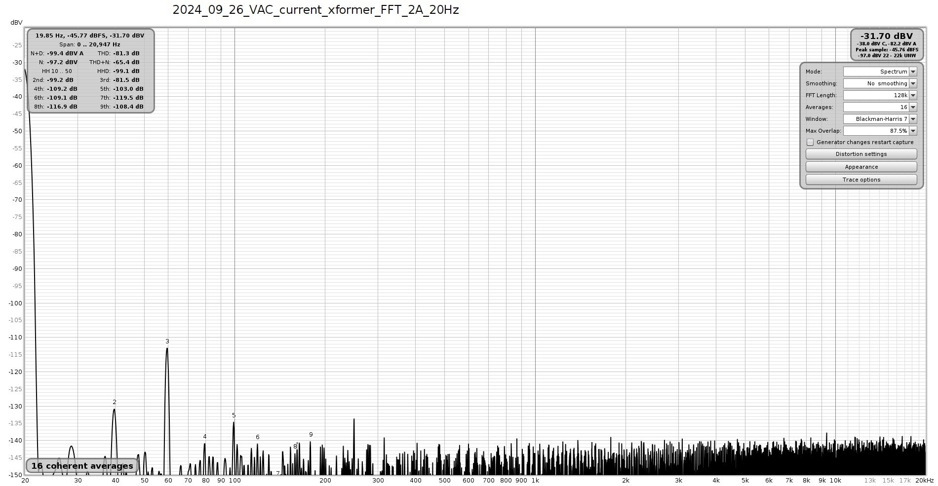

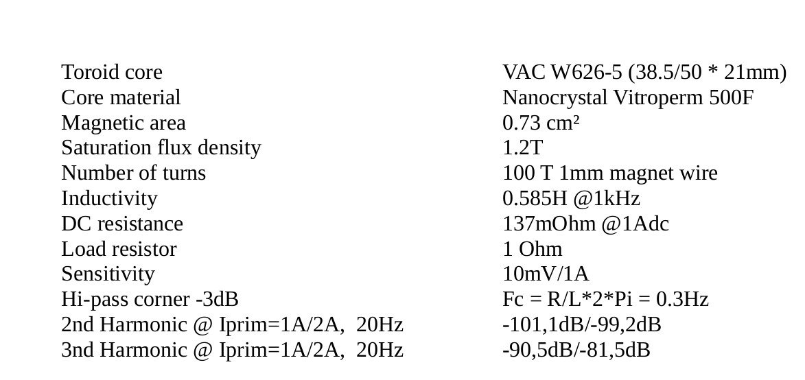

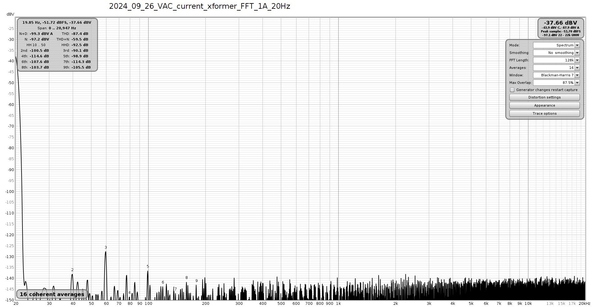

This thread inspired me to do measurements of speaker current distortion when driven with a regular voltage output amp.
So toroidal current probes came into my mind that enable easy measurements even with full bridge amplifiers.
Magnetic probes are convenient, but performance specially in the sub audio region often is poor.
With some nice nanocrystalline toroids at hand waiting for an application I built a current probe that fits these needs.

When you get down to it, that ferrite donut could have some "iron noise" issues all on its' own.
Yes I am aware of iron-related Barkhausen noise.
This effect can easily be demonstrated by approaching some iron to the magnetic pickup of an electric guitar.
That is what I want to measure at real loudspeaker drivers.
Actually I built a 40dB low-noise pre-amp resulting in 4nV/sqrt(Hz) input noise with the probe connected.
And this noise floor does not rise when I apply primary current.
So I cannot see any intrinsic Barkhausen noise originating from that toroid.
I suspect Vitroperm F500 is still one of the best magnetic materials available on this globe
