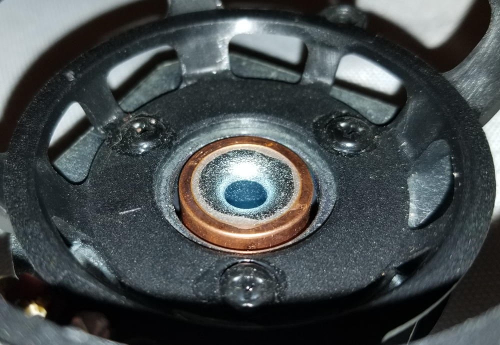

I wasn't aware the TC9 doesn't have a shorting ring.
The TG9 is advertised to have a copper cap.

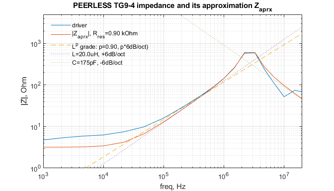

It may have some copper cap, but according to the impedance curve, it does not have much. The TG9 impedance curve:

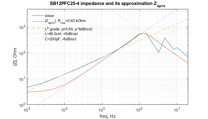

(TC9 is similar but 2x) For most drivers, this blue curve is sloped down by half (p~=0.5...0.6), like for SB12PFC, so you can "see" the shorting ring:

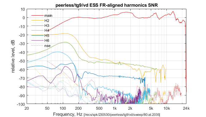

The distortions in the midrange are steadily going down, which contradicts to the usual "up":

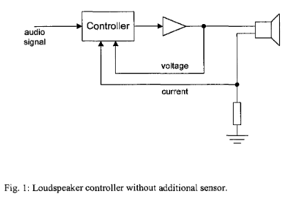

Wolfgang Klippel even overcomplicated current-drive:
From:
https://www.klippel.de/fileadmin/_m...daptive_Controller_with_Current_Sensor_02.pdf
(With this paper he acknowledges that the voltage drive does not work)
Except that is not a current-drive (with high impedance output). Box named "Controller" contains DSP processor, and the amplifier is conventional voltage-drive with low impedance output. Please read the paper carefully.
So, with that paper Klippel doesn't acknowledges that the voltage drive doesn't work.
This is interesting notion. On most graphs distortion goes up with frequency, but why is that? I tried to google but no explanations quickly.
Assuming ~flat acoustic frequency response of ideal driver was flat, either excursion or cone area needs to go down with increasing frequency, to reduce volume displacement to maintain flat response, right? So if cone area stays the same, as in ideal piston, excursion needs to go down with frequency, and the harmonics should go down as well assuming they are excursion related?
If it's good logic, then driver whose distortion goes up with frequency, the frequency response is kept flat by some other mechanism, like maintaining excursion to combat reducing cone area or something? So, distortion goes up with frequency when the frequency response is maintained ~flat with excursion to combat reducing Sd / cone breaking up? Or is it simply just that when driver response drops the noise floor rises in comparison?🙂
