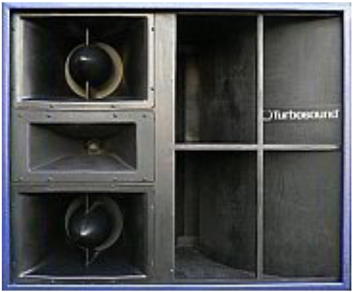

Very good measurements! Which loudspeaker is that?
Cabinet volume ~400L.
Horn loaded 15" woofers x2
Horn loaded 10" midranges x2
Horn loaded compression driver x1
Released in 1982:
Datasheet:
The approximately half-metre centre-to-centre distance between the driver axes is the same old issue that will produce comb filtering at any listening angle that is not perfectly aligned with the angle at which the crossover overlaps are tuned.
For a 1kHz XO frequency and allowing a 90° phase shift, the offset in the Z direction is 343m / 1000 / 4 = 8.575cm.
Using magic, this works out at a maximum listening angle of (approx.) 16° off-centre, for a modest 30cm distance between the drivers. All that "pro" audio c**p about 60x90° "coverage" is starting to grate.
On top of that the horn diffraction resonances are usually poorly managed, because most designers seem to have tunnel vision, over-focusing on the "official" horn segment going from throat/phase plug to the mouth, while ignoring the de-facto continuation of the horn as it envelops the speaker enclosure.

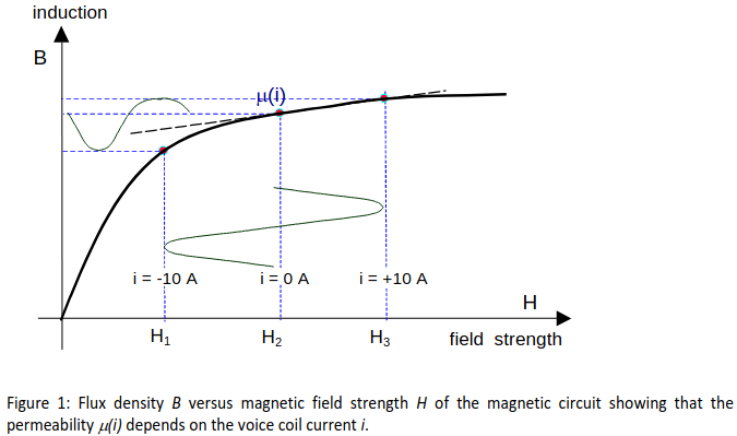

This picture implies the second harmonic to be the result of Le(i)... how does it agree with experimental data of the 2nd harmonic barely affected by current vs voltage drive, and the 3rd harmonic being invariant to excitation level?There is no doubt that demodulation rings -- that's their official name -- do work exactly as the name suggests, reduce the modulation of both the inductance vs. position; Le(x), and the force factor vs. current; BL(i). That's why even extreme underhung motor still profits from a demodulation means even though Le(x)=const but Le(i) is not. Another way to get there is saturated gap so it can't be modulated anymore.
https://www.klippel.de/fileadmin/klippel/Files/Know_How/Application_Notes/AN_11_Flux_Modulation.pdf
Klippel is a good guy, but he is centered on sub-woofers. IMHO, the area of applicability of his approach ends at `~200Hz. Here the focus is on the midrange where the distortions commonly rise with frequency - which contradicts to and is outside of the scope of his theories.
