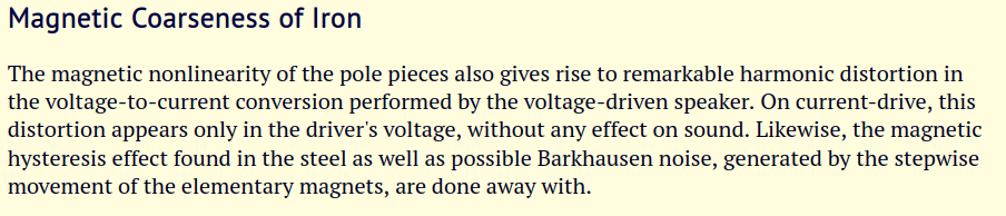

I have just found the place on the internet where I first read about Barkhausen noise in connection with loudspeakers:
https://www.current-drive.info/6
all credits to:
Mr. Meriläinen 🙂

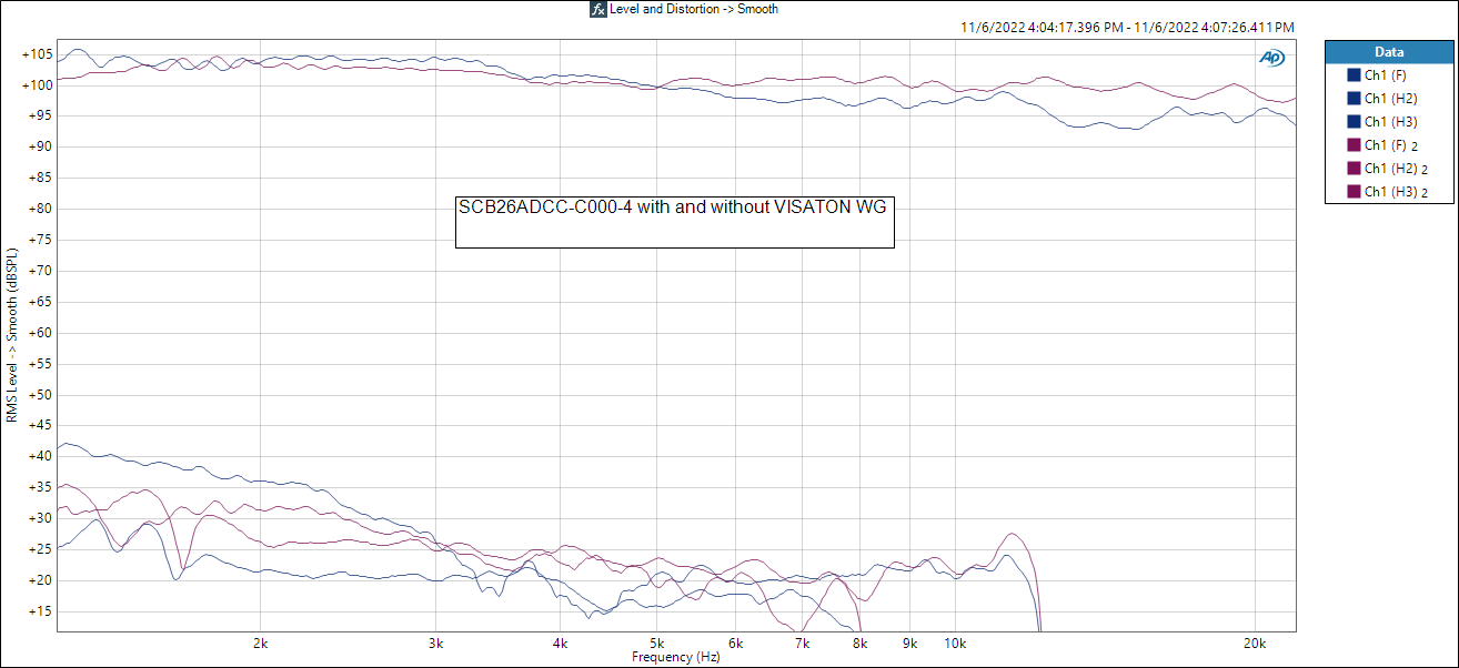

If you want to spend time testing compression drivers I could enumerate couple expetiments that would be interesting 😀Yes, I should have measured both the voltage and current drive with the same HPF and without a capacitor. I figured it out only after I had done measurements but I was too lazy to redo the whole thing because it already became clear that the compression drivers' current drive does not work

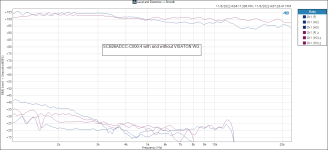

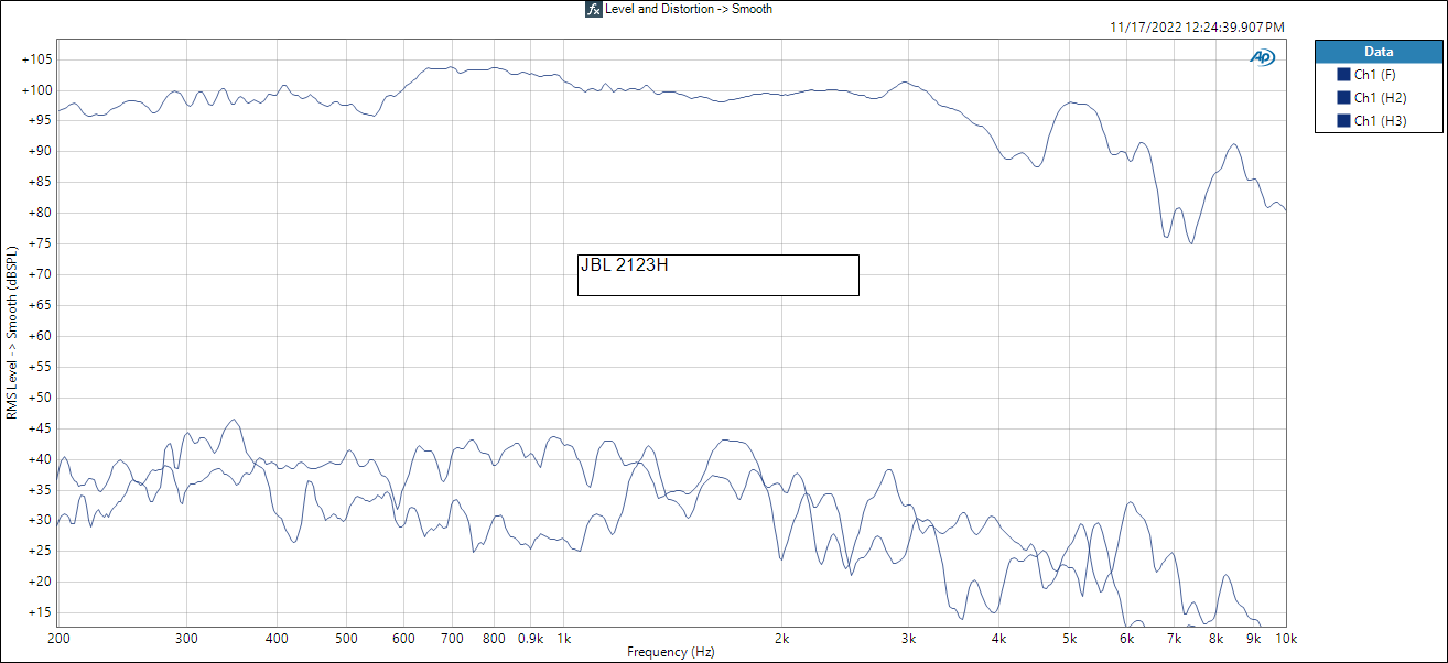

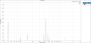

Dynamic drivers are complex loads. Some say that as soon as you add any passive parts; resistors, capacitors or inductors between the amplifier and driver you have crossed over into the realm of current drive. If that is true, yes I am guilty.
Take a look at a couple of things that Purifi has to say about the addition of passive parts.
https://purifi-audio.com/blog/app-notes-2/low-distortion-filter-for-ptt6-5x04-naa-11
https://purifi-audio.com/blog/app-notes-2/side-effects-of-passive-crossover-filters-17
For grins see the attached tweeter measurement.
Thanks DT
No worries. And without such mentions every now and then, the book would hardly sell anything any more.It was very rude of me to drag your name into my Barkhausen mission. I'm sorry about that. Thank you for your patient response. 🙂
Very good measurements! Which loudspeaker is that?Back To The Future (1985):

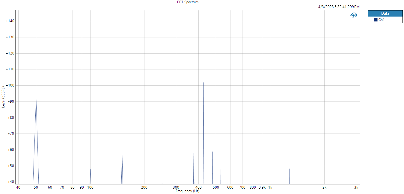

More distortion measurements, see the Scanspeak P17WJ-00-08 Two-Tone FFT plot below 50Hz and 425Hz.
The side bands either side of 425Hz are the result of Intermodulation Distortion presented to the ears as Amplitude Modulation. Much more auditable and irritating than the commonly measured and reported Harmonic Distortion.
Thanks DT
Thanks DT
