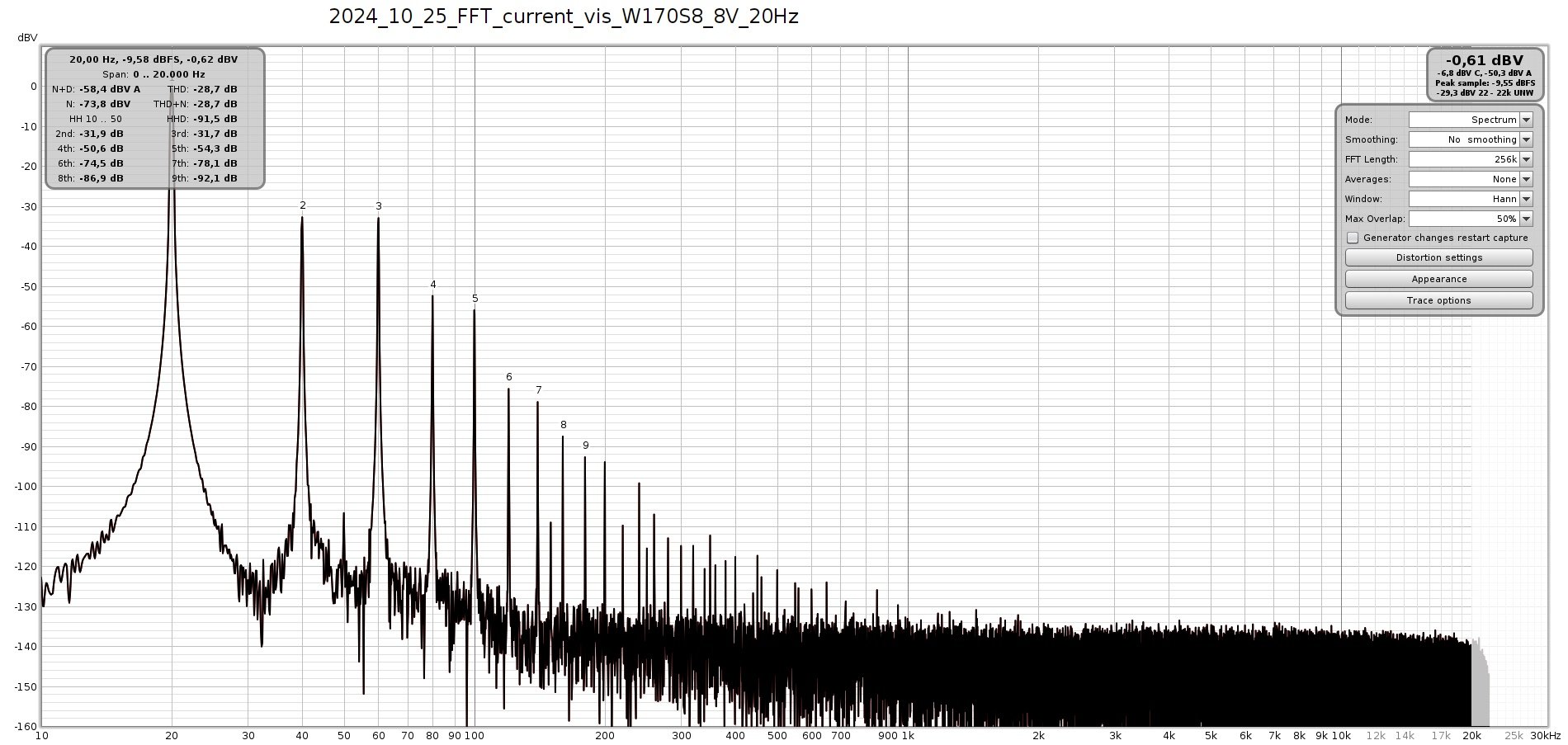

Meanwhile I started measuring current distortion with a voltage driven speaker driver.
In that case Visaton W170S8 in about 10l enclosure.
The plot shows FFT with 1V/20Hz applied to the voice coil.
We see considerable harmonic distortion -
what I do not see at all is any indication of Barkhausen noise.
I assume that the harmonics are due to motor imperfections and spider non-linearity as well.

3/5/7/9 look like classic hysteresis at 1V. The rise in the noise floor at 8V could be it. You could try it with a load resistor instead, to make subtle differences more obvious, for instance widening of the bases of the peaks.

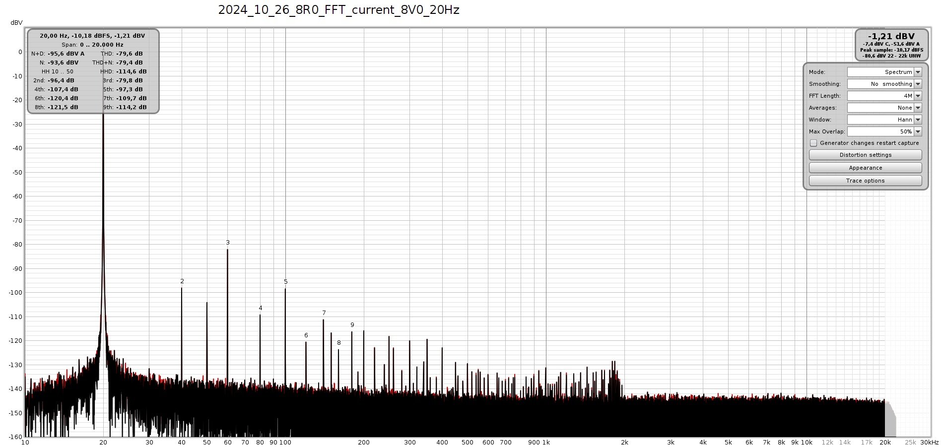

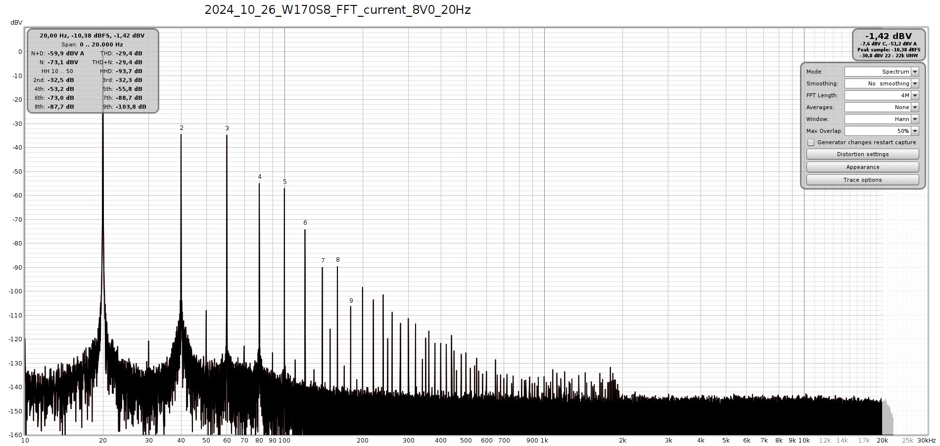

So What does "iron noise / distortion" look like?
In general, noise cannot be properly assessed on a dBV scale, and the apparent 'floor' also depends on the sample size. Noise also cannot be defined at any single frequency but always needs a given bandwith and is better described on a V²/Hz or V/sqrt(Hz) scale. This makes quantifying tones and noise on the same plot difficult.
Agreed. For that reason I did measurements with max FFT len (4M) with speaker driver and a dummy resistor for comparison.
There is a slight difference in noise floor - telling me the effect of Barkhausen noise is neglible in my setup.
More measurements not availabe, because my soundcard has got a hardware problem.

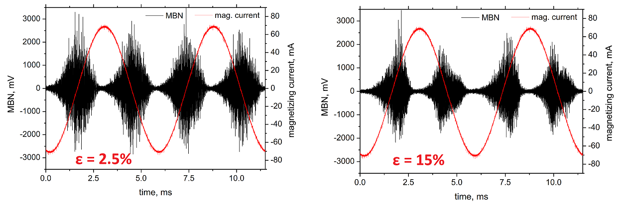

If you scroll through the whole page there are many charts that explain very well visually what is happening:
https://e-magnetica.pl/doku.php/barkhausen_noise
Because the noise is in bursts, frequencies that are not a multiple of the burst frequency tend to cancel out compared to non-modulated noise, hence strong base widening at 2KHz and favoring 4KHz. During a long steady-state measurement, the peaks will mainly average out and will show up at a low level on the measurement when in fact they could be highly audible compared to how they appear on the FFT. Sine wave measurements are pretty much the worst case for seeing this because we normally increase the FFT points specifically to average out noise. This is one of the main reasons for FSAF measurement as I understand.

So on a time domain scale we can see bursts of noise that occur at twice the test frequency. There is a random noise quality and a frequency quality to the "iron noise / distortion".
I suspect that if there is a Two-Tone test signal applied that there is a IMD Amplitude Modulation version of Barkhausen noise / distortion that makes an appearance.
