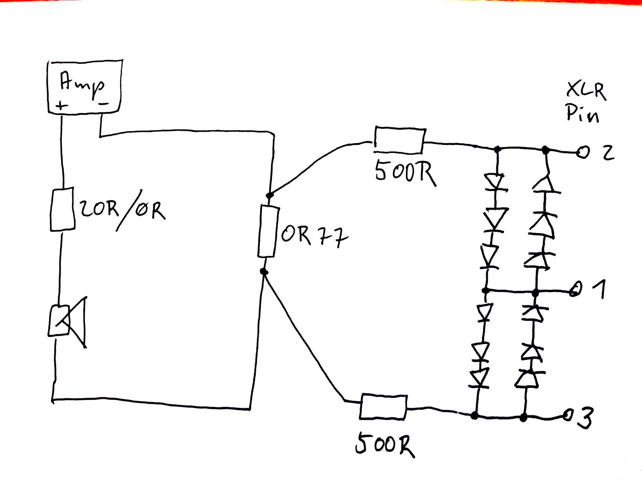

This thread inspired me to do measurements of speaker current distortion when driven with a regular voltage output amp.
So toroidal current probes came into my mind that enable easy measurements even with full bridge amplifiers.
Magnetic probes are convenient, but performance specially in the sub audio region often is poor.
With some nice nanocrystalline toroids at hand waiting for an application I built a current probe that fits these needs.

What / how does your current sensor work? What does it measure?
Does a conductor connected to the voice coil pass through the donut hole of your donut sensor?
Does the donut sensor sit on the benchtop next to the driver magnet?
I am still thinking that a in-line 0.1R current sensing resistor is easier.
Thanks DT

Thank you for your question about the measurement setup and a sketch. Here you are. I hope the sketch covers your interest.
Feel free to ask.
Feel free to ask.
The return path of voice coil current flows through that donut.We know what a Amprobe does.
Thanks DT
There is no physical connection to the driver magnet.
It does the same what the shunt resistance does.
The advantage is electrical isolation from the speaker circuit.
