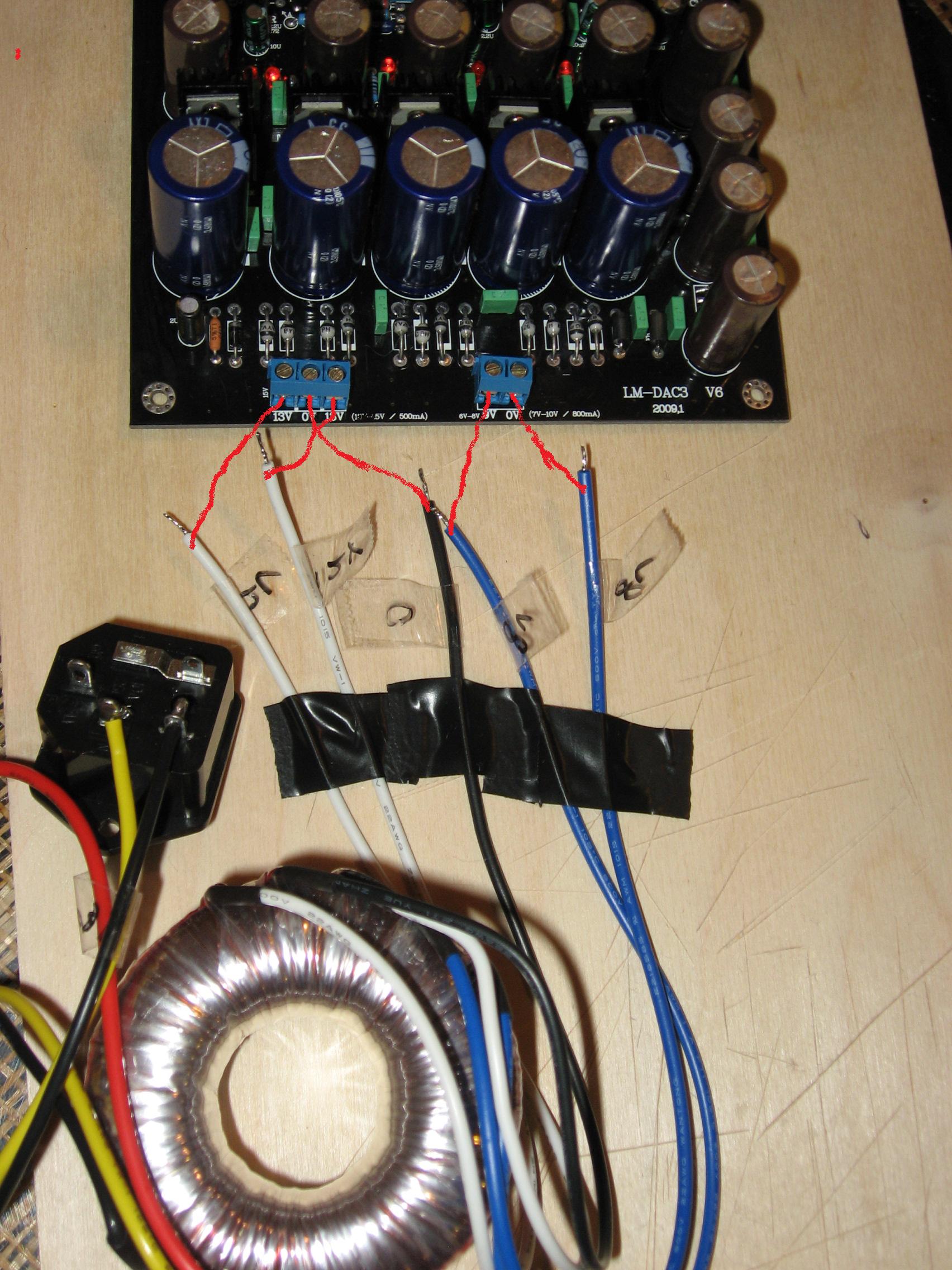

I just received the DAC. It came w/ a transformer. I'm not new to DIY, but I am new to connecting transformers and power supplies. Can someone take a look at the pic and let me know if this is how the mains wires are to be connected:
(2) 8v wires - blue ----> '9v' and '0V'
(2) 12v wires - white ---> '13V', '13V'
(1) 0 wire -- black ----> '0V' between 13Vs
(1) 110V wire -yellow ---> IEC 'N'
(1) black wire ---> IEC ? (doesnt seem connected to Line or Ground)
(1) 220V wire - red ---> (guessing this goes unused since I'm in US?)
also the black wire

This looks like the same power supply that came with my DAC. That package also included a cd with a pdf of the power transformer connections. I made my connections as you indicated in your drawing and everything is working fine.

So no additional wires have to be soldered to the IEC, correct? I can't tell what the black 0V wire to the IEC is connected to...
thanks I just found the cd; it was sloppily wrapped in white paper and no case and I probably would have tossed it if you hadn't mentioned it.
To clarify my question above. My main concern is that the IEC inlet pictured above has four prongs for attaching mains. The Yellow (110V) is attached to Neutral and the black wire I can't tell, but it's not the middle Ground lug or Line/Hot. I have not seen an IEC like this and the wiring color code is different, so before I plug anything in any thoughts would be appreciated
The 4 prong IEC inlet looks like a standard fused inlet with the yellow wire on negative and black on the positive( after the fuse). I have never worked with a transformer with 3 primaries, they usually have 2 or 4, I think that the original poster should contact the vender. If you can get a proper answer then I'd test the secondary voltages before hooking it up to the DAC.
Also being a safety freak, I wouldn't have exposed live mains sat there in the open, I'd put the IEC inlet and tranny in some sort of temporary enclosure and run the low voltage wires out from that.

Thanks for the reply. I figured it out. I took a second look and found the compartment w/ the fuse after seeing a similar inlet at Apexjr. The other primary is for 220V countries, so it won't be used. I was not about to plug it in just like in the photo, I just wanted to provide a visual aid for my questions. I'll probably build a wood enclosure.
