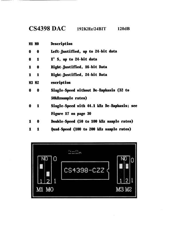

It's not clear in this thread: do you have to manually use switches every time you go from a 44.1 to higher or does it automatically detect? I have 24-bit music as well as regular 44.1k and I dont want to have to flick a switch every time I listen to something different...
You only need to change the switches if you use a higher sampling rate. If you are using a 24-bit 44.1 file no need to change switches 🙂 (just make sure the switches are set for 0/1 on the left-hand side of the board).
Hm, that's my question. I listen to both 44.1 and higher. Let's say I play some 24/192 classical from Linn Audio after listening to a regular cd/mp3, would I have to change the switches, or is there a setting that allows me to listen to both without switching?
You'd have to change the switch I'm afraid.
However you could add some toggle switches to the front panel of your chassis, and run leads to where the original switches used to be on the DAC board. Would at least be easier to select sampling rate then.
I plan to do this too once I've got it all working properly and hum free.
