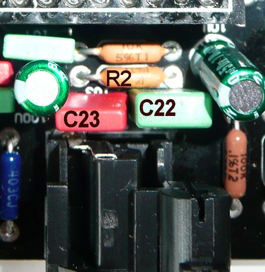

I bought this DAC two months ago.
I would like to check the values of C22, C23 and R3 and if needed change them to the updated values given by Cirrus.
However, I do not have a schematic (Mr. Chan says he has none😡), and I really don't know where they are located on the pcb.
Could someone point them out on the enclosed picture (I guess they should be close to the CS8416)?
I would be really grateful!
Lucas
Missed your post, I have an earlier version. Look right behind the dig. coax input jack. If you need to change them it is much easier to remove that jack first, but be very careful not to damage any traces, they are very delicate. I used a solder sucker to remove everything. Multi layer boards are a PITA.
Best, Bill

Hi Bill,
Thanks for taking the trouble to help me out!
If I am not mistaking, the little red cap left must be C23 and the green one C22 (both straight behind the coax in). The first resistor might be R2 then?
The resistor is 1k Ohm and on the green cap there's written 0,22 (that means 220nF?), so I guess my DAC still has the old values in it...
Am I right? (I enclose a labeled picture of this part of the PCB with the names on it...)

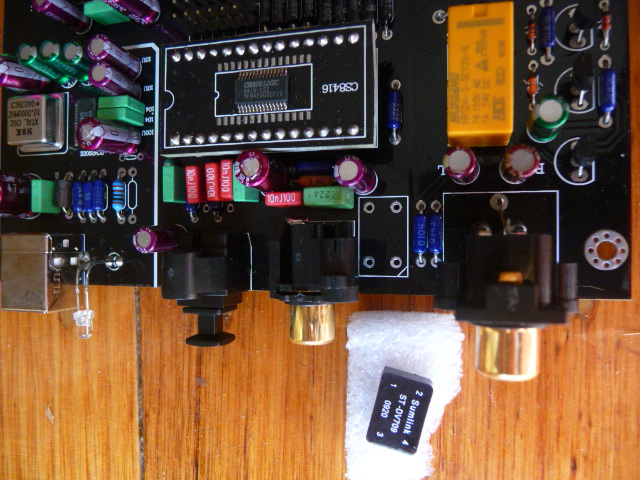

few questions
I have the new release of the DAC that does not come with the Sumlink chip, and I'm wandering where it goes on the board.
There is a space that could be it between the stereo out and digital in, from the picture.
But I'm not sure, does anyone know if its as easy as that i.e just plug the sumlink in??
thanks

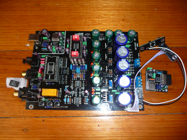

Hello all,
I'm wondering if anyone else out there is experiencing problems with this board?
I have the v8 board (red) with edcor transformers for the output stage. I'm using the standard jensen design for filtering and loading the transformers. Power is from the included chinese toroid connected to mains through a line filter. Only the digital section is powered.
I'm listening with a PPAv2 headphone amp and grado 325i headphones.
For a source I've tried both the built in usb and a usb to coax spdif board based on the PCM2704 chip. I have also tried a usb to opt spdif board based on the PCM2002 chip. I'm running foobar with asio4all output and a variety of lossless and lossy files.
I've encountered several problems with this board, I'm wondering if anyone else has had similar problems, or if anyone has any ideas for a fix.
The first problem is with ocasional hiss in the left channel that disappears once playback is restarted.
The second problem is with pops/hesitations during playback.
When I first got the board I tried it out with the opamp output. When using the opamp section the output relay would click on and off. I'm a bit concerned that I might be getting dc garbage coming out of the chip. I just can't think of a good way of testing it.
My last problem probably isn't due to the board. I've tried hooking it up to a SSMH headphone amp and I've gotten terrible results. The sound quality is awful, flat, compressed, and dull. My SSMH has a little under 150k input impedance. I'm thinking that the dac chip just can't drive the high impedance of the amp and the solution would be some sort of output buffer. Any opinions?
The last thing I have to add is that after trying the board with upsampling and without I have to say that without sounds much much better. Maybe it's my setup or my board (my upsample board came with cheap electrolytics) but the sound quality went up noticeably after removing the upsampler. The upsampler also seems to have been making things worse as there are fewer pops and less hiss with it out of the system.
I'd appreciate any advice anyone can offer.

I worked on one of those boards but I didn't trace out the input path. There is a link on the board somewhere that connects the input jack to the circuitry for the 8416. You'll have to find it and break that connection or the signal will bypass the sumlink rendering it useless. Sure would help if we had a schematic, wouldn't it.

From what you have posted I would assume that your board was defective from the start.
The higher the input impedance of your amp the easier it is to drive, not harder.
It is a multi layer PCB, the solder connections must be solid all the way through the component mounting holes, double check all your mods for bad connections. You might have to solder both sides of the board.
