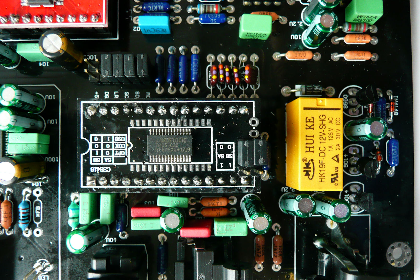

Where to find C22, C23 and R2
I bought this DAC two months ago.
I would like to check the values of C22, C23 and R3 and if needed change them to the updated values given by Cirrus.
However, I do not have a schematic (Mr. Chan says he has none😡), and I really don't know where they are located on the pcb.
Could someone point them out on the enclosed picture (I guess they should be close to the CS8416)?
I would be really grateful!

I sincerely hope someone knows where to find these 3 parts. I have read this entire thread, but I could not find a clue as to their geographical positions. The pcb does not mention the names of the parts, only the values and those are hidden under the parts...🙁
If it is too much trouble to mark them on the photo that I included, maybe someone can describe their location...😕
BTW, thank you all for all the valuable info in this thread! With this knowledge we can get much more out of this DAC!
