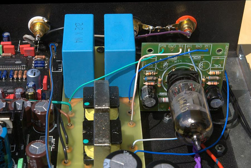

I have a Beresford 7510 and this DAC with 4397 chip. It's slightly modified in that all coupling caps have been removed, a few resistors have been added and only one opamp is being used(LM4562). It's better than the Beresford - more weight and better mids. But the Beresford has nice air and for the price offers a lot connectivity options. I'm presently working on the "transformer thing" on a second board(4398) which will hopefully eclipse both.

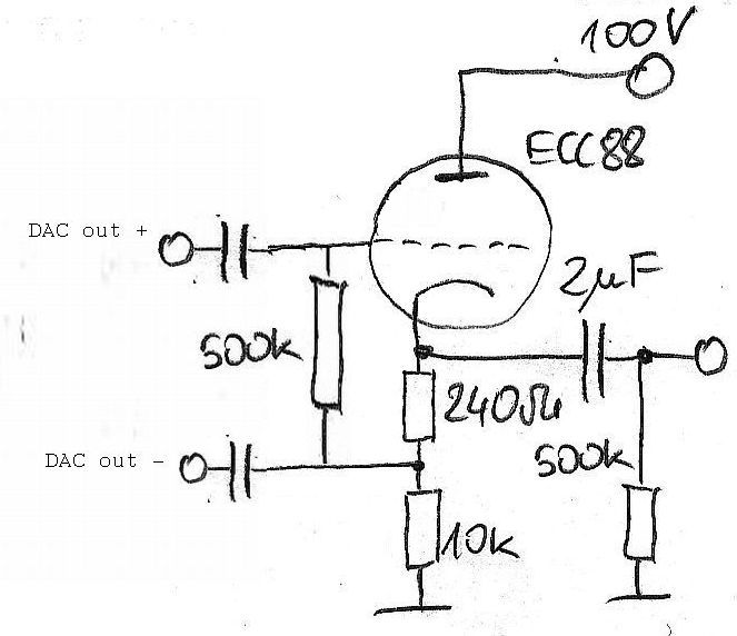

You better try tube output stage like this:
