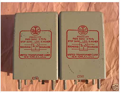

Did I Buy the Right One?
Hi guys:
I purchased a pair of UTC transformers off ebay but am now wondering if they are the correct model. The seller has labeled the transformers as A-20 and LML-2500, but it only has three pinouts (for 500, 600, and CT). Since we're shooting for 500 to 600 ohms, this should be okay, correct?
If anyone has a moment, I've attached a screen capture of the units.

Re: Did I Buy the Right One?
I saw that listing and I'm afraid those are bandpass filters, not transformers.
If I were you I would demand my money back, the seller misrepresented them, clearly against Ebay policy.
They really don't look like mine: you supposed to have 12 pins and one ground forming a circle under the transformer. Joining the different taps give you different impedances.

Re: Re: Did I Buy the Right One?
Thanks Bill. I've email the seller to see if I can intercept the shipment before it goes into the mail. Just goes to show when something seems too good to be true, it probably is.🙁
