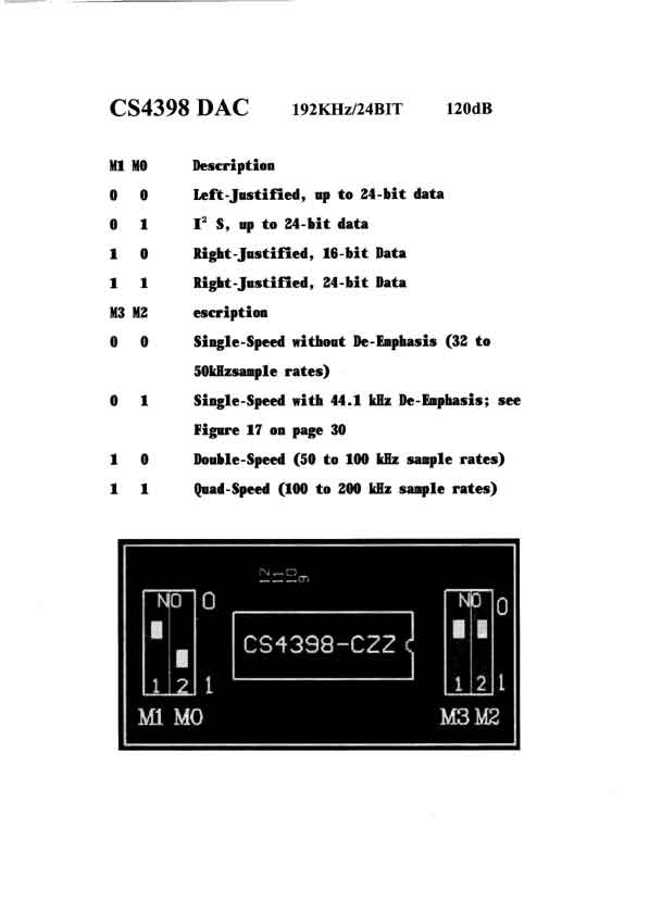

Just been looking at the datasheet (attached) for the pin settings on the CS4398 DAC.
By default mine is set to I2S setting (01) on the left hand pins. Suddenly occured to me is this the correct setting? I just took it for granted that it was set up correctly. Should I have it set to anything else?
What does left-justified, and right-justified mean, and should I have one of those selected instead? I'm using the toslink connection if that's of any help.
The settings on the right hand pins for sampling rates are all straight forward thankfully. Just wish they had an automatic de-emphasis selector, though I imagine there's only a very small percentage of CDs that were created needing this setting?

I've been following this thread also as I have several of this dac (both big and smd version).
I wonder however if the transformer approach has enough bandwidth considering that the DAC accepts 192khz/24bit signals? Isn't 20-20khz much too little, defeating the purpose of having 192khz or 96khz audio material?
On the transformer side I'm struggling between the edcor and UTC... money is the limit for students like me :S.
192/24 is the digital "raw material" that the dac chip can work with, the output is still normal 20-20Khz. Good trafos have plenty of bandwidth.
Best, Bill
Best, Bill
